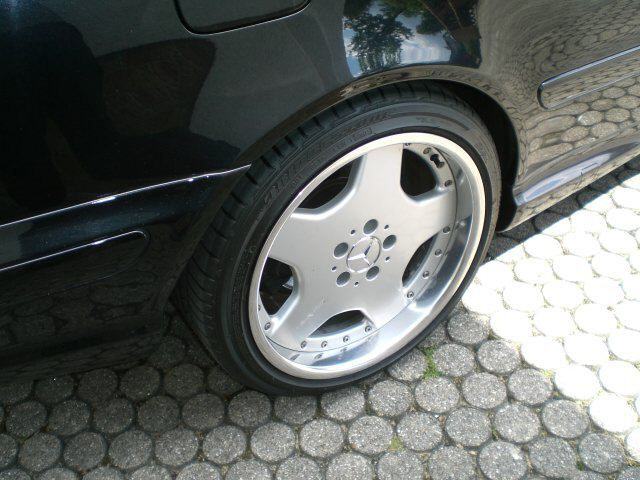

Will these fit on my 2001 CLK55 AMG? Without looking wrong of course. I'm new to the MB world.
Sounds like they fit on a W210. Not sure of the exact differences between the cars, except for the obvious, 2 extra doors.
18x8.5 et35
18x10 et35

Yes they will fit.
Those specs are same as the AMG Two-Piece SL design wheels. And those will fit the W208

Originally Posted by mxjunkie80
So a 10" won't stick out past the rear fender well ya think? Front also? Again, I'm new to MB's. I will say that you are the most helpful person I've seen on here so far. Thanks for that!
It's all down to the offset. So a 10" wheel with those offsets will not stick out.
Here is an example of a W208 on 10" wheels.
That's a good thing then. I can always spacer them out, but wouldn't be able to live with them always poking out.

Originally Posted by quik55
hey Ahmed, what are your offsets?
im lowered on h&r smaller spring pads. Want to put set of CL/S class 18” 8.5/9.5 et fr 44 r 36 on mine.
I’m going to do 12mm front and 15mm rear spacer bringing them to 32/31
i would assume that rear et is similar to yours?
what tires are you running?
All search is discussion between 225 or 235 front. What would you suggest for my proposed setup to eliminate possibility for rubbing?
thanks!
Hey there
Firstly, this is not my car. This is a member's car with SL 2 Piece AMG wheels.
OP asked if these wheel specs fit and I responded.
Check OP's post at the beginning.
