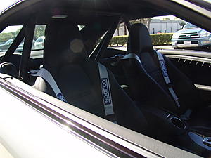

Nov 30, 2009 | 12:06 PM
You mean like this? Call Evosport, they offer one, I have it in my car, they can wrap in in leather or alcantara and it looks like a factory installed option.
Reply 0
Nov 30, 2009 | 02:05 PM
Quote: You mean like this? Call Evosport, they offer one, I have it in my car, they can wrap in in leather or alcantara and it looks like a factory installed option.
Thanks for posting the picture JR. That looks great in your car; but to be honest I don't really need a half cage, just the horizontal harness bar. Hopefully this would save me a fair chunk of change and the need to drill holes all over the car. I did check Evosports web site but did not see a harness bar.

Dec 10, 2009 | 12:31 PM
Quote: Thanks for posting the picture JR. That looks great in your car; but to be honest I don't really need a half cage, just the horizontal harness bar. Hopefully this would save me a fair chunk of change and the need to drill holes all over the car. I did check Evosports web site but did not see a harness bar.
Cheers,
Lsb.
I would not be too concerned with the mounting, this is the cleanest install you will find, looks factory and minimal holes drilled. Also it can be removed and put back to stock and you would never even know it was in there.
