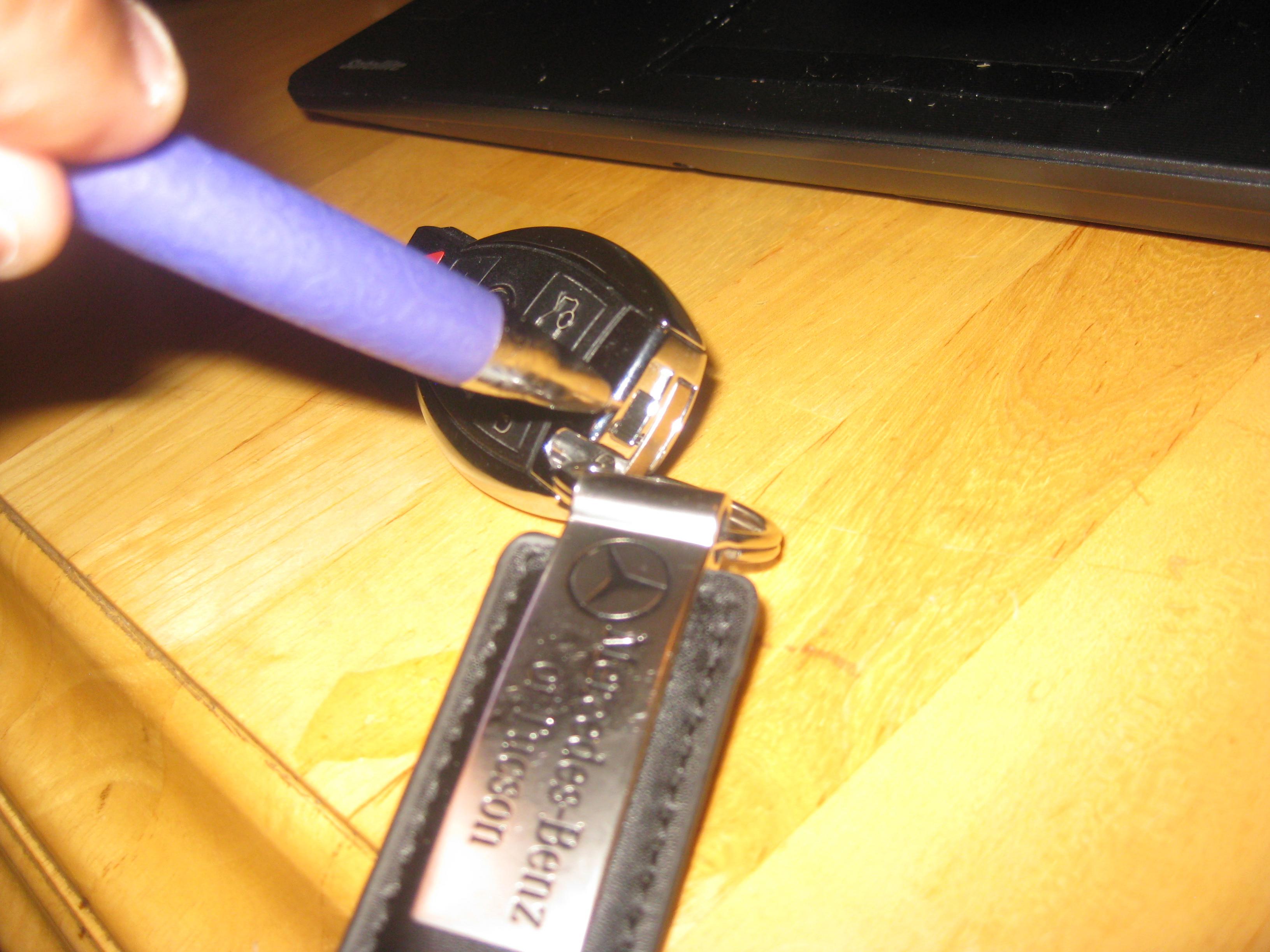

The key FOB comes with a detachable key within the key Knob. Just slide the little black piece and you can unlock a metal key inside and with that key you can unlock the trunk and or the glove compartment.
I just took these pictures for you:
Attached Thumbnails Battery dead trunk locked-img_0568.jpg   Battery dead trunk locked-img_0567.jpg   Battery dead trunk locked-img_0565.jpg

Thanks for your reply , I got the little metal key out but it does not work in the driver door or the trunk . I'm not sure why. I have checked the glove box . But I know it does not work in the driver door or the trunk.
