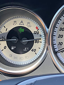

Is this car running hot or what??-photo338.jpg. I was just going to make a thread about this car running hot lol. Mines usually stays around this temp, does it look normal to you guys?

That's where mine hangs out too then I go into driving dynamics on the screen and look there and temp goes up to as high as 98 then drops to the 80s

Normal, from 80-100 is the range it cycles through depending on conditions and airflow. As it nears 100 the fan comes on higher and higher to control it, as it drops towards 80 the thermostat closes and limits cooling to maintain operating temps.
