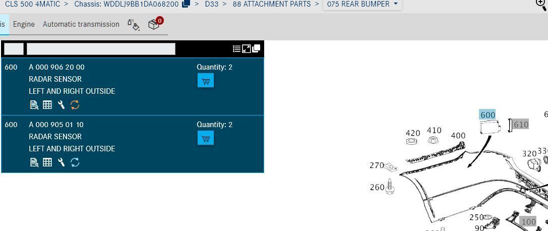

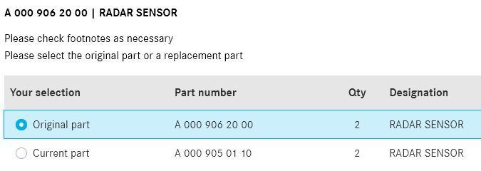

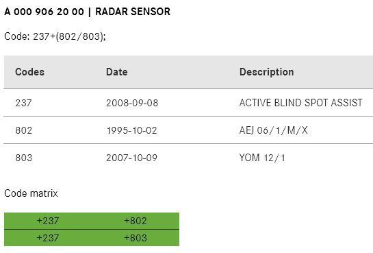

Hello ,
can someone help me please to find out if these radars would fit and work on my cls550 2013 4matic
Old Jan 14, 2021 | 08:53 AM
konigstiger's Avatar
Posts: 15,901
Likes: 4,632
From: North Scottsdale, AZ
'71 Pinto
VIN?
Old Jan 14, 2021 | 09:03 AM
emazens's Avatar
Joined: Nov 2014
Posts: 84
C230 02, gl320 09, e550 convertible 14
VIN?
WDDLJ9BB1DA068200
Old Jan 14, 2021 | 09:14 AM
Posts: 15,901
Likes: 4,632
'71 Pinto
That part is not compatible search 0009062000 (used) or current 0009050110 used/new.

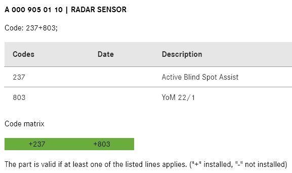

I took out both sensors and and i saw that the part numbers are #a0009050110
And another question if i find two sensors with 0009062000 will they actually work on both sides ?
Thanks again !
Old Jan 22, 2021 | 12:22 PM
Posts: 15,901
Likes: 4,632
'71 Pinto
Current part # 0009050110 same for both sides.

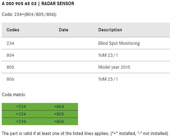

Hello all I have another question. So I have a 2013 GLK 250 and the rear radar sensor corroded. My part number is 0009050110. I have a couple used good ones that are part number 0009054503 out of a 2014 Glk. Would anyone be able to tell me if these would work? I have blind spot assist and adaptive cruise on my 2013. Any information on these would be greatly appreciated!
Old May 31, 2021 | 11:22 AM
Posts: 15,901
Likes: 4,632
'71 Pinto
VIN?
Old May 31, 2021 | 11:24 AM
Marxbenz's Avatar
Joined: Aug 2019
Posts: 49
CLA45 AMG
4503 is compatible with 2014 GLK 250 ONLY you can try it but your system will not recognize it and or it will be inoperative

Is there any way to have them programmed to work? Do you know of any alternates to the 0009050110? Where are you getting this information from? I just like to know as anything will help for future troubleshooting/maintenance. Thank you so much for the reply!
my VIN is WDCGG0EB8DG124447
Old May 31, 2021 | 01:49 PM
Posts: 15,901
Likes: 4,632
'71 Pinto
As mentioned you can only use 0009050110 = 2013 (803), 237 active blind spot assist; 4503 = 2014-2016, 234.
