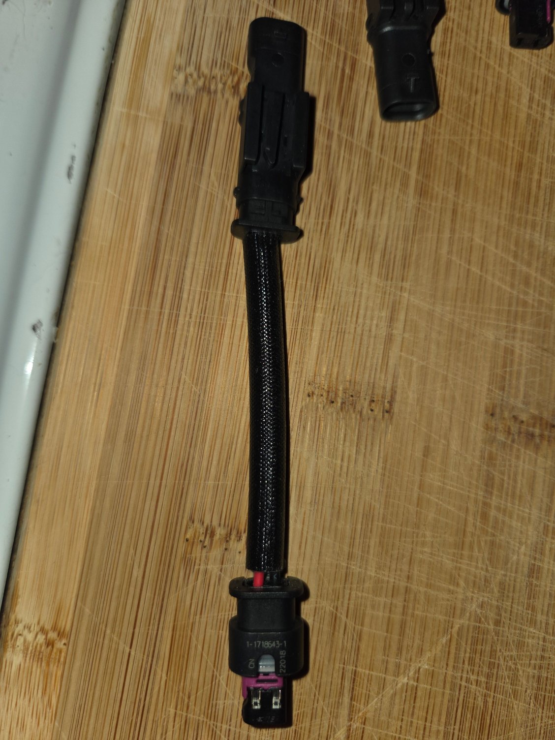

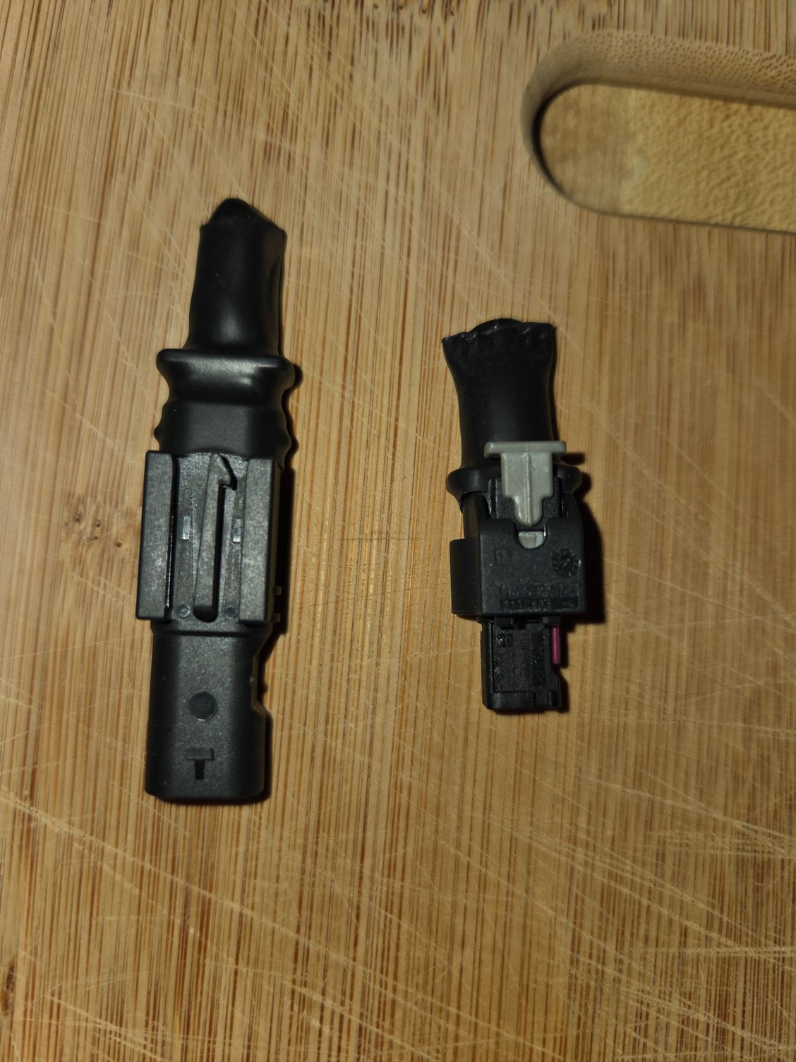

Have you done the oil pump solenoid mod? You shouldn't have to worry about oil flow to the top end that way. I've checked mine with great results on my Foxwell NT 809BT. I get the ghost codes for oil solenoid and always on split loop cooler pump grounding. I can see live data that oil pressure reads 58-60 psi 2 secs after start up.
If you have not done this I suggest it 100% I've seen the effects on head temps to from the extra oil cooling. I just unhooked mine and made dummy plugs from 2 pin cam shaft sensor extensions I got off ebay.
Plugged the shorter one in to the solenoid and other into the harness end. Just zip tied out of the way of the alternator pully and belt. Took longer to put car on the ramps and take off the belly pan bolts then to do everything else.
I do have a M157 swap from a 2016 I dont think that should matter for check valves. Its just that garbage *** 2 stage oil pump crap for fuel economy lmfao.

Great information. Going to try and find the connectors to cap and stow the oil solenoid. Will skip the check valve. Thanks.

Got the message on the check valve. Did you guys also disconnect the oil solenoid? Thanks for the help.

yup.
