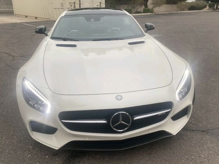

New to me 2017 AMG GTS needs engine replacement
FYI,
Intro to joining this forum;
I do all my own work and maintenance on my MB cars. My cars are a 2007 SL55 AMG with the P30 option and a 2007 S65 AMG.
For others I'm currently replacing a 2006 S65 AMG V12 engine and a 2009 SL63 AMG engine with a Weistec SC on it.

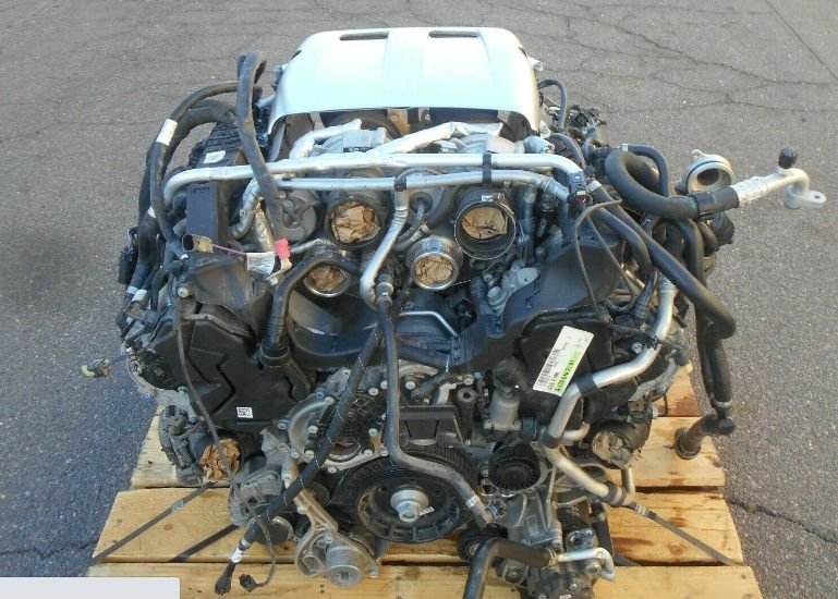

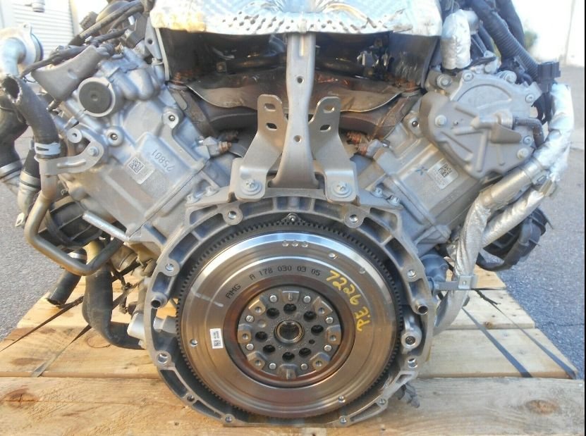

I have now aqcquired a 2017 AMG GTS with 27K miles and a perfect body (see attached pictures) however it needs an engine replacement. I do have a complete engine (13K miles-see attached pictures) that is going to be installed in the car.
I'll be sharing the progress made on the AMG GTS project ones I get further into it and have the facts why the original engine of the 2017 failed (It's assumed that the PO ran the car over an object that caused dry-sump hose to the tank get damaged).
Any information or insight from other DIY members with AMG GTS experience will be appreciated.
I do have the complete MB SDS Xentry and W.I.S setup.
Thank you

Engine comes down as a unit with the torque tube and rear transaxle. We had to borrow a second lifting table for the first one we did. But other than that, pretty straight forward engine removal.

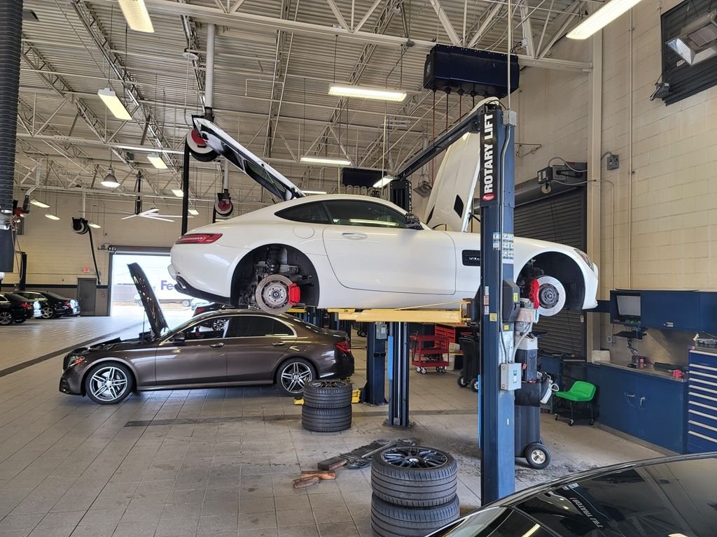

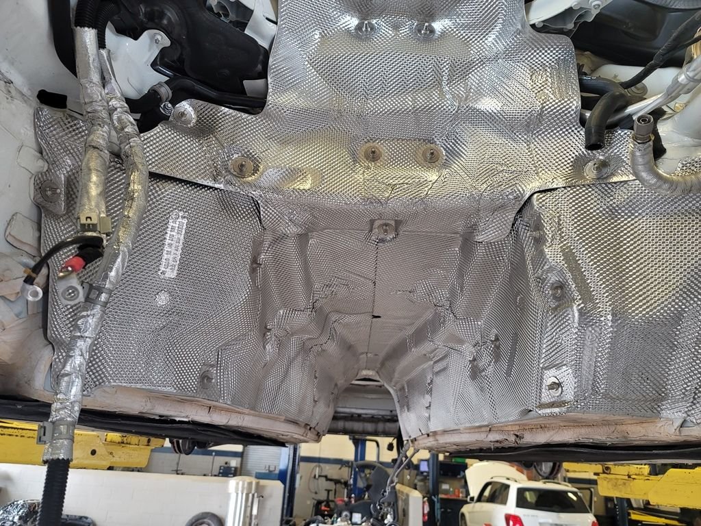

Work in progress
Originally Posted by Hendrik Koster
Thanks for that info - I have a close working relationship with my local MB dealer service manager and they are very interested in doing it for me, as I have quite work load on hand in house (V-12 & SL63 engine exchanges) and won't be able to get started on the AMG GTS exchange for the next 6-8 weeks I may go ahead and let them them take care of it.
All parts are out, ready for the replacement to go in, since it's all out I have decided to replace the carbon fiber driveshaft for the newer (HD model) that has come out.

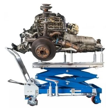

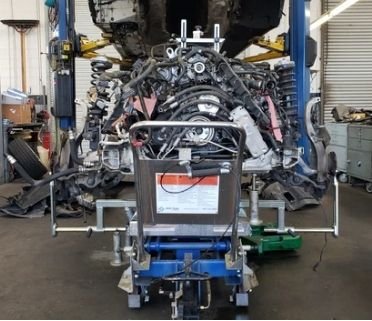

I have looked at a lot different ones...
Originally Posted by ItalianJoe1
The ones we had were dealer supplied shop equipment and quite expensive, but in essence something like this https://www.northerntool.com/shop/to...B&gclsrc=aw.ds
You have to lower it all down as a unit, so it's not really possible with one. I assume it could be done with jacks and stands and such, but man would it be an expensive mistake if it fell over while doing so. Just be super careful.
As I get into more engine rebuilds/replacements (V12 pic attached) than my GTS only I have decided to get one of the AGA tools lift tables (see pics attached)

Nice, you won't regret it, they are super convenient for powertrain removals.

You'll need a lift table, everything has to come out from under need, while things were out I upgrades the drive shaft to the latest model and after the replacement engine was in I had to correct one issue with a wire that runs from the engine oil sensor to the ECU.
All is well now, my car is running great.
What's your reason to swap out the engine and do you have a replacement already?
