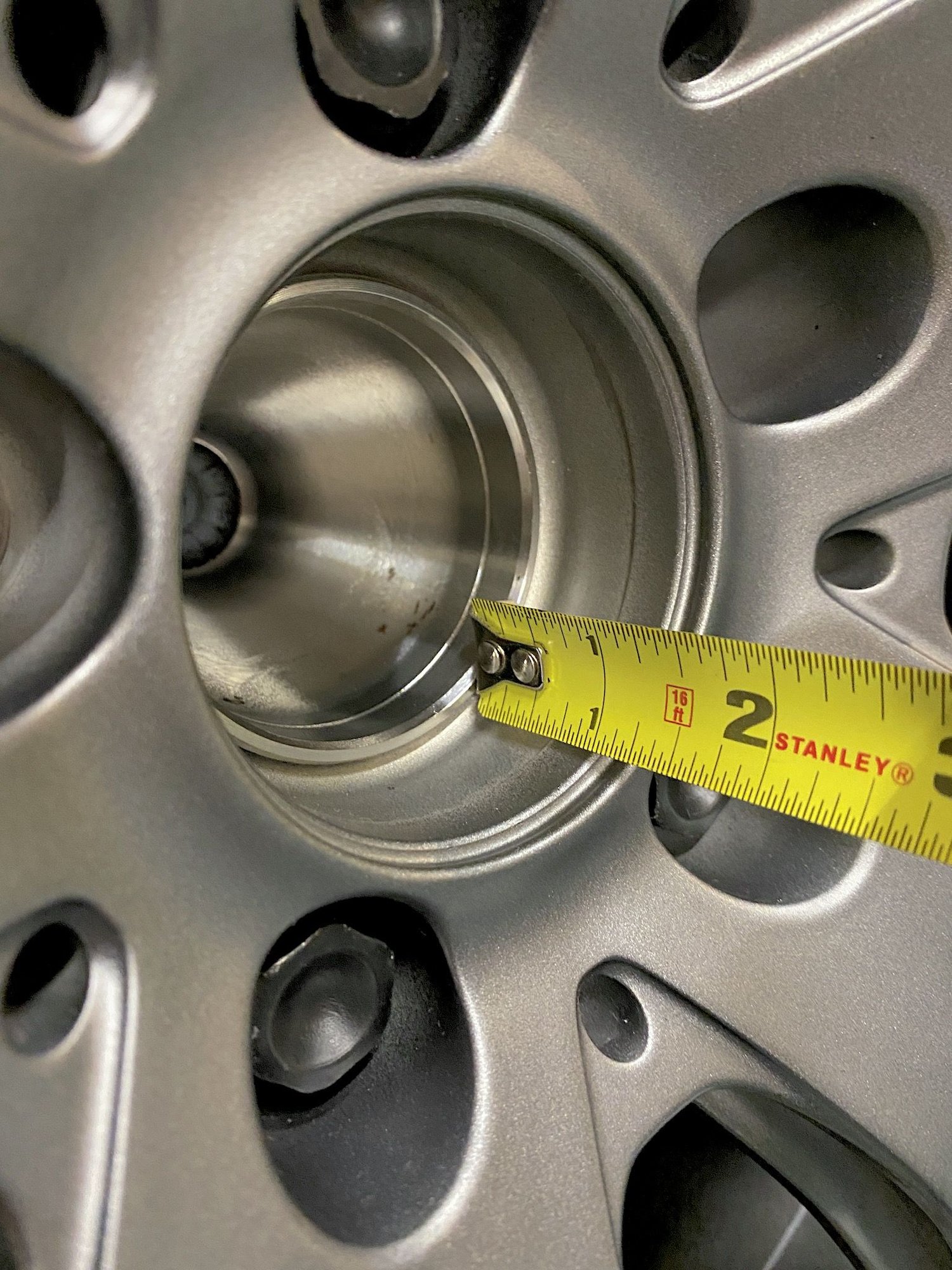

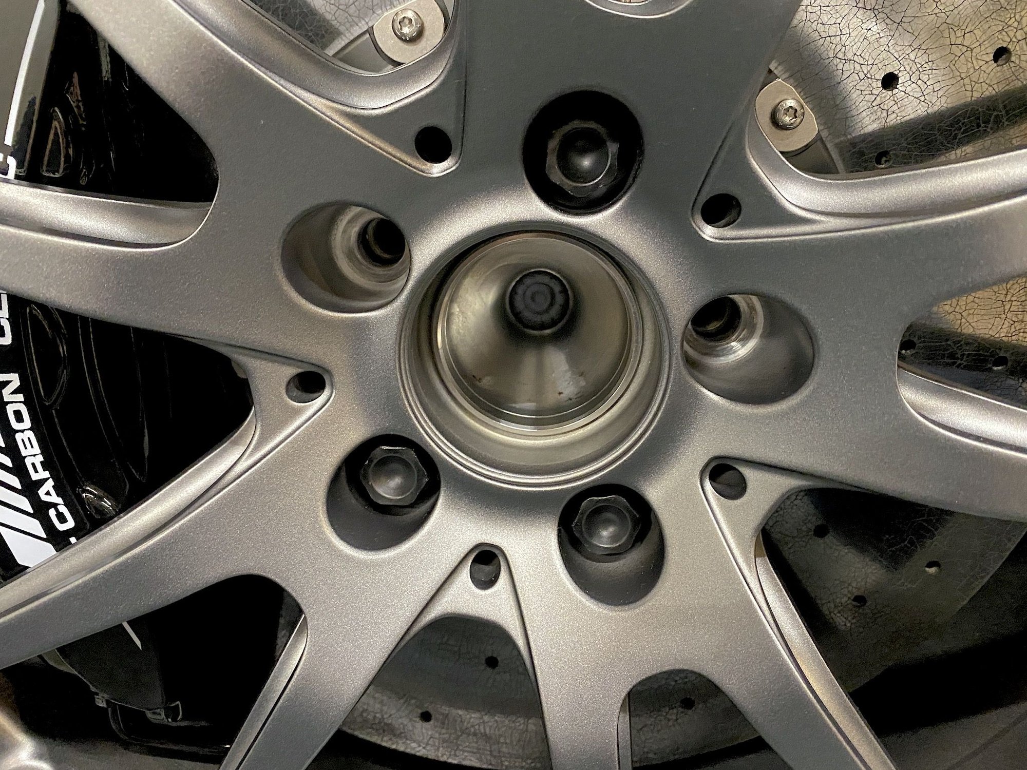

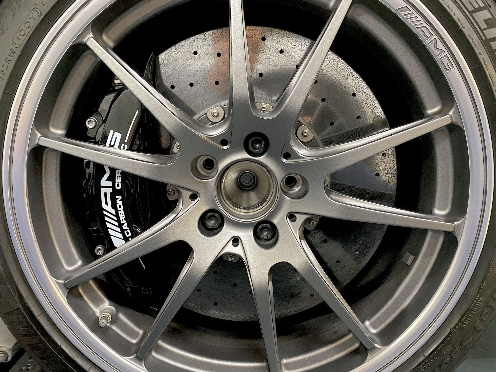

Just completed a test fitting after installing TiKT brake-cooling ducts (and before putting in the single-use caliper/rotor bolts ... that's why there are only 3 wheel-bolts installed). Looks like 1 inch of usable clearance. Hope this helps and it'd be good to have a report on the results, if you do install the locks.

Wow, nice - THANK YOU 🙏
From the wheel and caliper finish - this is likely a GT R Pro, but hopefully we can assume same clearances as the GT R.
Will definitely report back with findings.
The Rimgard locks look to be such an elegant, effective solution if they fit!
The TiKT brake ducts - excellent; will be doing those soon as well 👍

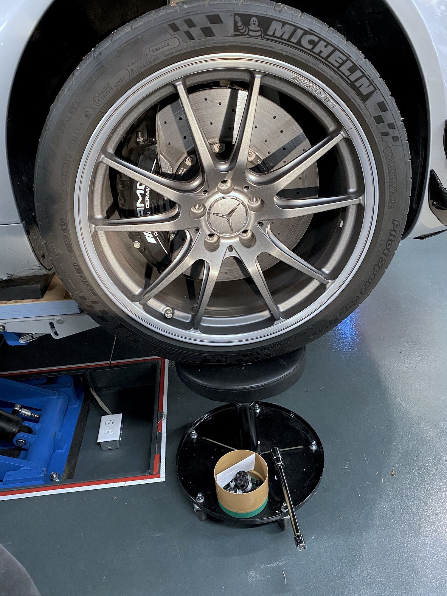

Thanks for the explanation ... and I agree WRT the CCB rotors. My approach is to screw in a pair of long "sissy bolts" when removing/installing a wheel/tire, along with a wheeled telescoping/pneumatic shop stool. I place the shop stool underneath the wheel then raise it enough to remove the bolt-riding friction then carefully pull the wheel/tire outwards on the wheeled/rolling support stool. The backs aren't too bad, but I think there's less than an inch clearance between the inside of the front rims and the CCB rotor edge so it'd be easy to chip them.
