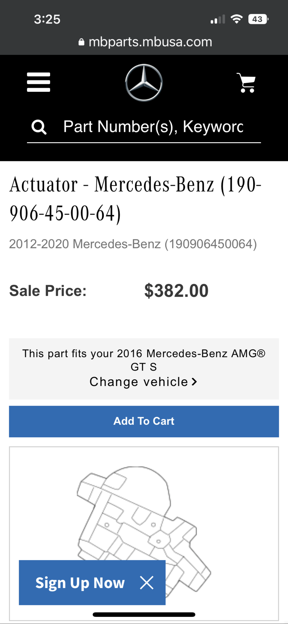

Schwinn
Old Oct 24, 2022 | 05:11 PM

Originally Posted by BBS63
thank you very much. That’s all that’s needed ?
Old Oct 24, 2022 | 10:14 PM
BBS63's Avatar
Joined: Sep 2017
Posts: 220
Likes: 89
From: Chicagoland
Schwinn
Have you had your car diagnosed? Reason I ask is sometimes they get out of alignment and need to be reset so to speak the actual motors I mean. This is what was attempted by my AMG tech at the dealer before he said its actually my muffler baffles or valve were bad but needed the whole thing replaced. Now, this same tech has been working on all my AMG vehicles for almost 3 years now so I dont think he was BS'ing me. But I still decided to remove my whole system and take a look inside the flap and the muffler.
I was able to get one motor at the time which was the one I believed was the one causing the god awful sound, and what was weird was that at idle with exhaust open it was fine even with revs. But as soon as I would get in and drive it I would hear it. So I made the dealer escalate this and persuaded the GM to "help". Which they did.
If your issue is with stuck or not responding exhaust valves, yes then all you have to do is replace the one that is bad or both.
Its best to remove the whole muffler system and install these. It can be done with muffler in place but your hands will get mangled and if you have decent sized hands its best to remove the system, its not that hard to do.
When you are installing be extra sure the clock springs are aligned correctly into the actual flap inside the muffler.
Good luck
