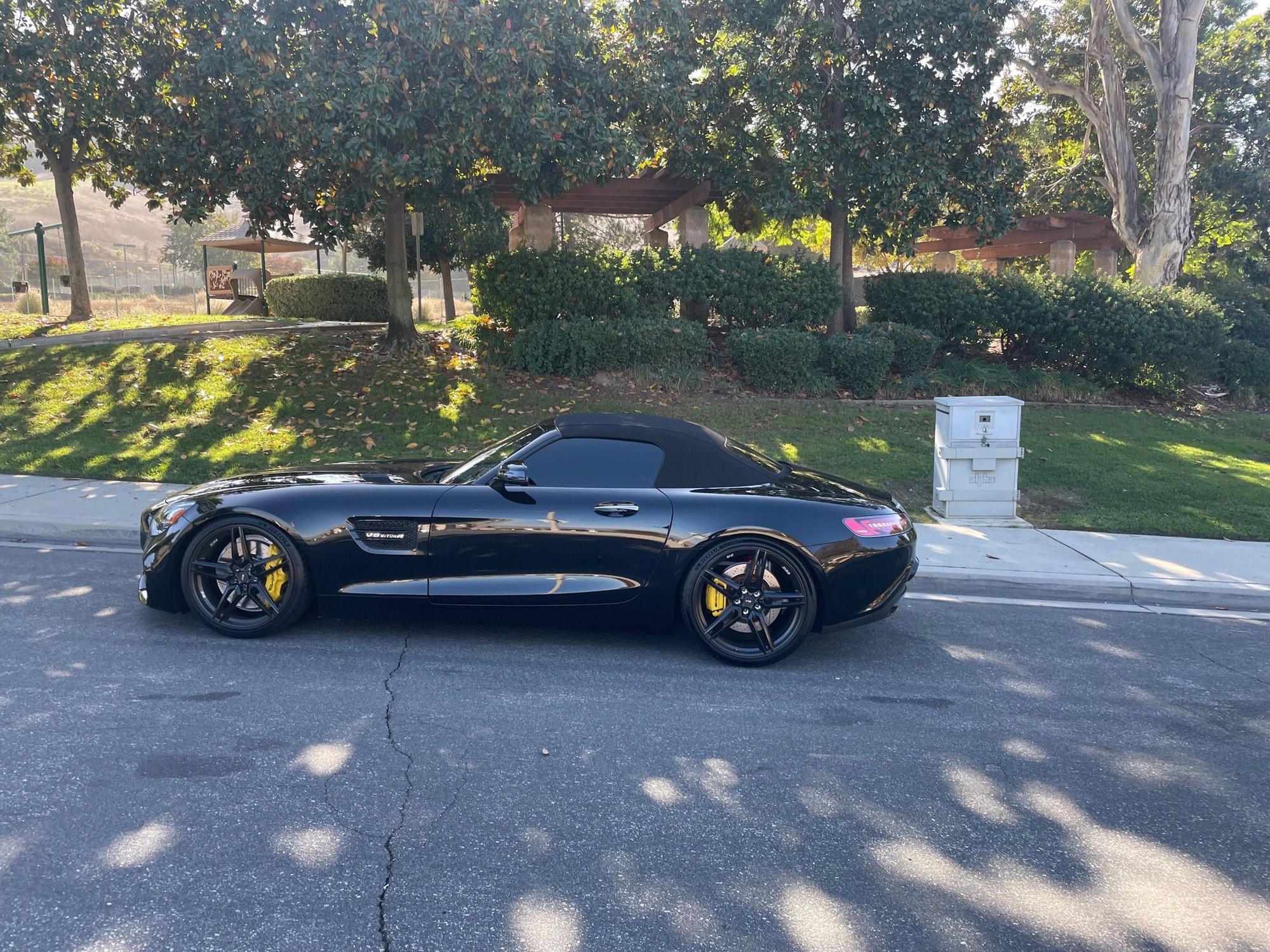

Old Nov 5, 2021 | 06:11 PM
Optimum7's Avatar
Joined: Feb 2019
Posts: 67
S63, G550, S580, AMG GT Roadster
Old Nov 5, 2021 | 07:43 PM
AMG 17GT's Avatar
Joined: Mar 2006
Posts: 4,005
Likes: 711
From: ATLANTA
R Nine T
Man. That looks Perfect 👍 !
are those HREs?
Old Nov 5, 2021 | 09:04 PM
Optimum7's Avatar
Joined: Feb 2019
Posts: 67
I have to say, after posting this picture I have to agree. Case closed lol. Thank you.
