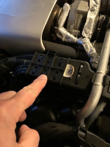

Thank you for your response. On the passenger side the 3 torx screws that hold the black piece (I think is for the crankcase ventilation) in the back are next to impossible to get access to. Did you remove the red rectangular bar with the yellow sticker to get access to them?
Also, the black wiring harness on the same side does not have a screw on top of it like yours. It has the torx screw underneath. What gives?

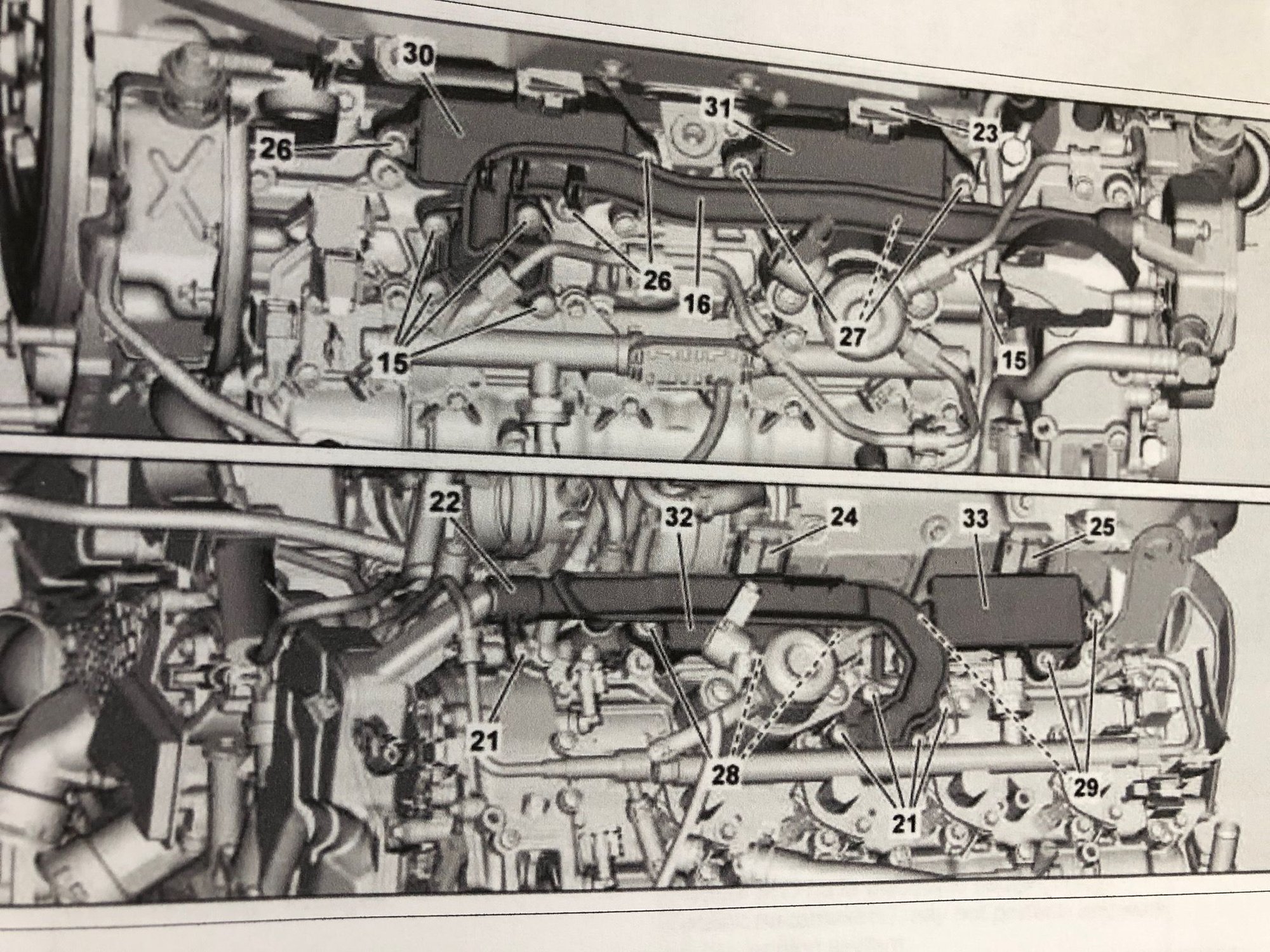

Regarding the breather tube on the passenger's side, there are 5 screws that hold it in place, not just the 3. They are marked item 15 in this pic:
There is a rubber sound proof cover on a piece of the fuel rail that partially obscures those 4 screws on the back end of that breather tube, but the sponge rubber is flexible and will yield w/o removing it if you have tools to get to the screws. If you are unable to get to them then, yes, remove the strut. It requires a little more disassembly but will give you a clearer shot at the 4 back screws.
On the black wiring harness, ignore the brass threaded fitting in the pics that you see in the other threads. It has nothing to do with the mounting hardware for the harness. There is a torx screw UNDERNEATH the harness block. It cannot be seen and you have to work tactically to find it with a flexible torx bit. It is easier to show the back of the screw to help you locate it by feel. The back of the screw is threaded into the lower heat shield of the turbos. Find the one I have circled here, then you'll know where to find the bolt head.

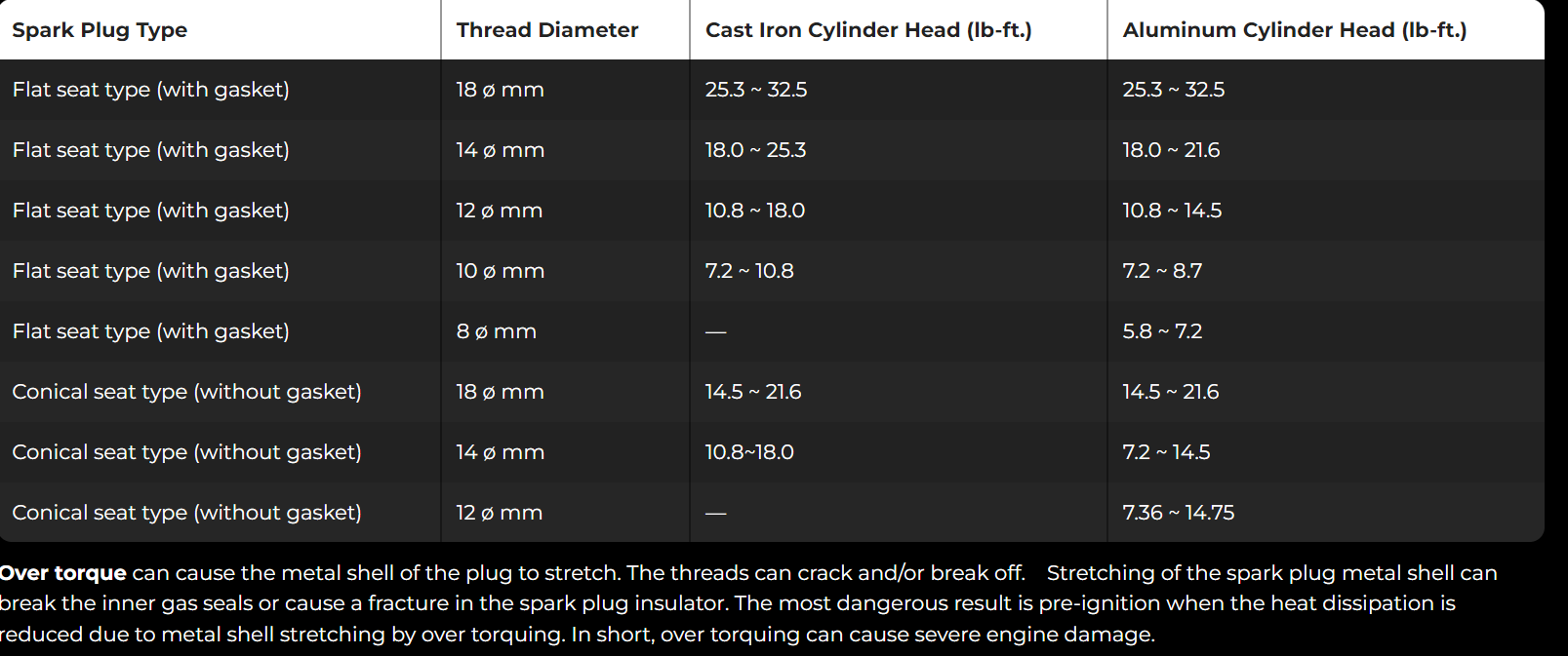

Torquing the plugs to 23 nm equals 16.9 ft/lbs or 203 inch/lbs converted by a calc. with anti-seize lubricant applied and dielectric lubricant around the ignition coil rubber boots and on the boot end tip of the plug...
Let me get this out of the way before going over to the passenger's side. Don't change the gap of an iridium plug. Use it as it comes. You can do more damage trying to change gaps. These are special use NGKs so they're mfgred for this platform. On my MB branded plugs, NGK with the NGK P/N is stamped on the metal body of the plug. I posted a pic of this plug in one of the threads above.
On torque. Here is the recommended torque for plugs with a compression washer and threaded into an aluminum head. You are at 16.9 lb-ft, the range is 10.8 to 14.5, but since you put Anti seize on the thread, this constitutes a lubricated thread. Lubricating threads add 20% to 25% to the CLAMPING FORCE of the thread, so you are realistically at 20.28 +++lb ft. This is way too tight, especially in aluminum. With anti seize you want to subtract 20%, so you should have set the torque wrench at 11.6 ft lbs. You might not own the car for the next plug change but if mileage/years are followed, the next change will likely be a tough one. So, if you haven't put these plugs in yet, PLEASE don't go with 16.9 and lubricated threads.
https://www.antiseize.com/PDFs/torqu...ifications.pdf

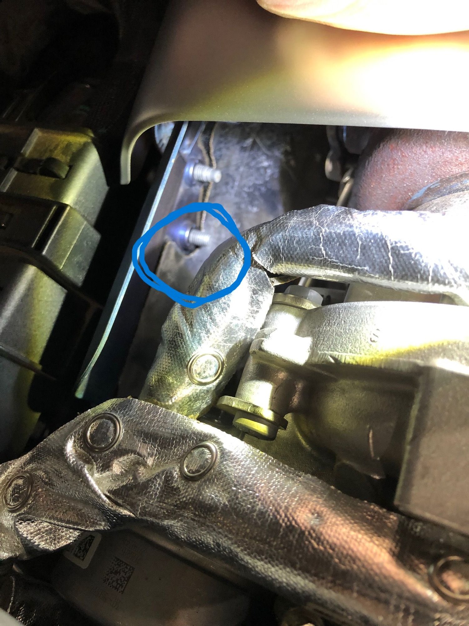

On the passenger's side YES, remove the strut if you need. It will give you more room to remove the breather covering the 3/4 ignition coils. One caution on unplugging the ECU - do not open the driver's door or the hatch. This wakes up the canbus and it will go through a diagnostic and set some U-Codes with the ECU missing in the network. I personally leave it plugged in but still don't enter the car through the driver's door. Instead, I always put the driver's/ passenger's windows down if I need to reach in for anything.
For the large harness block there is one more torx bolt to get it to move (a total of 3). This one is pretty hidden and will require some more disassembly. You need to remove the passenger's side air intake tube that goes from the right side air filter to the right side turbo. When you do, it "kinda" reveals the third screw. It can be seen if you part the left and right air charge tubes that come out of the turbos heading for the intercoolers. Here is a pic of the screw (like it'll do much good):
Here is a wrench on the bolt and it should make it a little clearer:
Once this screw is out the harness block will move for you.
Once it does, the next challenge is freeing up some of the branch harnesses. AMG did quite a job bolting down this motor! There are 3 tie wraps. Cut all 3 then you can get the 3/4 coil unplugged.
The yellow one wraps around the harness on the strut. You might have done that one already. The red one wraps around the 3/4 coil harness connector. You will not be able to get that connector released until you cut this tie wrap. The blue one is in close proximity to the red one and holds the fuel return to the harness (so there is no movement. It's important to get at least two of the 3 back in place. The first one to the harness clamp on the strut is less important, but I put it back anyway.
