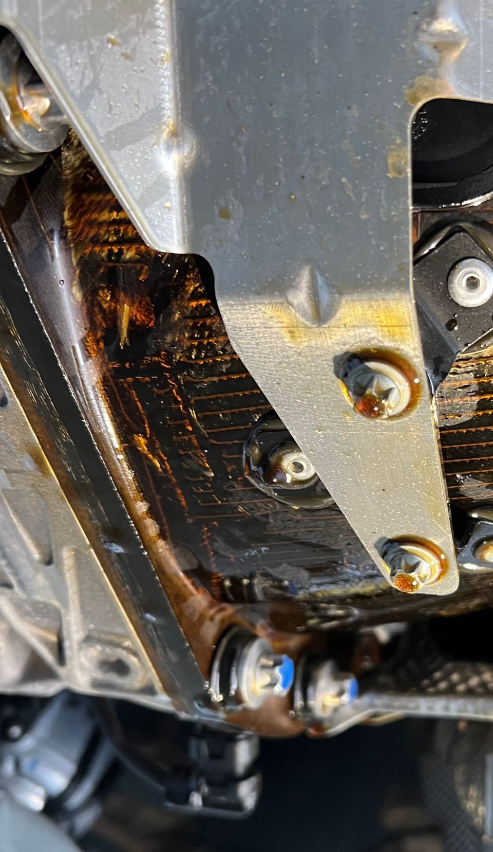

Pulls in to pits and gets extinguisher just in case. He knows some guys there and they put up on a lift and this is what they found. Ughh. They could see it was def coming from turbo somewhere. So bummed. I used all new factory gaskets and O rings. $250 worth. Mechanic hasn’t looked at it yet. just got home. He mentioned the feed lines were thin flexible lines. Said they almost seemed like one time use kind of thing. Maybe they are 🤷‍♂️

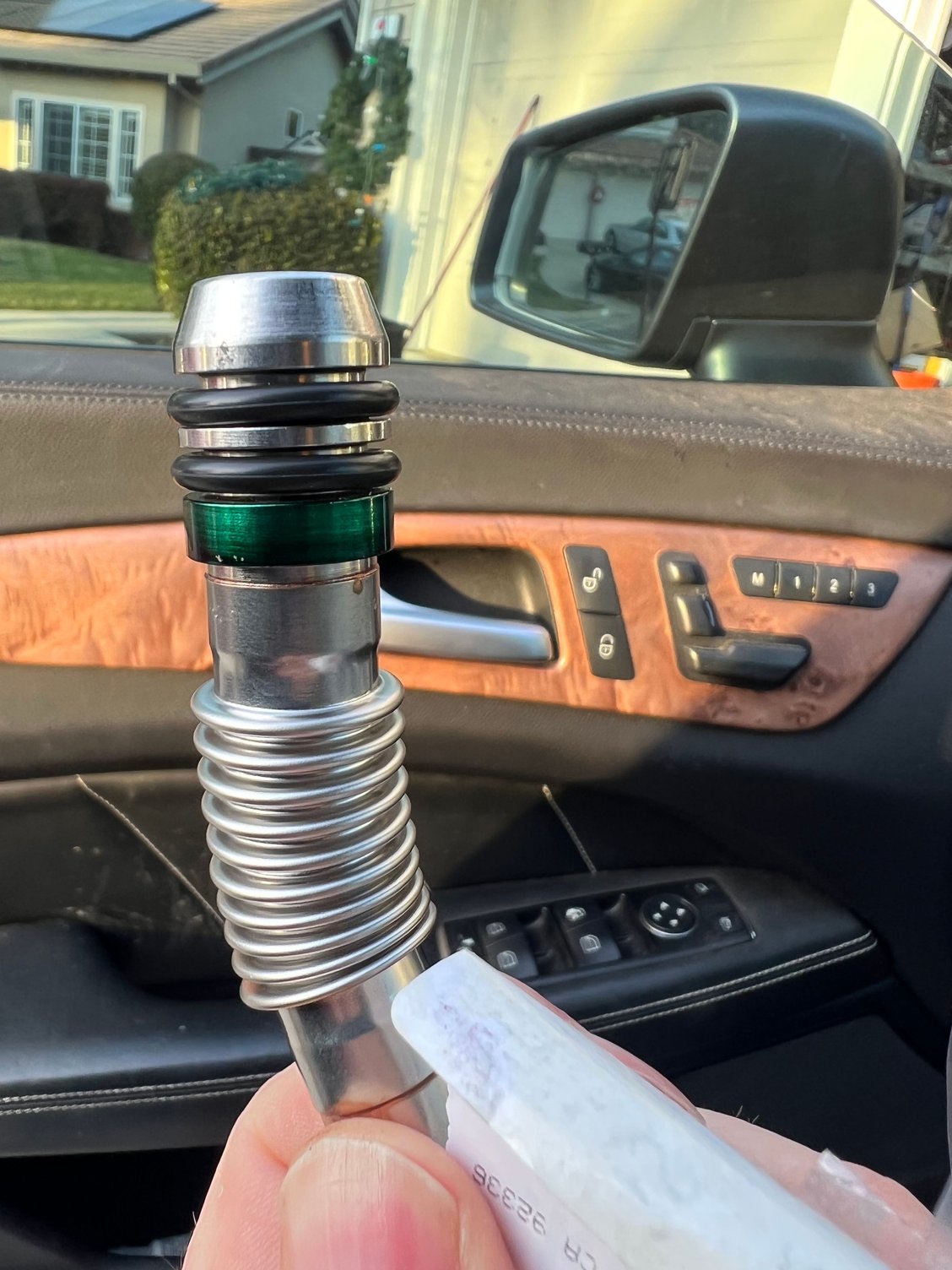

here new return lines. So apparently it’s not uncommon for factory ones to leak. they even upgraded them where the issue was. you can see the green band. that’s new
