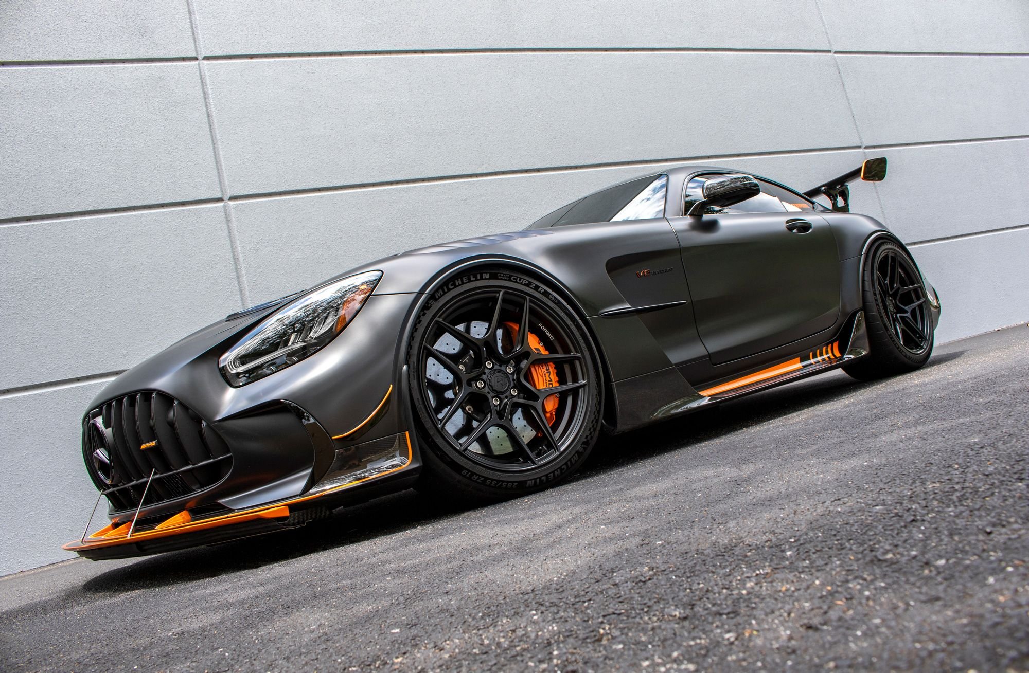

I wondered how this was done.

Hi,
Limitation Ring removed?
or anything from the aftermarket should fit.
I'm not a racing engineer, but since everything is adjustable, lowering it (1 - 1.5 inches?) shouldn't be a problem. (Except on bad race tracks) You can get the chassis geometry right again.
And i don't know the BS struts in particular, but the installation height shouldn't play a role. The hydraulic part is controlled in exactly the same way. If not so, you would just have to shorten the length.
The aerodynamics shouldn't suffer as a result; it should even generate a little more downforce thanks to the smooth underbody.
However, the suitability for everyday use certainly suffers. :-)
