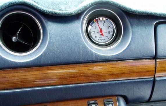

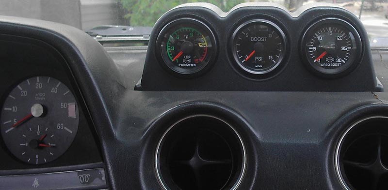

Do you have a pic?
Do you have a pic of where you located your boost gague? The car's dash is too nice to mess up (if you know what I mean)...I am just looking for ideas...
thanks,
Joe
Old Sep 25, 2007 | 03:33 AM
240D 3.0T's Avatar
Joined: Apr 2006
Posts: 1,116
From: Federal Heights, CO
1982 300D VNT, 1980 240D 3.0T, 1982 300TD
My dash has a few cracks so I didn't feel too bad mounting mine there. When I had my wagon, I placed the gauge in one of the center vent pods.
The left is pyrometer, center is boost and right is exhaust manifold pressure.
Attached Thumbnails ALDA Replacement-center-boost-gauge.jpg   ALDA Replacement-center-boost-gauge2.jpg
