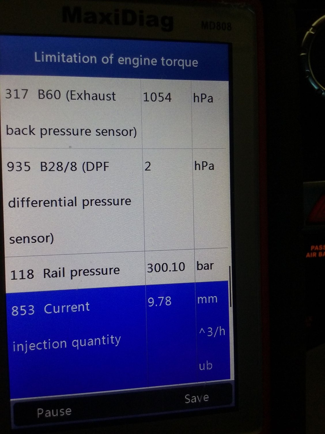

Today I took some time to do another regeneration on OM651 engine. Sorry for picture size, but I don't know if I can control it.
Autel was showing 120 hPa = 1.7 psi DPF differential pressure at flooring it from the start and I was getting CEL with the code.

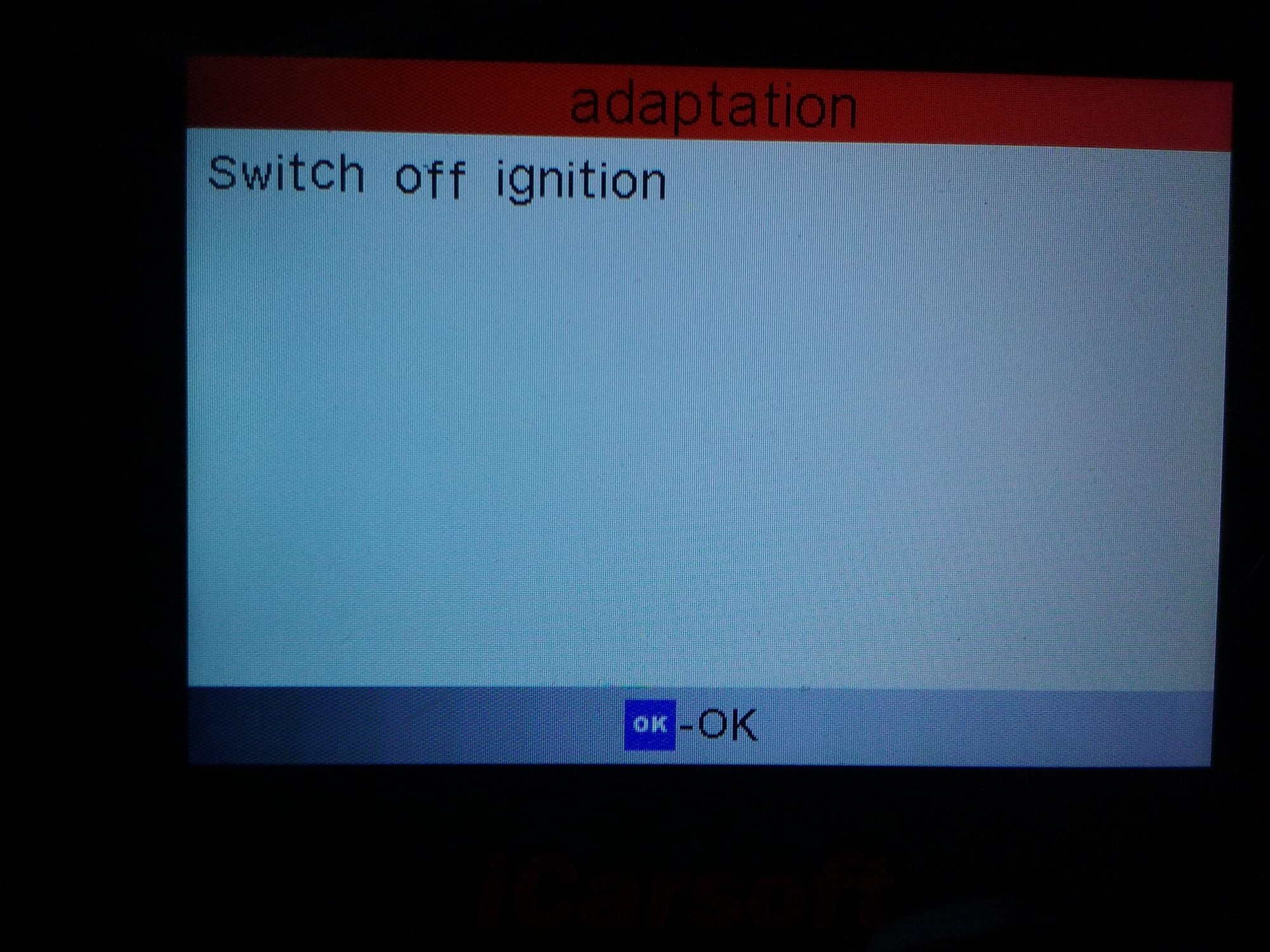

Switched to iCarsoft that has program for DPF regeneration.
The program wants you to keep rpm between 2-3,000 rpm and not exceed 50 kph.
That makes for crazy driving as you have to keep it on 2nd with wheel paddles , below 30 mph with the car every 10 seconds automatically switching to auto, so I had to observe the cluster for gear display and each time it switched to "D3" I had to hit the paddle to "M3" and then to "M2". To top it, iCarsoft is not updating the display, so every minute I had to hit "OK" on the scanner and scroll to see updated values.
Don't blame me for not taking picture in that procedure, but here is picture of before. As you can see
"soot content" at 13
Fill level of diesel particules" at 185 [0.... 350 allowable]
keep your eyes on line saying "Operating conditions of c.../Normal operation" that was before I scrolled back and press F2 for regeneration. During the regeneration the right side of the line will display the regeneration in progress.
here is the screen after. The dpf values went to 0.
As I said, the scanner doesn't refresh the values and it shows speed and rpm when I already stop for taking the picture.
Disregard the line saying "Regeneration was compl" It doesn't seem to do anything, while it was misleading at the beginning.
Press OK at the bottom the page.
next screen warns about switching the engine off before cool down period, so press OK
when you can see exhaust temperature drop below 400 - you can press OK and switch the engine off.
After regeneration I hook up Autel again and check differential pressure.
3 tries went from 78 to 101 hPa (120 in single try before).
