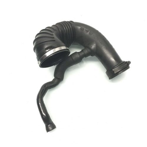

I didn't want to cloud the issue but after the first code came up (Pending: P0299 code turbo underboost. Checked all pipes, connections etc leading to turbo and no obvious sign of any issues.) I did replace the intake pipes(below), although ultimately this seemed to have no effect, therefore I didn't mention this - suppose I should have.
Replaced this
No other work has been done or replaced since.

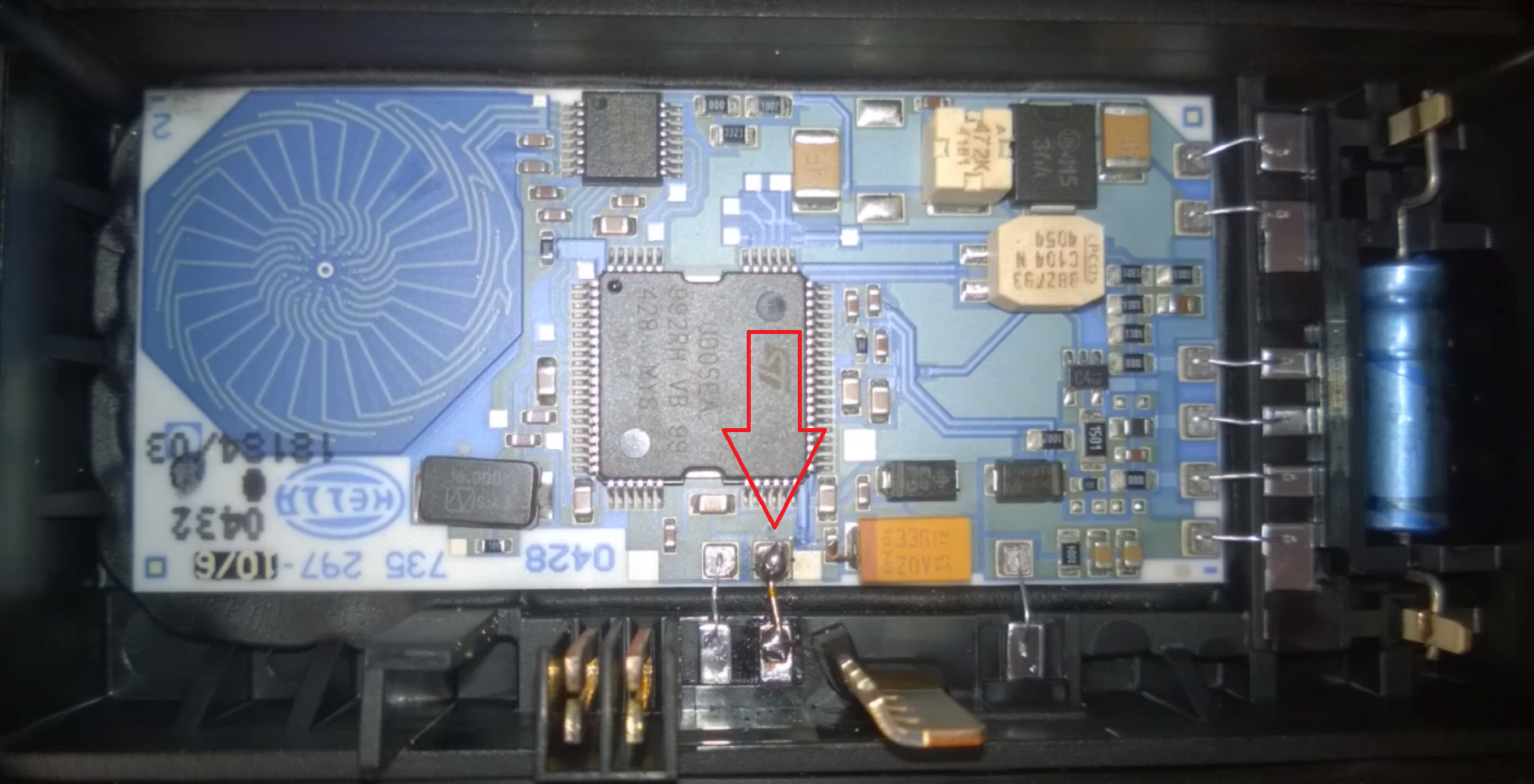

On OM642 engine is very common that electrical connection on turbo actuator is broken (see photo below). You can open the actuator and check the connection. It's easy and free fix if you know how to solder.

@artim808 - Thanks for that. I don't have the OM642 engine but I will have a look and see if there is a similar set-up and issue. Will have to be over the weekend now.
Appreciated
