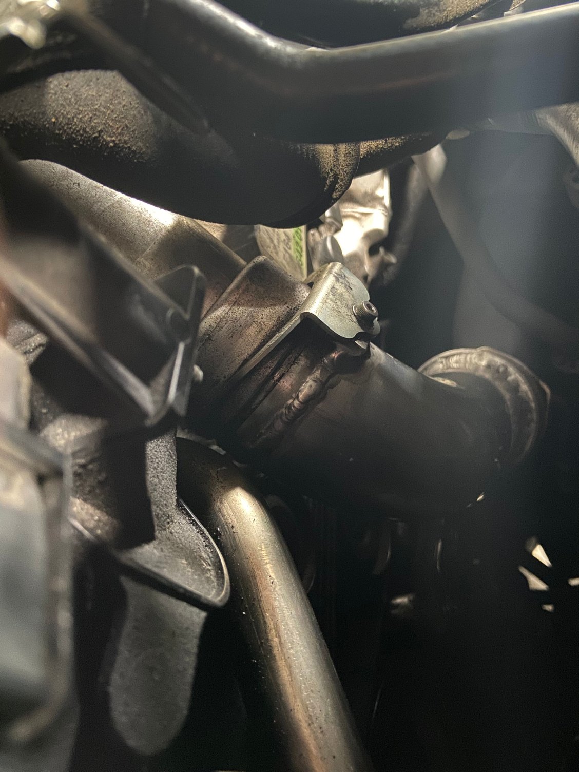

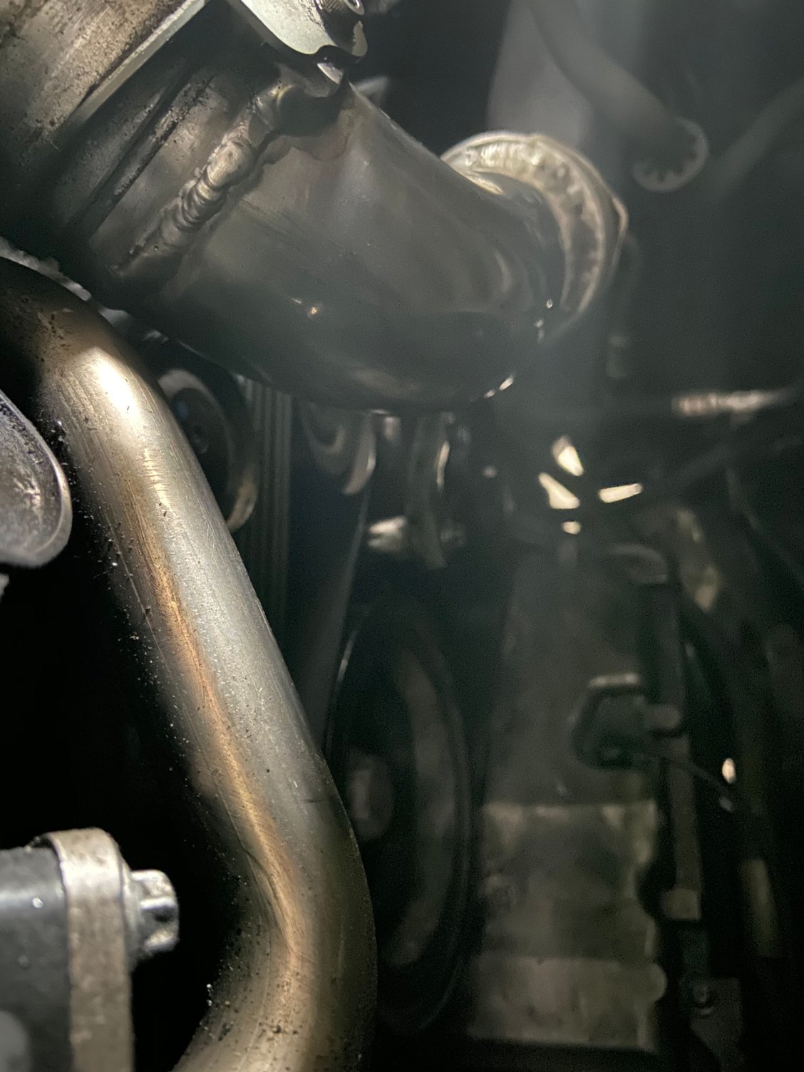

So. I have a 2008 gl320 cdi which has been leaving larger puddles. There is a lot of oil that I can see on the front of the engine. The source of the leak is where the charge pipe meets the resonator delete pipe. I can wipe dry and after a short drive it is noticeably wet behind. I brought to a shop to replace the o-ring. They called and said the valley is full and the leak is the oil cooler. And were not interested in replacing the seal but doing the oil cooler replacement. I don’t doubt there may be a leak but I wanted to see how much this front leak is contributing.
also concerned with how much oil being pushed through the seal. Possibly failing ccv. I replaced 50k who or an issue with turbo seals.
anyone replace this seal?

seal from the CCV to the intake was out of place recently and probably did leak into the valley. I am going to replace the CCV again to rule out cause of excessive oil in the intercooler pipe. Other then that it must be the turbo or engine. I replace 50k ago due to smell as oil was seeping and burning off from it. Possibly just the diaphragm is defective pulling oil in. Also I will change the oring/seal at the charge pipe/resonator. That is definitely the the source of the oil leak. As it is wet on the the back side. This is the highest point of oil. I had the oil housing replaced and it is dirty but not wet. The oil is being slung some from the belt and resembles the oil housing leak.

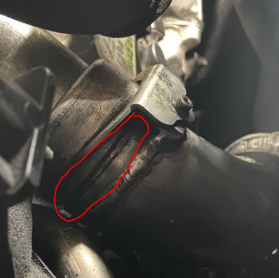

I'm fairly certain that the clip above the red cicle is supposed to be in the groove that the red circle outlines. Resonator delete may not be inserted all the way in the upper charge air tube.

I don’t think so unless it moved. Plus there is a secured hex bolt. This has been installed for probably 50k or more also.
Be honest which I did not mention is that I drive this SUV more like a car. I often accelerate rapidly so possibly that has heated things up a bit wearing out gaskets or diaphrams. 😬
