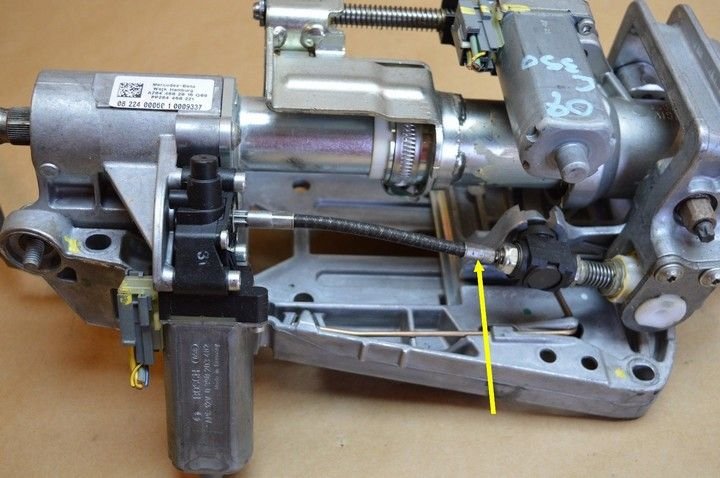

I had mine stay stuck in the upwards position, and I'm the type that will not pay someone to fix what I can do so I went to work on figuring it out. I could hear the motor attempt to move it, but nothing happened. I figured it was
like how some things, like elect windows, get stuck because they drive full force until stopped, then can't overcome the stiction to free it and go back. So I tried hitting the wheel a little but I hate pounding on expensive things
unless I can see it can take it, so I took the cover off for a look-c. I pushed the lowering lever and could see the flex shaft move under the torque of the motor, but the screw wasn't budging. I simply turned the drive shaft at the
yellow arrow with a tiny 4" adjustable wrench, aka "All-Sixteenths" to unstick it and it was fine. It was just barely tighter than the motor could drive so I bet hitting the wheel harder may have done the trick. After looking at it I
believe hitting upwards on the wheel would be the trick in freeing it because it would reduce the tension causing the excess stiction. Or maybe just pushing up on it, for a moment, with your thighs would do the trick?
It hasn't done it since and has maybe 500 cycles on it so far, but if it happens again we'll see. I don't want to disable it because that would be admitting defeat, and imo taking a car to dealer is also admitting defeat
The assy in the pictures (I found online) is upside down btw. So fyi to anyone interested:
