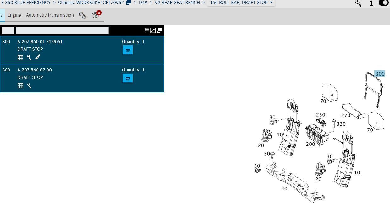

Mine got torn by one of my dogs last week ( paws right thru it ) . It is the center windscreen on top of the back seat, it goes up and down with the top down to help reduce wind from entering the back of the interior with the top down.
1. part number ?
2. instructions on how to remove it from the car
3. is the screen material itself removable from the frame? How ?

Draft stop original part # 2078600174, current 2078600200 see attachment to replace. Shop either used, https://www.mercedespartscenter.com/ new.

finally got around to ordering this. Used the new MB part #. Perfect fit. Literally took 5 minutes.
Konigstiger, thanks much for the pdf,
To any one reading, the damaged screen "can " be rebuilt if you take the time to slowly pry the frame apart. Cut the new material to size and then reassemble, may need an appropriate glue to with stand the extreme temps of the rear window area.
Might suggest fiber glass screen cloth or aluminum screen . Paint it black to match
Enjoy !
