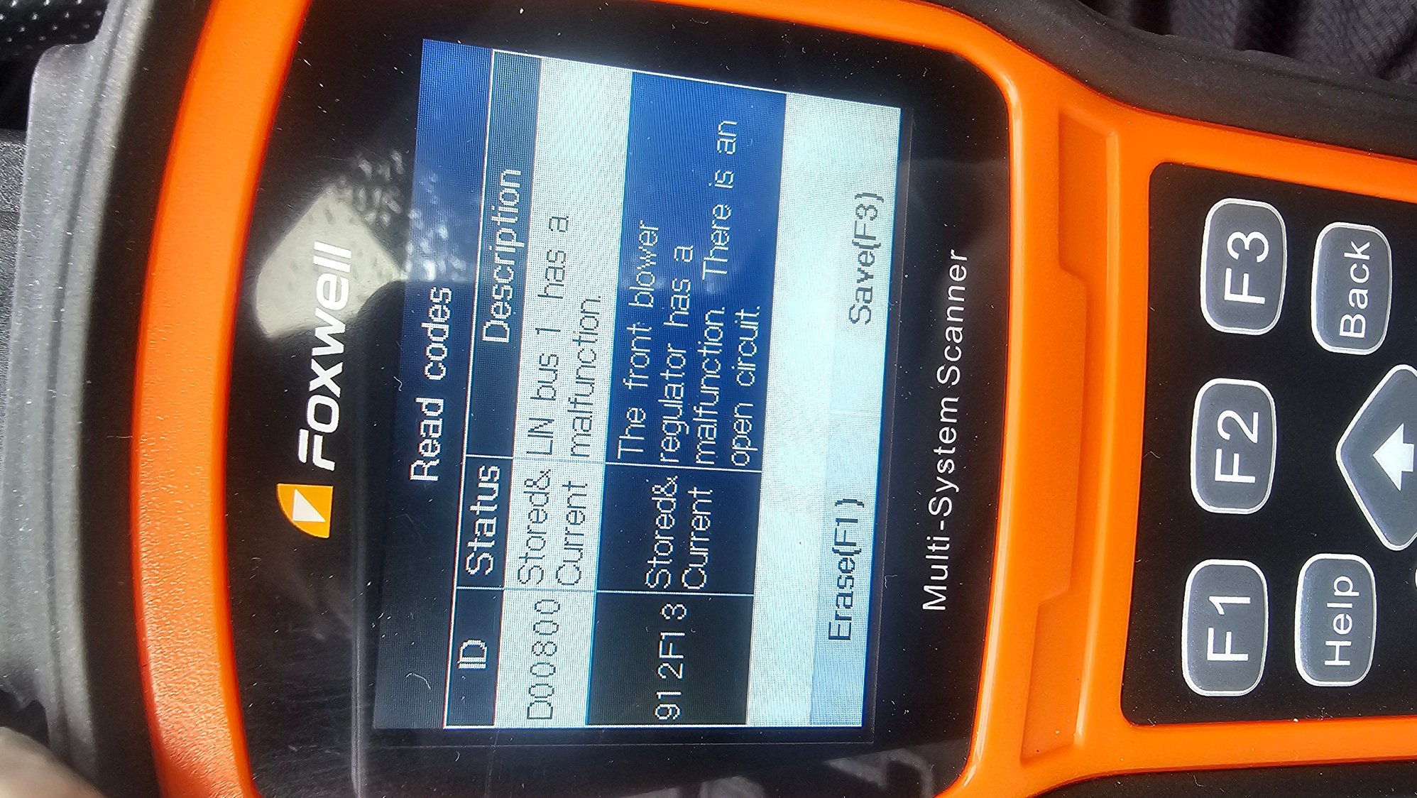

Ressurecting this tread. My blower stopped working. Before it stopped it was making little chirping noise which I know is a sign of the motor. 2 days ago it stopped working all together. So decided to replace both motor and regulator. The motor and regulator is the original part. Replaced both parts with original MB parts. Tested the old regulator (ohm) and the last pin was going in and out so was thinking that is the culprit. Tested the wires on the conncetors and everything was okay including the signal (also tested the voltage on the scanner of the fan speed and it is okay). Not sure what is wrong now. Pulled out these codes:
Before I bring it to the dealer to be gang raped any input from you guys?

Fixed my issue. There was a disconnected cable behind the climate control. Most likely it dislocated itself.
