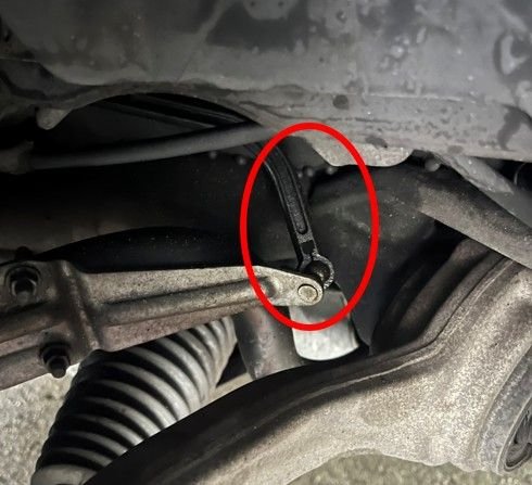

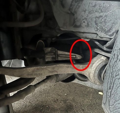

I found the issue. The plastic level sensor tab had come off. For those with the same issue, it's a simple fix. It is a simple ball and socket and I just pushed the socket back onto the ball. This is the third time this has happened, so I'm not sure it will stay on. Anyone know the part number?
If you turn the wheels all the way to one side, you can reach from the front side of the tire to the level sensor.

I ended up just using a thin piece of black duct tape. Once the tab is installed correctly, the ball is there just to keep it in place. It appears either the hole enlarged or the ball wore down and was smaller, as my tab was coming off all the time. The tab does not actually ride on the ball, the ball is just to make sure the tab does not come off. After the tab has been installed over the ball, anything that makes the ball larger to prevent the tab from coming off will work.
