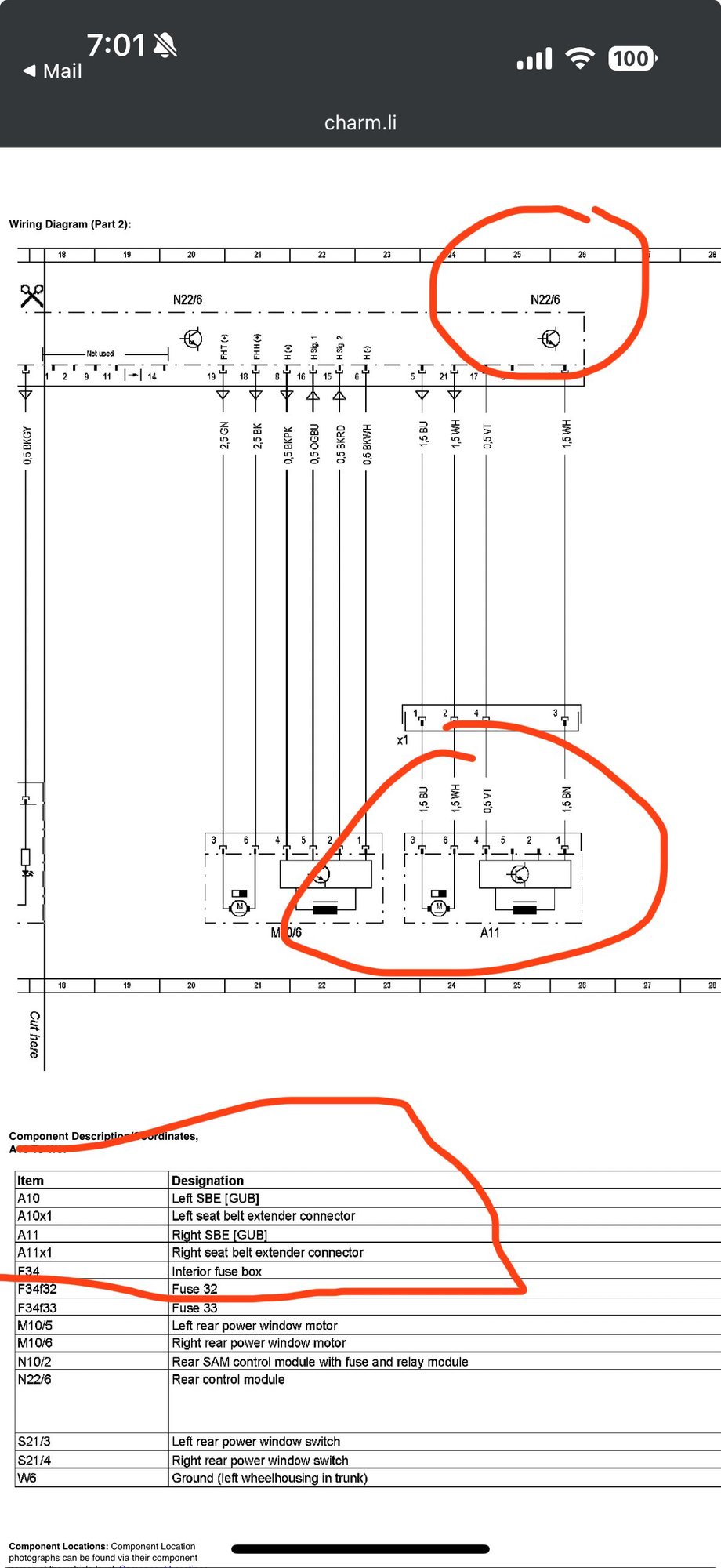

My driver side is not presenting, and theres no motor sound too.
and on XENTRY it says REAR CONTROL MODULE (N22/6) and RIGHT BELT PRESENTER.
I guess i shall change the N 22/6 module first.

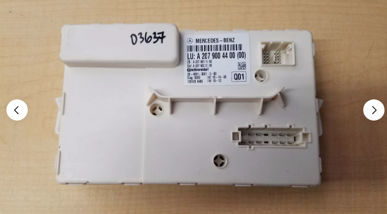

My is a cabriolet and my part is 207 900 43 00. I don’t think it cost $30-40
The part number you provided is for the convertible roof control. That is not the seat belt presenter part number(s).

I have looked thru WIS wiring diagram and have confirmed that for convertible A207, the roof module controls the seatbelt presenter too.
Does that mean that a different part number than A2079004400 is needed for the cabrio? I have the same issue with my A207 2011 E250, the seat belt extender is not working and is currently stuck extended. The roof operates normally though.
I was just about to order the rear control unit part no. A2079004400 as previous advice from ibbij.
Any guidance would be appreciated.

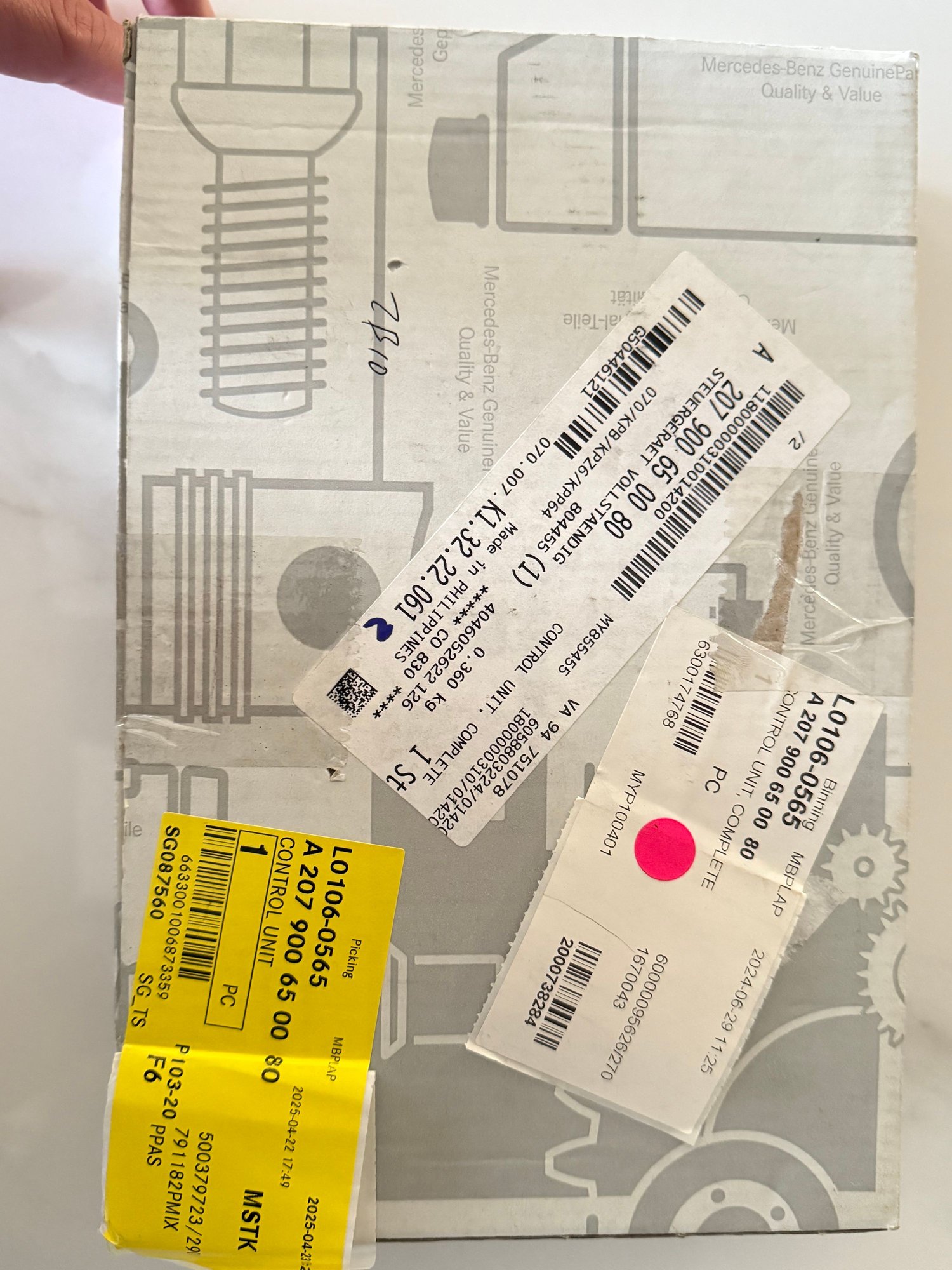

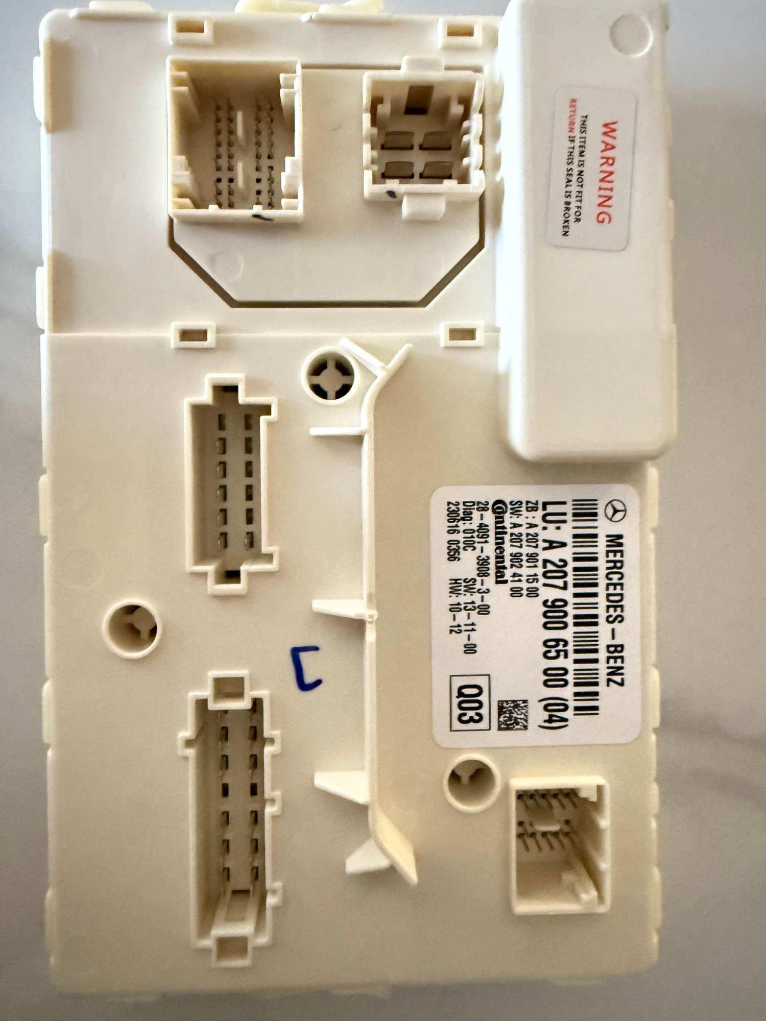

Hello all,
I would like to share how I fixed my seat belt extender. @leo015
Background
I am driving a Mercedes A207 2011 E250 Cabriolet. Seat belt presenter for driver side not working.
Error on Xentry as follows:
N22/6 - Rear Control Unit (SG-FOND)
- B229949 - Control unit 'Rear Passenger Compartment' has a malfunction. There is an internal electrical fault
- B273E29 - The position sensor 'Right Belt extrender' has a malfunction. There is an invalid signal
Research
So i have XENTRY (offline), EPC and WIS. I studied the wiring diagram and realised that N22/6 is connected to A10 (left presenter) and A11 (right presenter).
I ruled out the motor of the extender spoil because i dont hear any gear or motor sound.
Control Module
Locate the original module in my car. Item was A 207 900 43 00
Went to my local (singapore) stockist and bought the control module A 207 900 65 00 (Part number different because this is the supercede of 43 00)
Installating the module
Plug and play only. Tough part is accessing it as its located at the rear right of the trunk (right hand drive)
Coding
- No flasing required
- Coding require only 2 settings:
1) Air cap install (Yes/No)
2) Seat Belt button (Active/Not Active)
- Active - Button at center aircon vent area)
- Not Active - Button at the row of buttons below the COMMAND
No requirement for XENTRY online.
thanks @Chevota @ibbij

Originally Posted by leo015
Sounds good. Is there somewhere you would recommend I can get it within the EU without paying dealership prices? Also just out of curiosity, the part no. A2079004400 previously advised would not work as it has no wiring for the seat belt extender correct?
A2079004400 WONT work for cabriolet. take alook at the photo below. this is for COUPE
the number of connector is different.
for cabriolet, it control both the roof and seat belt
Old Jul 9, 2025 | 03:11 AM
leo015's Avatar
Joined: Jun 2025
Posts: 22
A207 E250 CGI
Loud and clear, thank you!
