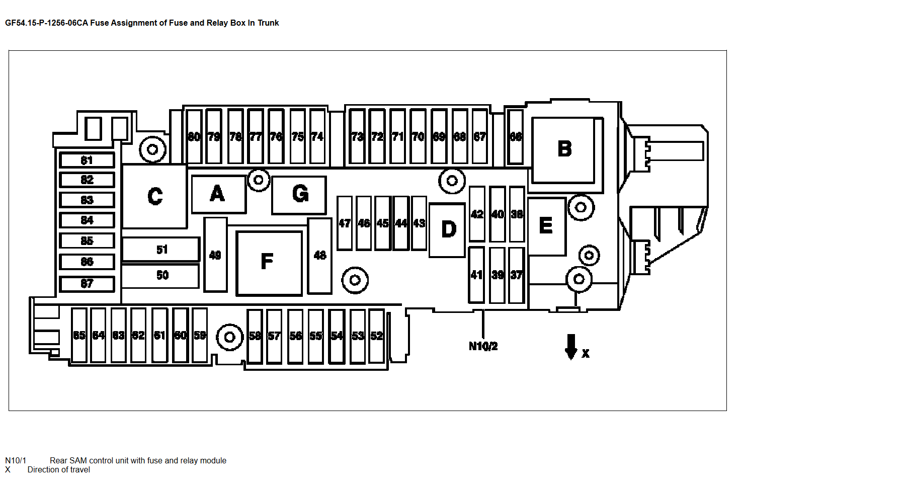

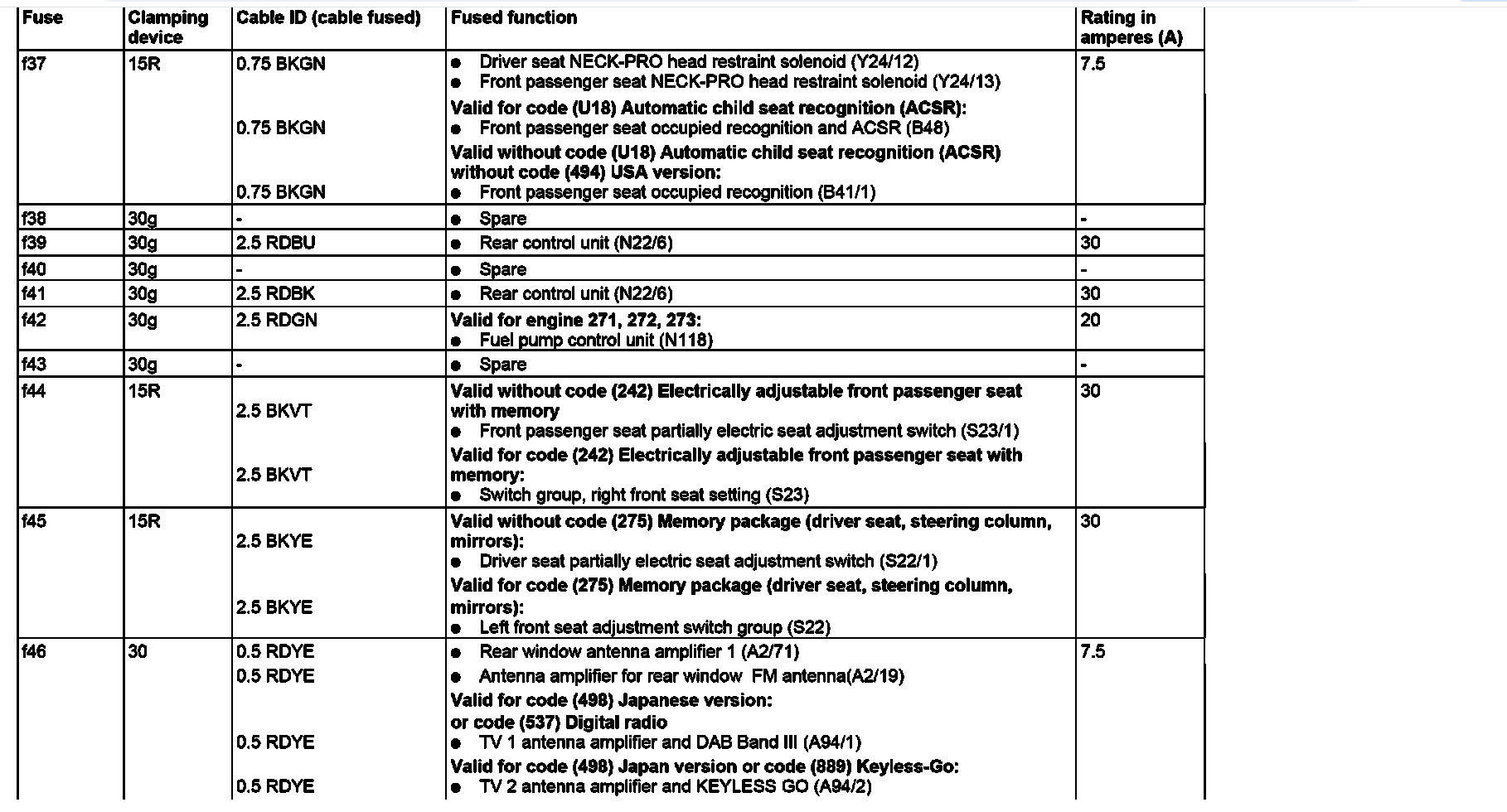

Heres the manual ive been looking thru: https://charm.li/Mercedes%20Benz/201...d%20Diagnosis/
Fuses found under Power and ground distribution > Fuse.
Can also look under Body and frame > Seats.
Fuses in trunk. Seems 44,45 and 60 are seat related.

Thanks Tim C. I have seen that diagram. I was looking in the trunk by the spare tire last night. The area that holds #60 seems to be missing some fuses or came that way? Also there are a few plastic half doors that cover some of the fuse. Do they rotate or something? I was afraid I was going to break them. If there was power to the seats wouldn't the control have a light on?

These sams are used by numerous models so may not be populated by the same fuses.
What is your vin, ill try to find the wiring diagrams.
And what control are you talking about, on the door or down below on the side of the seat? I just have basic electric seats in my W204 and dont think there is a light on anywhere for it.
Fuse 60 only applies if you have Option Code 409.
Looks like there are small tabs on the sides of the covers. Probably use a tiny flat head screw driver and push it outwards to unlock the tab.
