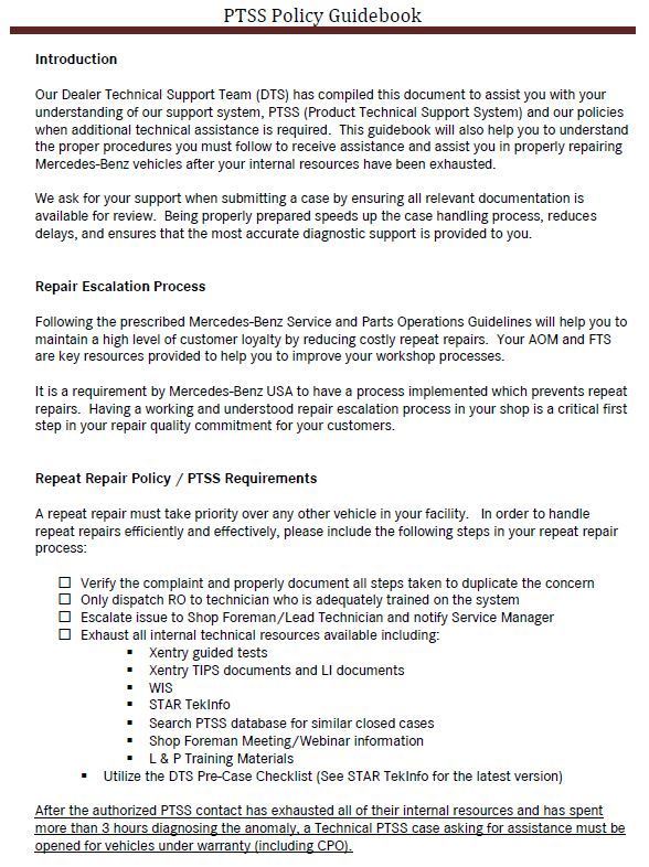

Bulletin “If a vehicle again suffers from the problem after the steps described above have been performed, please create a PTSS case” = request MB technical assistance.
Old Jul 5, 2021 | 11:46 AM
Whitefish50m's Avatar
Joined: Feb 2012
Posts: 4
From: Florida
2020 E450 cabriolet
Please advise how to create a PTSS
Old Jul 5, 2021 | 11:49 AM
konigstiger's Avatar
Posts: 15,901
Likes: 4,630
From: North Scottsdale, AZ
'71 Pinto
Not you dealer need to advise shop foreman or lead tech, see bulletin posted above.
