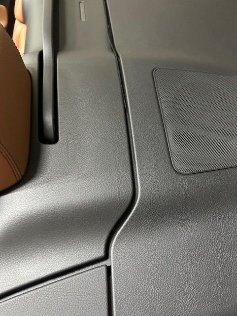

I had the same issue with my wifes car. The foam tape is a definite fix. You have to apply it on the front edge where the parcel shelf comes down and meets with the area just behind the rear seats. I raised the roof until the shelf with the two speakers was raised up and just ran the tape all along the joint where the front of the shelf meets the car when it lowers. Car is silent now.

Here are a few pics of the area. You can see where I put the tape in the second pic.
