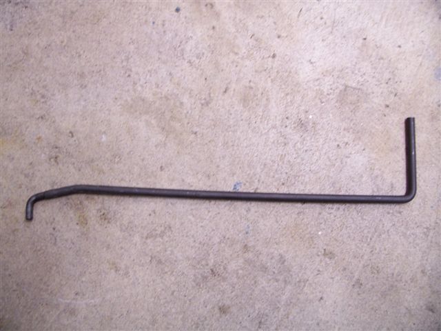

Okay, got it!
Indeed, standard (lefty loosey) threads. I bent a piece of metal rod to
catch the locking hole and with an oversized breaker bar it came out.

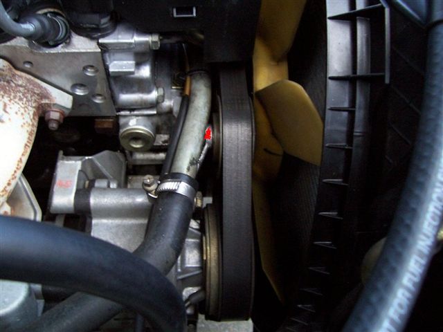

Old Jan 16, 2006 | 05:37 PM
Ron in SC's Avatar
Joined: Jun 2002
Posts: 237
From: Charleston, SC
99 ML 320, 97 Porsche 993 C2S, 92 300E
Used stethoscope to listen to different acessories and the pulley in the photo seemed loud, but I did not know where to listen for fan clutch bearing noise. I put stethoscope where you see the red mark in the photo.
It's hard to describe the noise kind of a whirling but loud not like the other acessories.
I just got this car a few weeks ago and I'm going over it. I've replaced the distributor and rotor along with lots of other stuff too.

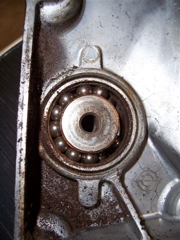

Old Jan 20, 2006 | 05:50 PM
Ron in SC's Avatar
Joined: Jun 2002
Posts: 237
New idler pulley and fan clutch bearing bracket installed, very quiet now. Photo of old bracket, no grease in bearings at all. No wonder it did not seize.

Cali300E stated above that the bolt loosens to the left. He is correct. The bolt comes off without problem if you insert counter-holder (Special Service Tool #103 589 00 40 00) into the retaining slot of the fan bearing bracket and the mounting hole of the belt pulley. Photo below. Plenty of room to get torque wrench in there to tighten to 45 nm.

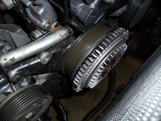

I was trying to do this operation yesterday, but even if I had the breaker bar, I couldn't find any slot where to jam the pulley so as to remove the center bolt without the pulley spinning. Does anyone have any pics or advice to add for getting the fan clutch off?
Old Oct 4, 2006 | 03:01 AM
jedcred's Avatar
Joined: Dec 2004
Posts: 453
From: Bay Area, CA
'04 Mars Red C230K Sport Coupe (not Coup-EH)
Here we go. Pictures for, as my father said, "the good of all humanity," since we couldn't get this to work right from the cryptic directions above. SO!
Here is a picture with the fan clutch and the pulley behind it off. You can obviously see the slot where the smaller end of the breaker bar mentioned above will fit to lock the hub in place so you can remove the center bolt. The hub has six holes: four that are threaded for the bolts for the pulley, and two unthreaded for the breaker bar to fit in. Here is a view from the top.
Again, I post these pictures because it is not really obvious where to stick the breaker bar, especially considering the 17 years of road grime caking the entire area, and with the pulley and the fan clutch in the way. Hopefully these will help some other frustrated soul.
