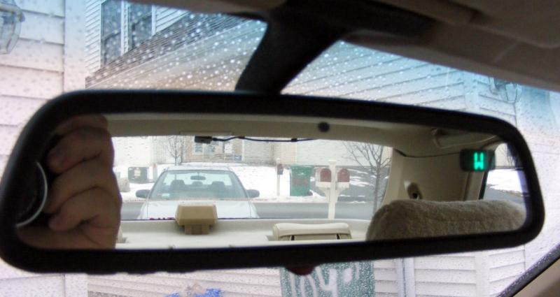

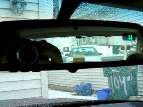

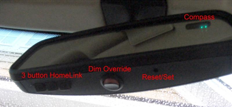

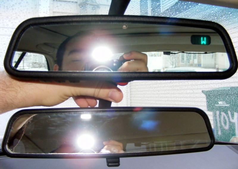

Mercedes Benz w124 Custom Rearview Mirror
This is a short video review of the custom w124 Auto-Dimming Rearview mirror with 3 Button HomeLink and Compass, as provided by Rik/2phast.
This particular model has a dimmer override switch that I asked Rik to install. It prevents the mirror from dimming.
Hopefully this will provide all the info you need about this wonderful product, and will motivate you to bring your w124 into the 21st century!
http://www.2phast.com/mirror/
To read more about the product, and to place your order!

Looks fantastic, Sai! Sheesh, now it has a better rearview mirror than my mom's CLK500. :P
Mabrook!

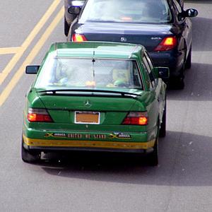

Saw this today while walking on the skywalk to the Rochester Auto Show.
Wasn't fast enough to get the front end, but my god haha.

FAIL!

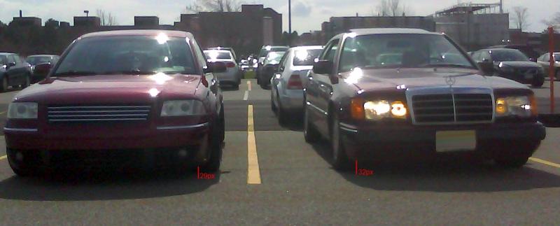

I'm almost as low as this VW here. I think I went too far! Not to mention the fact that I've cracked an exhaust hanger getting out of my friend's driveway. Tsk tsk, an inch or so on the suspension makes a HUGE difference it would seem.
How do people go lower than this and still drive at all?
You are running the same roads I am...and coming to the same conclusion. Funny how many of our friends here have learned the same, but it aint a real lesson if someone else shares their wisdom.
