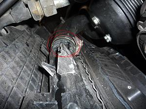

2. I found coolnat leak here. What is the name of the hose and what is the part number?

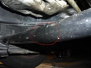

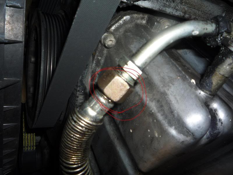

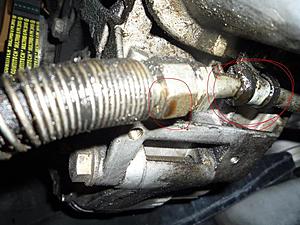

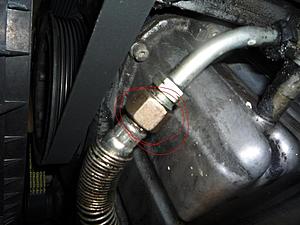

I also found oil leak under the car. I don't know what are these parts. Any advices?
This is right below the power steering pump

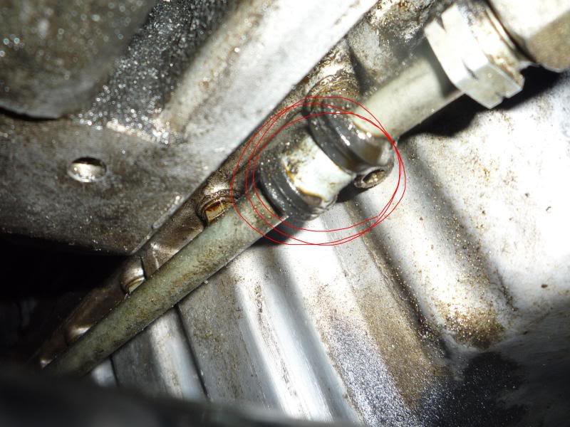

The top one is passenger side of oil pan.
I also noticed oil drips on the front swaybar.
While I was under the car, oil didn't drip or form after I wiped the area. I guess it's a slow leak, but I want to know about it.

Looks like you need an oil pan gasket

On any old car an oil pan gasket has the chance of being a problem. Just gotta take care of them thats all.
Those lines that you are talking about are transmission cooler lines. I dont think those are leaking though. I think the oil is dripping down and decieving you into thinking that they are leaking.
+1 on that.
The first picture you posted of the back of the radiator is the return line from the radiator to your engine. If it is leaking, it is likely a broken inlet for the hose. The plastic on these becomes very brittle over the years, and WILL crack eventually. You can slow the process by making sure the clamp that holds the hose to the inlet is as close to the base as possible, and making sure to use distilled water to prevent rust corrosion.
But alas, you will need a new radiator in the not too distant future. I would say that if you have a local junkyard and you happen to see a good one, nab it and swap it in even if it's still holding up. Decent ones are not hard to come by, until you absolutely need it.

Thank you so much for all the advices.
Rivcal4life, thank you for the detail information. I touched the hose and I could feel plastic thing inside of the hose.
So are you saying that I can't just replace the hose? I have to replace the whole radiator?
If I just replace the hose, do I have to drain the coolant? I just flushed coolant system...I hope I don't have to drain it again.

Gravity always forces an oil leak down, trace it up to the highest point of the leak and inspect. Judging by pictures it may be higher, kinda hard to tell... My 2 cents

As for the first pic, you can just replace that hose. Maybe first just try pulling it off completely, cleaning it up and retightening it. If its cracked though, ditch it.

I have the same problem on my car....for the coolant leak you just need to buy new clamps for it...the oil leak is probably the front timing cover...i need to put a qt every 3k miles....

It would be nice if it was just a clamp or the hose itself, but so far every leak with these radiators (and those of most other cars Ive owned) has proven to be broken mounting points for the houses. The plastic inlets and outlets get brittle and break on almost every car at some point.

You can't order just the inlets. At least not anywhere that I know of. If would be worth looking for though if the body of your radiator is still good.
If you look at the photo closely, you'll notice where the metal ends, and the plastic begins. The metal is clamped around the plastic reservoir every couple inches or so. I suppose if you find a decent plastic reservoir at the junkyard or online, you could bend back the metal tabs and swap it out with yours, but you may end it with a bigger leak than you have now, and will have ruined a potential replacement in the process.

I still don't get the inlet thing. So if the plastic thing is broken, how can I fix it? There is no part to order, then...
I guess I have to take out the hose and see it myself. Am I going to loose lot of coolant by doing it?
The leak seems only happen when I open the coolant reservoir cap when the engine is warm or little hot. Usually nothing leaks there.....isn't it strange??

Basically the inlet is just what the hose clamps to. You can undo the top one fairly easily just to get an idea of what Im talking about.
