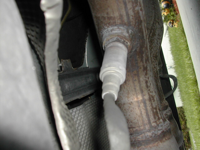

I'm working on my car right now and took pics for you:

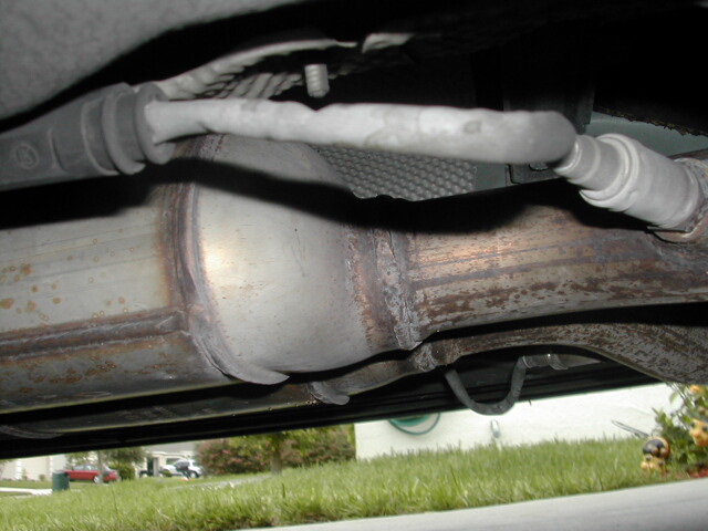

As you can see in the pic..very very easy to change...Hope this helps.

The metal part bolts off and the plastic part pops off...1 min job.
