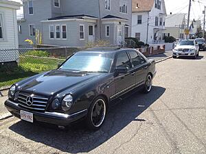

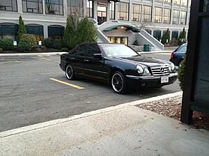

are your wheels 18x8.5? mine are 18x8.5, ET35 all around. before lowering, I thought the rears were gonna be pretty close to the fender. I was wrong. lol
here are a few before and after pictures with 25mm spacers.
before:
before lowering:
after 25mm spacers:

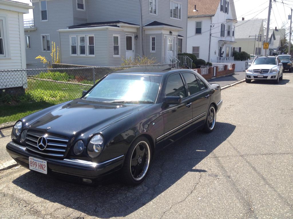

Old Apr 17, 2013 | 10:22 PM
tweakrunsthis's Avatar
Joined: Mar 2013
Posts: 29
97 E320
Anyone running 235/40/18 with H&R or eibach springs?-otjuhas.jpg
Only pic i have at the moment.. Car is at a slight angle so it looks a little wierd

clean car man. I couldn't find the springs I wanted, which were the H&R sport cup kit springs (set comes with springs and shocks together). I had 2 chances to buy fellow member BADwayz's set, but I didn't have the money when the chances came up.
Here's how his car looked with the cup kit:
http://www.benzworld.org/forums/sale...r-cup-kit.html
since I couldn't get those springs anymore and I didn't want to pay for a new set, I just met up with another fellow member, desired_speeds, who was swapping his e55 springs out. so we cut his e55 springs and put them in mine. still trying to get a little bit lower though, so I could get the same ride height as BADwayz. lol

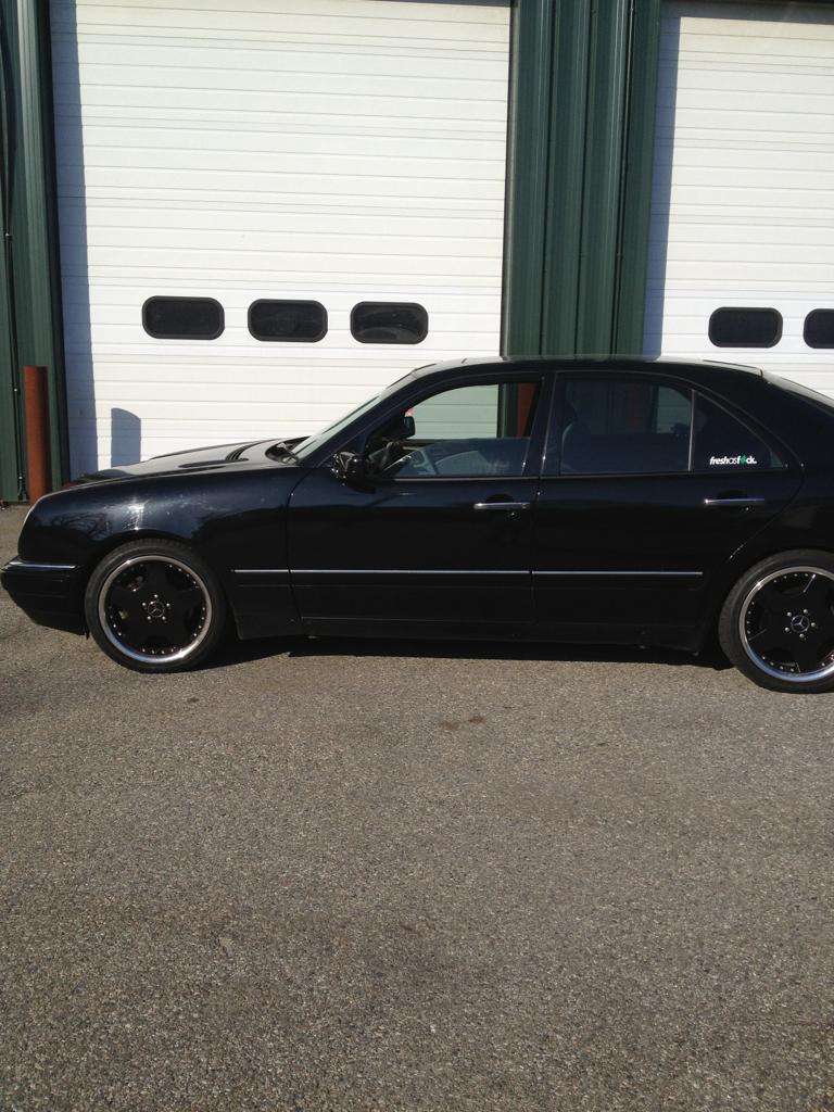

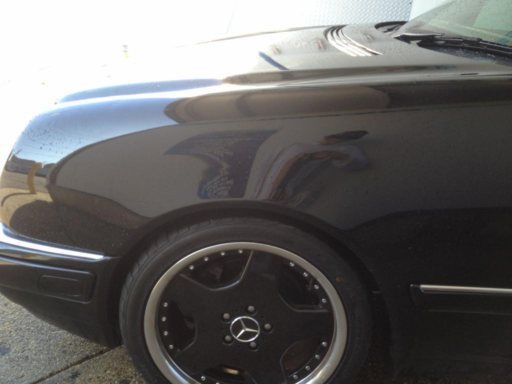

Old Apr 27, 2013 | 07:25 PM
Joined: Mar 2013
Posts: 29
97 E320
Anyone running 235/40/18 with H&R or eibach springs?-vob0w1v.jpg
Anyone running 235/40/18 with H&R or eibach springs?-ijnruh6.jpg
Anyone running 235/40/18 with H&R or eibach springs?-eroeai5.jpg
Those r the eibachs that lower it 1.2 ride has not changed at all still smooth, steering a little better... Now i just wanna change in #1 spring pads cuz the backs not low enough for me lol i had 5s upfront and 3s in the back.... Sucks i already had the springs put in lol
