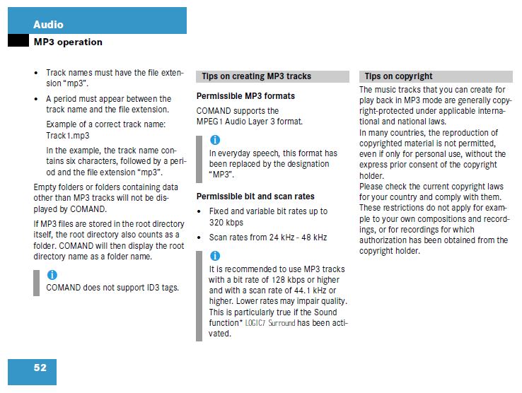

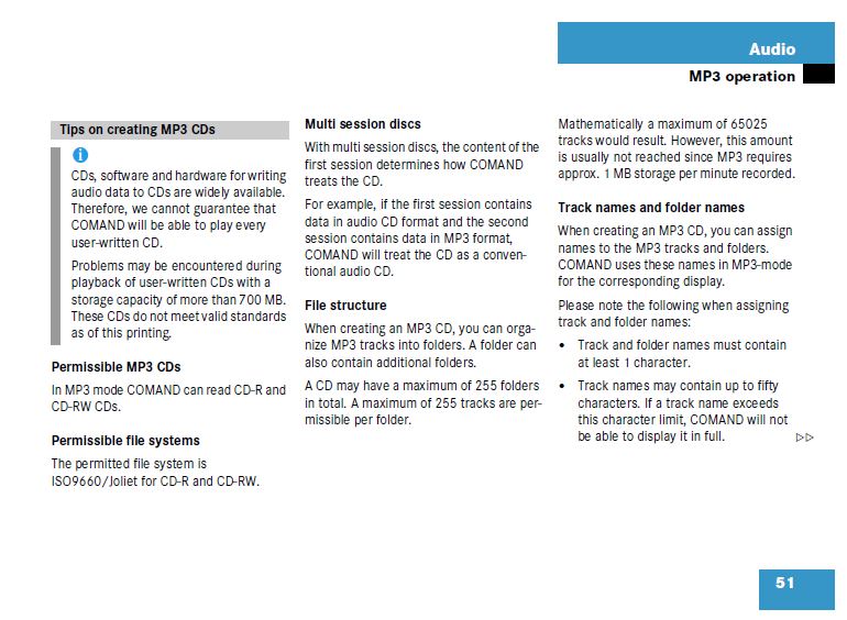

I saw this somewhere in the forum, but it's eluding me now. Can someone please point me to some help in burning mp3 discs that are readable in the CDC? I have burned several and they all play fine in the head unit but only 1 has worked in the changer.
Old Jan 11, 2015 | 12:02 AM
  #289
konigstiger's Avatar
Posts: 15,901
Likes: 4,632
From: North Scottsdale, AZ
'71 Pinto
This may help.
Attached Thumbnails COMAND HEAD UNIT software update to enable MP3-capture1.jpg   COMAND HEAD UNIT software update to enable MP3-capture2.jpg
Old Jan 12, 2015 | 03:45 AM
  #290
nwnoodle's Avatar
Joined: Jan 2015
Posts: 6
2005 E 320 Wagon
This may help.
Thanks.
I read through the manual before posting. Maybe its the cd-r's that I have. Its being quite picky.
