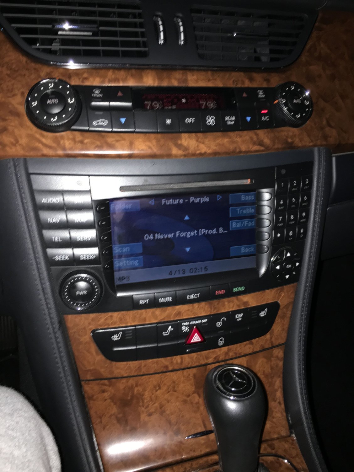

I'm actually still not sure if I have fiber optics I've just assumed it. Does this mean I have fiber optics amp.. (harmon kardon is not written anywhere inside my car).

Looks like NTG1, you likely have the an optical cable to an Amp in the boot.
Best to check.
Remove rear left felt panel in boot.
You will see a stack with DVD (for NAV) etc.
Behind that is a vertical metal divider rising from the wheel arch.
The Amp should be behind that in turn.
http://www.benzworld.org/forums/atta...0-bose-amp.jpg
