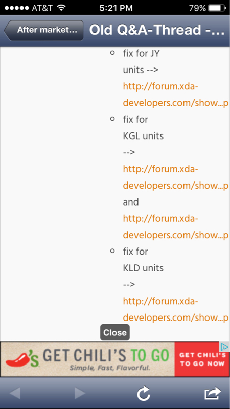

Originally Posted by NubyIz
Try here: http://forum.xda-developers.com/show....php?t=2660662 Look for "PROBLEMS AND SOLUTIONS FOUND BY THE USERS" towards the end of first post. Click on "show content". Then look for "Mic sound is awful" and again "Show content". Cheers
Ahh ok, next question is which unit do we (I) have?
Attached Thumbnails After market Android 4.4.4 Quad Core complete install. Vids and Pics and txt-image-3193112166.jpg
Old Jan 11, 2016 | 08:26 PM
  #135
NubyIz's Avatar
Joined: Jul 2015
Posts: 47
C219 CLS350
Hi, sorry, really dont know.. thats the limit of my knowledge.. suggest to browse through the whole post there, seems to have a lot of knowledge and might help u identify which model you have.
See the Settings-> About screen. It'll say which model in one of the text strings. All info that's needed is in the first post of that huge XDA thread.

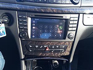

I had mine installed. Couldn't be happier with everything from the phone, BT audio and navi. I'm struggling with the Torque feature. I purchased the ELM327 but Can someone provide some info on how to set it up on the HU.

Old Jan 13, 2016 | 12:28 AM
  #138
tubaprde's Avatar
Joined: Dec 2009
Posts: 411
E55, past: SL55, 560SEL
Damn that probably means there's a problem with my individual unit's Bluetooth. Looks like you have the same unit I do.
