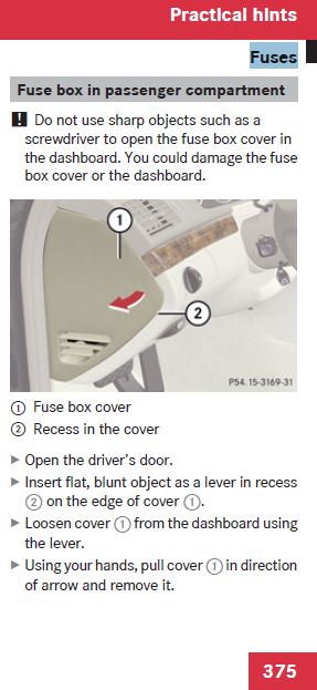

You can try pulling driver seat adjustment control unit fuses for a while then reinsert in an attempt to clear: interior (side dash) f34 & rear SAM (left trunk) f1.
Well, I tried pulling the F1 fuse in the trunk area, but it didn't change the symptoms... Not sure where the side dash fuses are. IN my manual, it only shows the fuse compartment in the trunk area.
See image. No guarantee as it may work, may not - a last effort before having someone normalize control unit via SDS. Switch off ignition and remove key from ignition, Keyless-go locate key outside of transmission range – remove both fuses simultaneously, wait at least 10 minutes before reinserting.

Konigstiger,
Here is the latest. I just saw your post, but in the meantime I had the wife swing the car by the indie shop. Apparently, the mechanic could move the seat back to its farthest back positions, and move all three axis of the seat, so that was good. But, when he went to use the switches, the seat would go back to its weird state. It would move forward, but then only move back to the halfway positions. I asked if they tried to program the memory position, to the far back position and just leave it as it. He tried that, but that didn't help either. He is thinking the switch, but that makes no sense to me. You can make the seat move back and forth, you just cannot make it drive all the way back once you pass a certain point. This is for all three axis.
Any ideas? I still think its a program issue. Like its stuck in a re-sync mode or maybe a memory mode of sorts?
