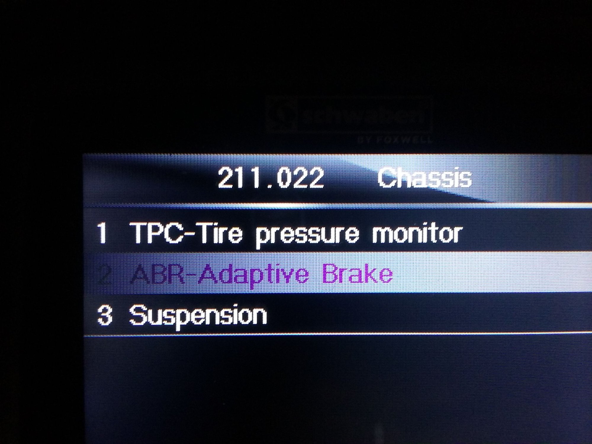

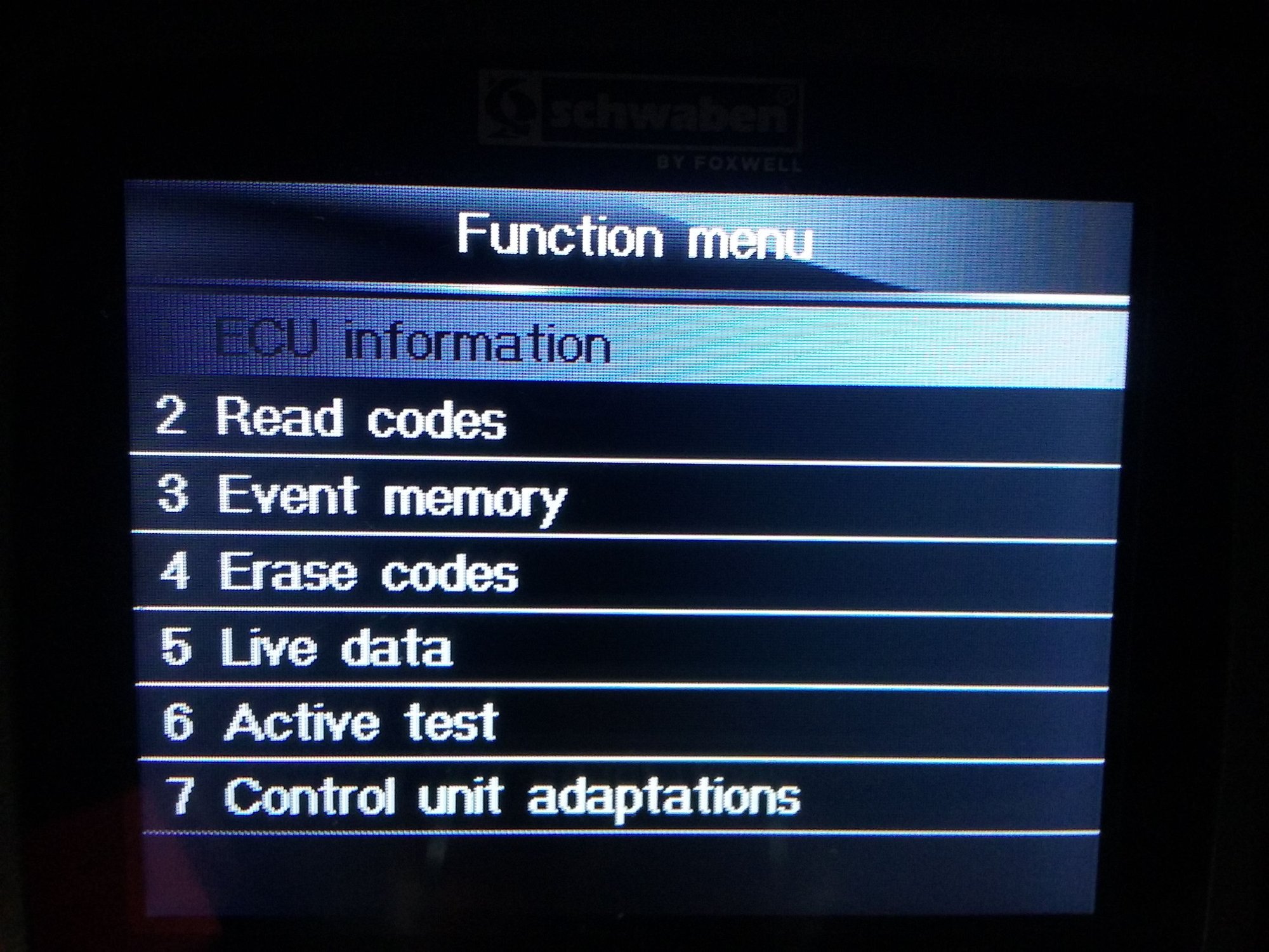

more functions on W211
So spend some "quality time" with scanner on W211 this morning.
Scanner is slow. It takes 10 minutes for auto scan and each function scrolling require long wait. Few times when I had "wait" screen for couple of minutes I reset the scanner assuming it froze, but then few times it just took long wait for scanner to communicate. Small screen often shows only part of the display and scrolling long text can be confusing as it automatically rolls over the page.
But GOOD PART the scanner does good testing on W211
Did EGR test, run simulated compression test and that alone might be worth the scanner price if you are buying used car (the simulation is not too accurate per several experiences, but beats pulling glow plugs)
Now since SBC come to the question here, I don't have it on my W211, but here are screens that show when I enter my car system. How much it would show on SBC I don't know.
