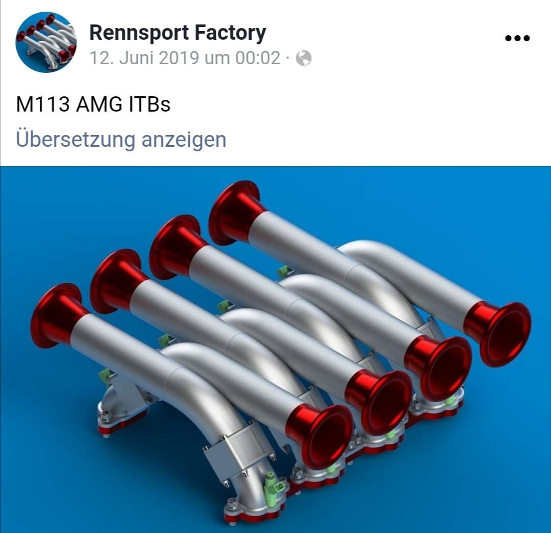

Your mods are cool, but I didn't like the carburated stuff. But I'm also sure, that the intake manifold of the M113 is crap and there should be an option to go with some racing intakes. There is a company calling Rennsport Factory, they are doing some fine stuff for all M113 variations. See the pics
I didn't do my intake manifold or convert to a carburetor because I felt the factory one was "crap" as I am confident it is very well designed and matched to the engine. I dont think my way is in anyway better than what MB produced but it is indeed my own design and that's what hotrodding is/was all about. Anyone can, and most do, just buy other people's design and bolt it on. You can't really have something unique if we all just sit around and wait for someone make something for us to purchase.
The Rennsport stuff is obviously extremely nice high quality parts that we could all be proud to own and enjoy but way outside of my price point. I love that they will put so much effort into the engineering and design in their products if even for a very small market. My engine will not appeal to much of the MB crowd but at least it will be the only one in exsistence and for whatever reason that appeals to me as much or more than if I purchased something off the shelf no matter how much I spent to obtain it. It would be great to see more MB fans fabricate their own stuff but I understand the cars have become much too complicated for many to be able to. Technology has killed much of the tinkering car fans used to be able to enjoy.

do you have any spare intake manifolds by chance? Was going to build a custom one for my twin turbo M113 55 project
