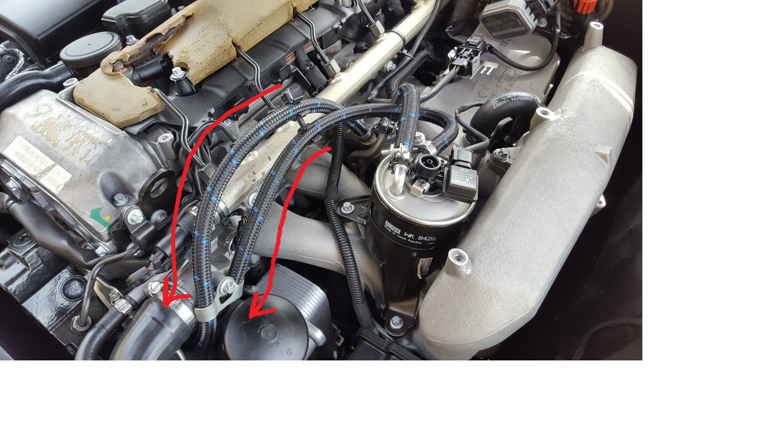

Originally Posted by tjts1
Pull the engine cover. I think your fuel filter is located just above there with a couple of hoses going to it.
WK482
Do you think it's leaking where the fuel hoses connect on the other end (in red)? It doesn't appear to be leaking from the fuel filter side at all. It's completely clean with the exception of normal grime build-up over the years. I haven't traced them to see where they attach on the engine side.
Yeah, I'd be looking very closely at those hoses.
