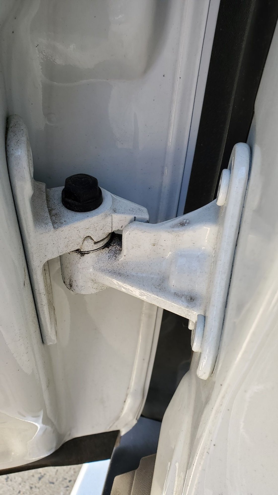

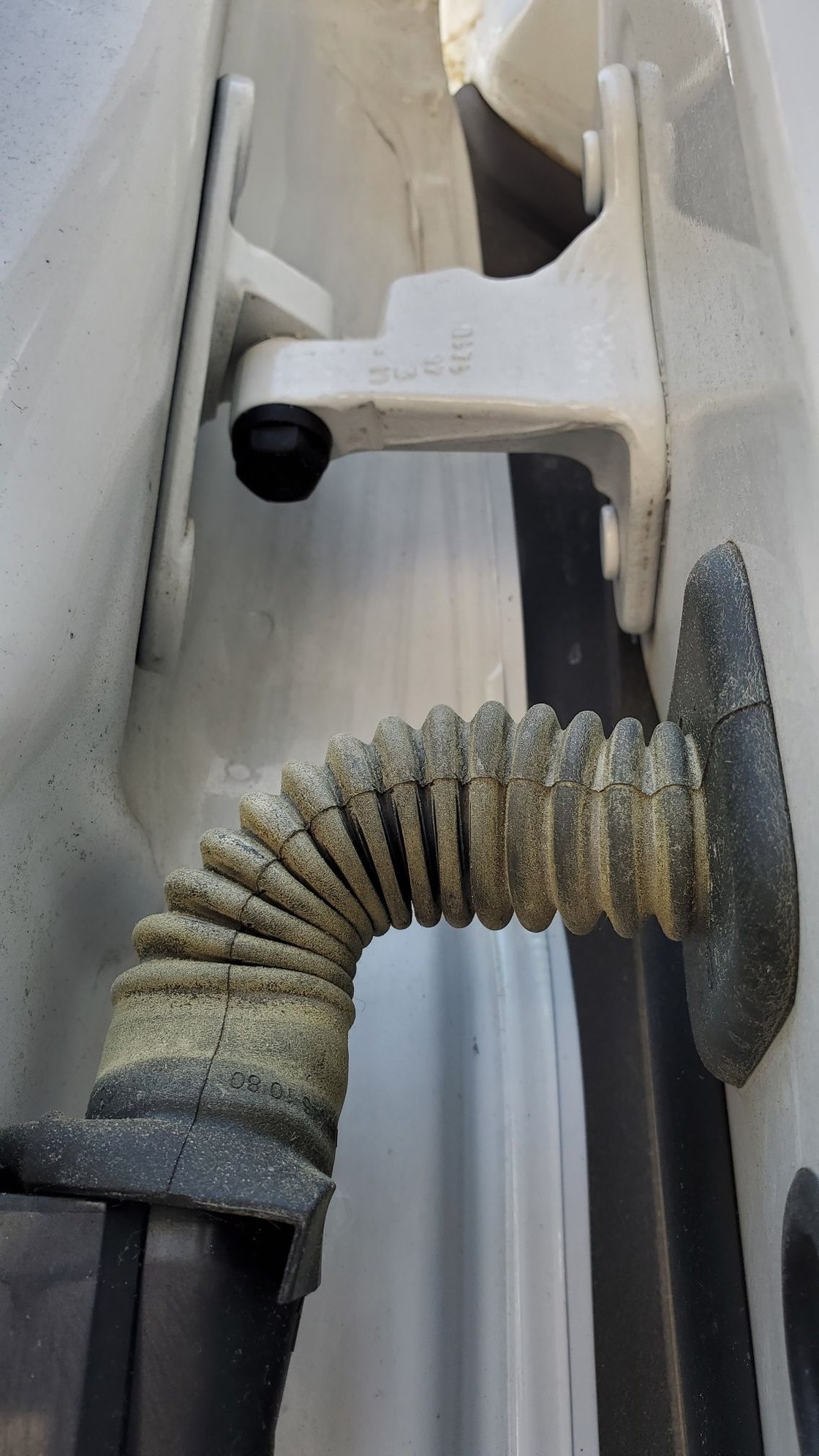

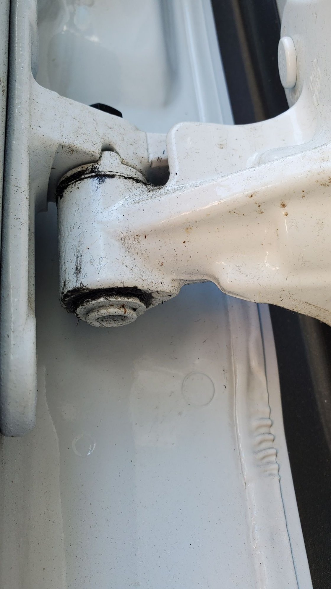

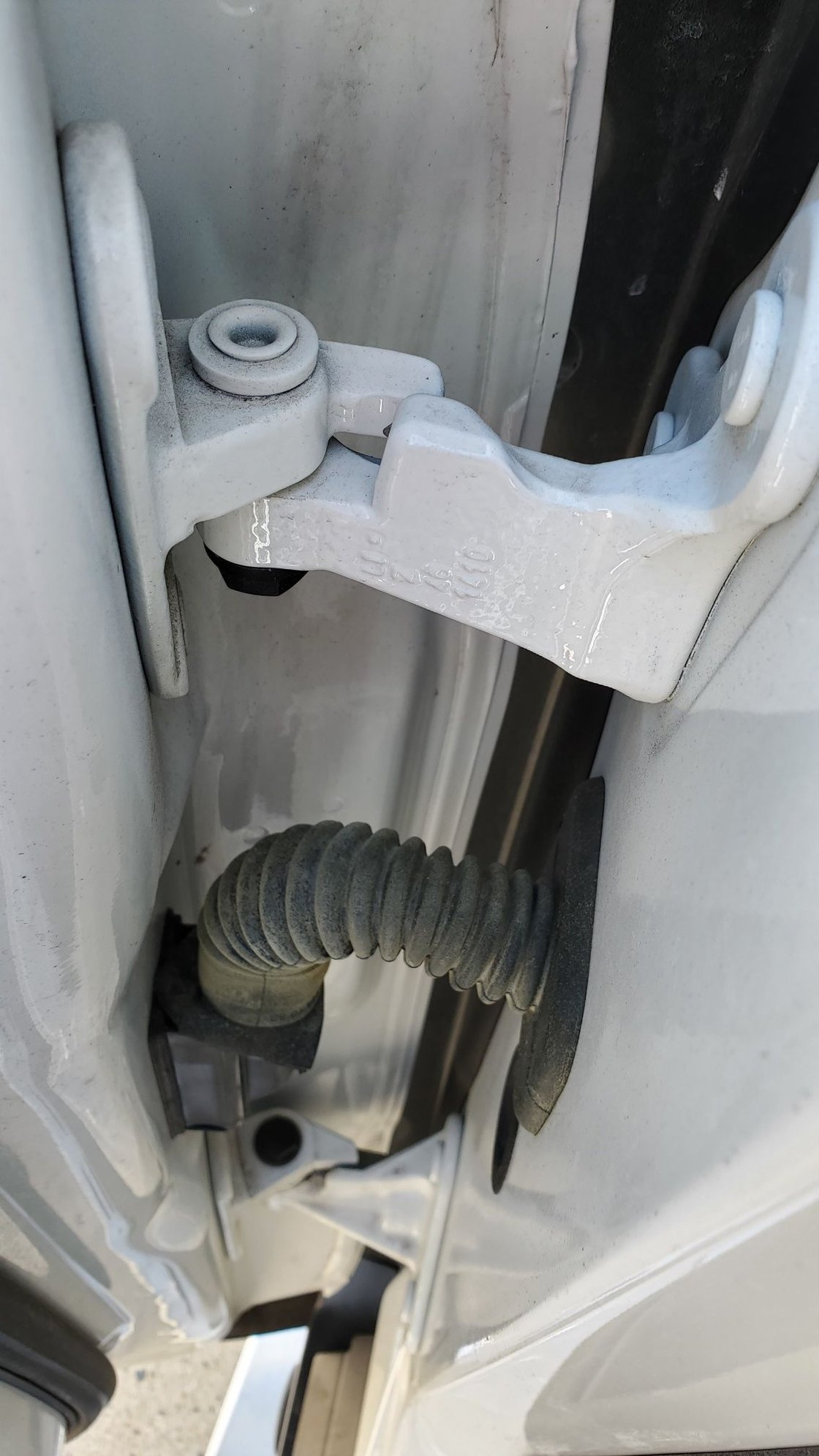

It looks like MB has many variations of hinge.
This is from my ML350 and there's no small bolt anywhere.
It does look like the bottom hinge has old grease where there is metal to metal contact.

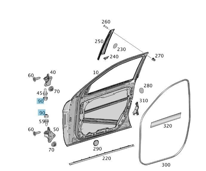

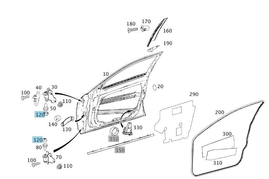

Need to carefully pry off cover. First two captures = front, rear E, second two = ML.
