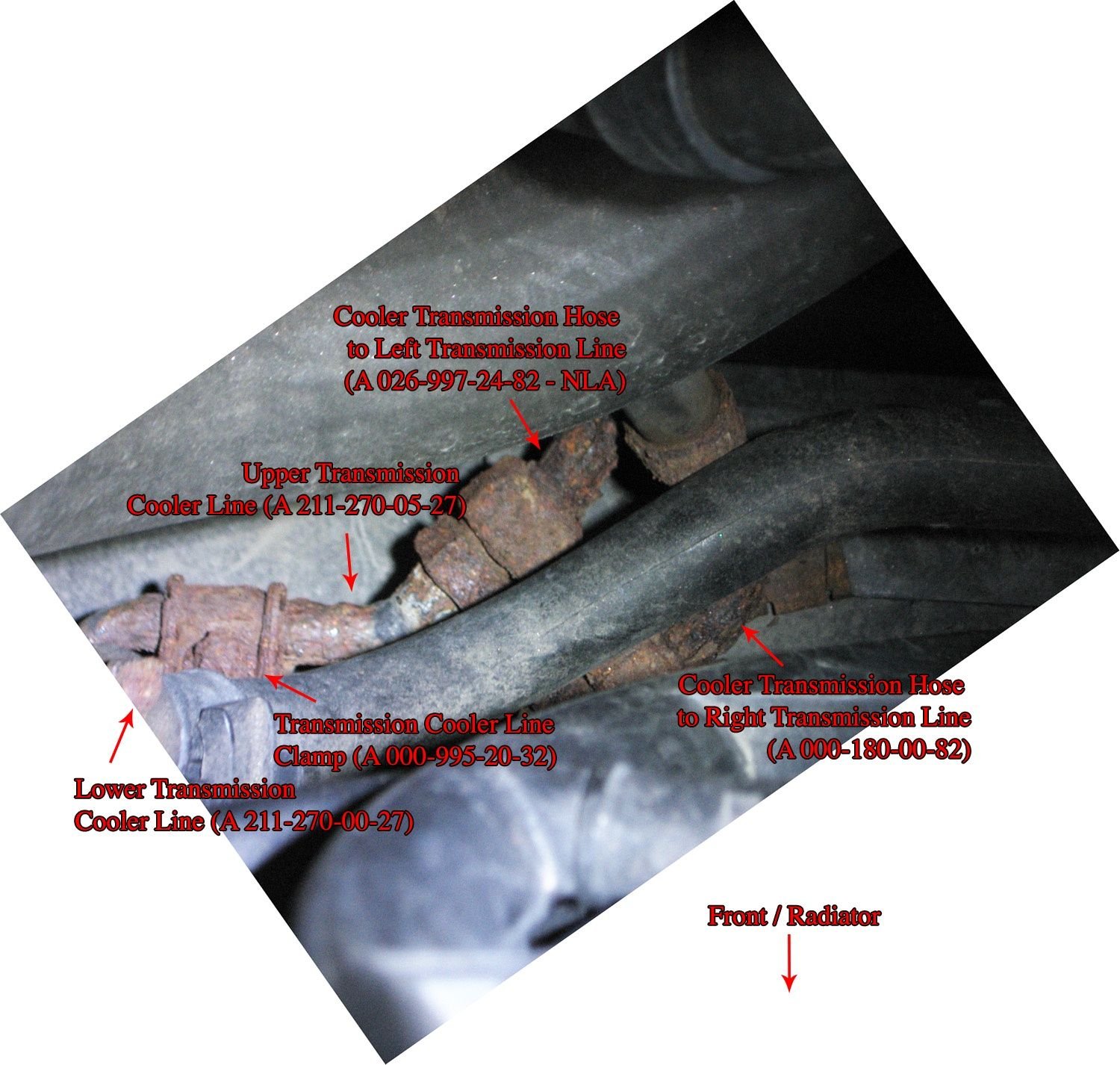

Which line goes to the left side of the transmission?
Originally Posted by Onyxthecat
UPDATE: The car is fixed. I decided to install the lines onto the radiator first and quadruple check everything was seated and clipped properly. Tugged on the lines a bit and they were solid. Reinstalled everything and topped off the fluids and the car runs perfectly. I was worried I had damaged the transmission after losing so much fluid but the shifting is right on and no check engine light or codes. The only thing is that the new upper line did not come with the small bracket and fastener to attach the lines together, I just used a stainless steel zip tie to keep them from moving around. I did try to remove the old bracket but it crumbled away lol.
Hello,
In this picture which line goes to the left of the transmission and which one goes to the right side of the transmission?
Old Sep 9, 2024 | 11:24 PM

Posting photos of the corroded transmission cooler lines and of the upper transmission cooler line fitting at the front of the radiator. I will have to replace the upper and lower transmission cooler lines and bracket, as well as the cooler hose extension sections connecting them to the left and right transmission lines (and the radiator...). The right transmission cooler hose extension appears to be available (Mercedes part#: A 000-180-00-82), but the left section piece is no longer available (Mercedes part#: A 026-997-24-82). I'm curious to know what others did in this situation. Was there a part for another chassis close enough in length/specs that it could be used? Or did you buy two of the right transmission cooler hose extension sections (i.e., A 000-180-00-82) and use the end connectors from one of them to fabricate properly-sized hose extension piece to the left transmission line
(or get a hydraulic line shop to do it...).
I spoke to an independent shop in the area that has been working on these cars for years, and the owner thinks they might have what I need/or could use in stock, so I sent him the information via e-mail. We'll see...
As for the radiator, the owner of the shop seemed to still have a preference for the Mahle Behr (even the current ones manufactured in India) over the Nissens radiators, but he said that the Nissens radiators weren't bad... Anyone have experience with these newer Mahle Behr radiators?
