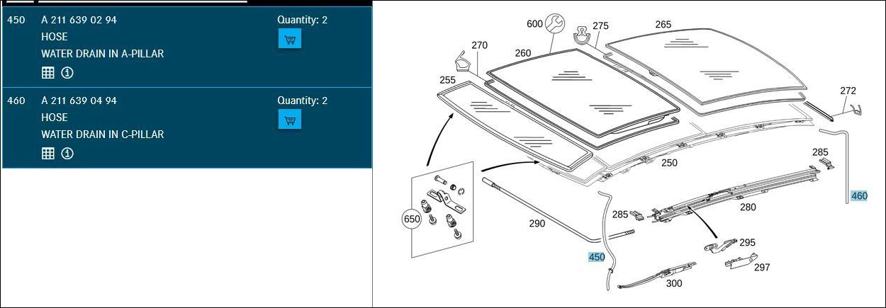

Should be 4 drains: 2 front @ a-pillars, 2 rear @ C-pillars. One common leak point is where drain connects to frame.

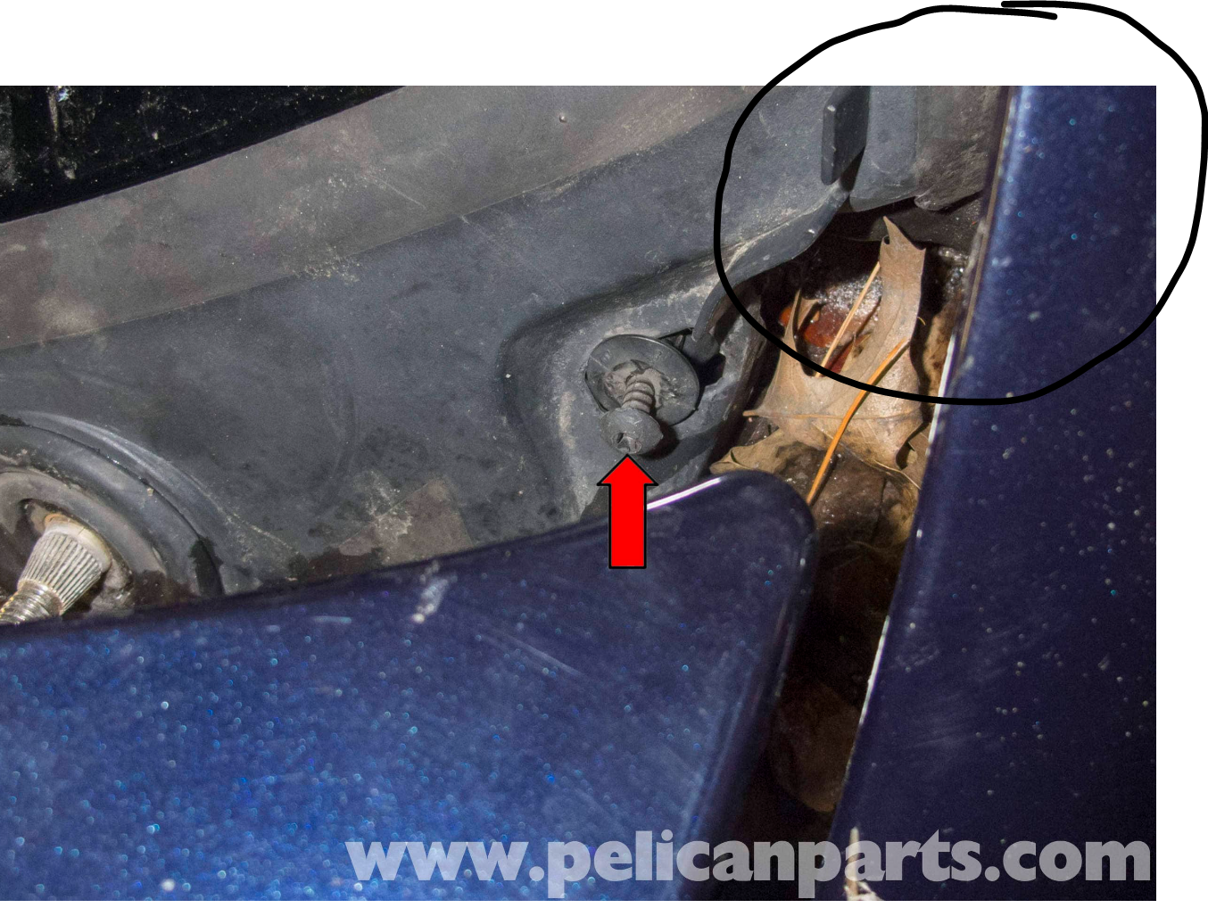

Have you also looked at the corner between the cowl + windshield pillar + drain hose?

Thanks for the diagram, much appreciated. I Loosened corner of the headliner and I could not find the drain hose.I Did not see any drips/dribbles/ moisture from the inside sun roof area. Any suggestions where to lo look next??

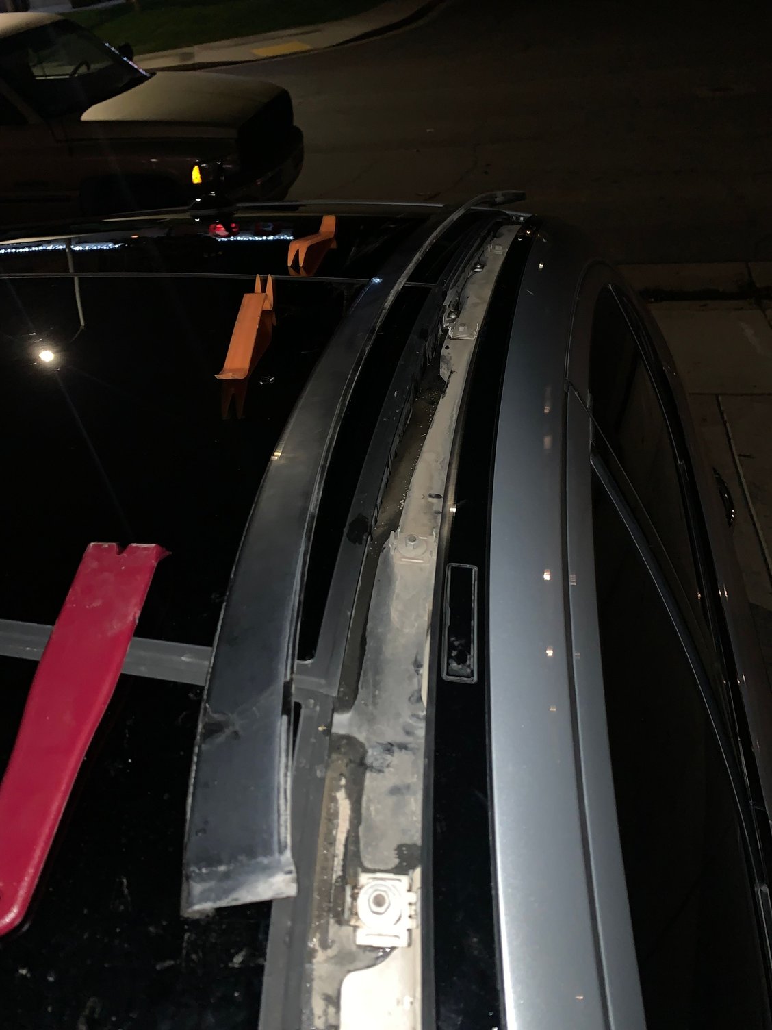

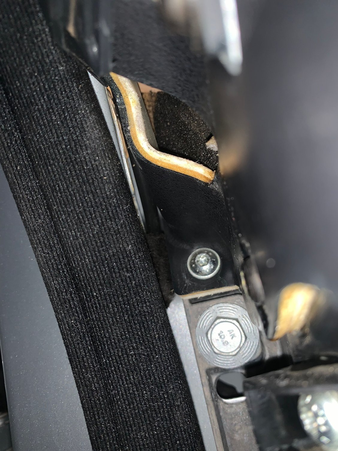

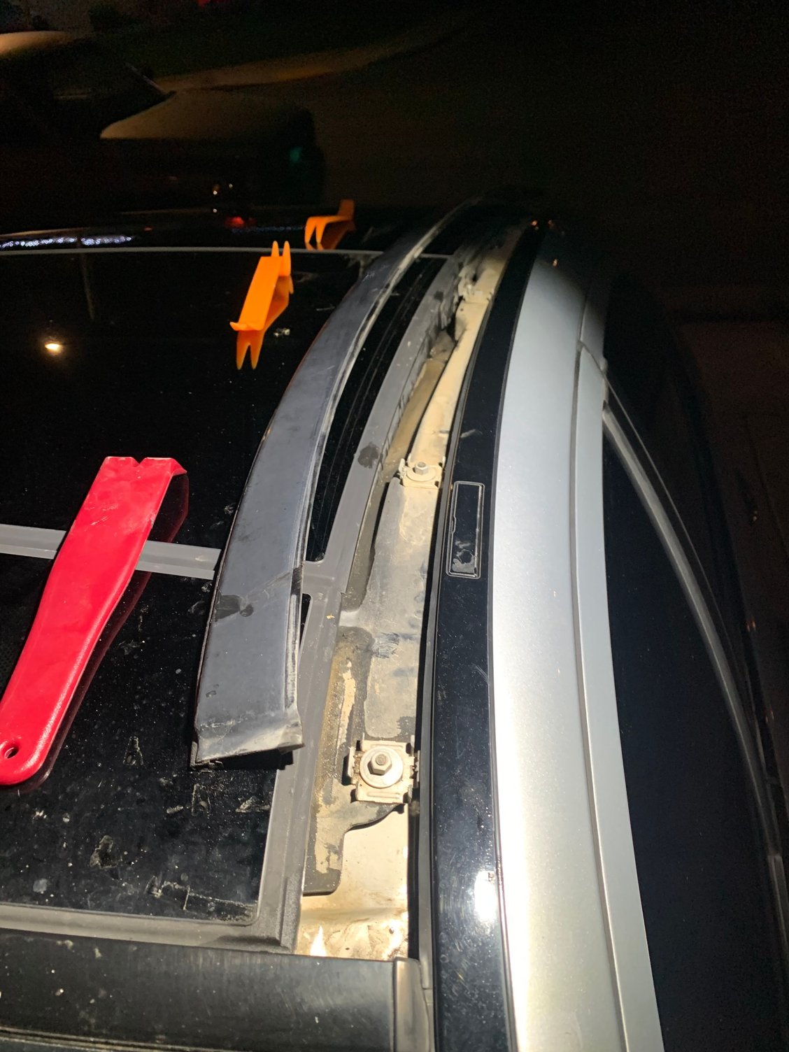

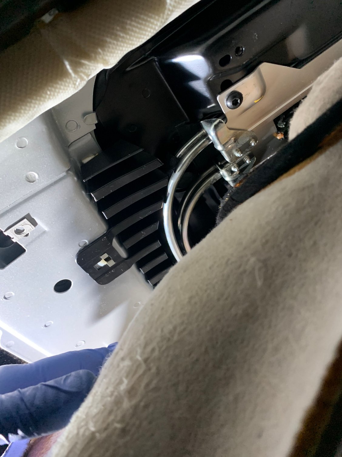

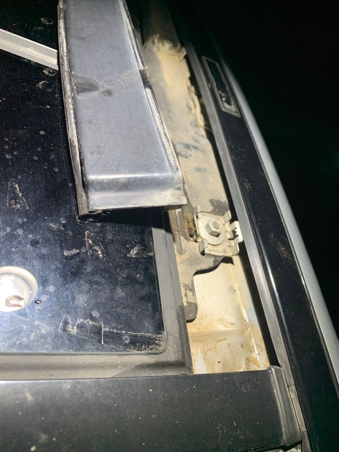

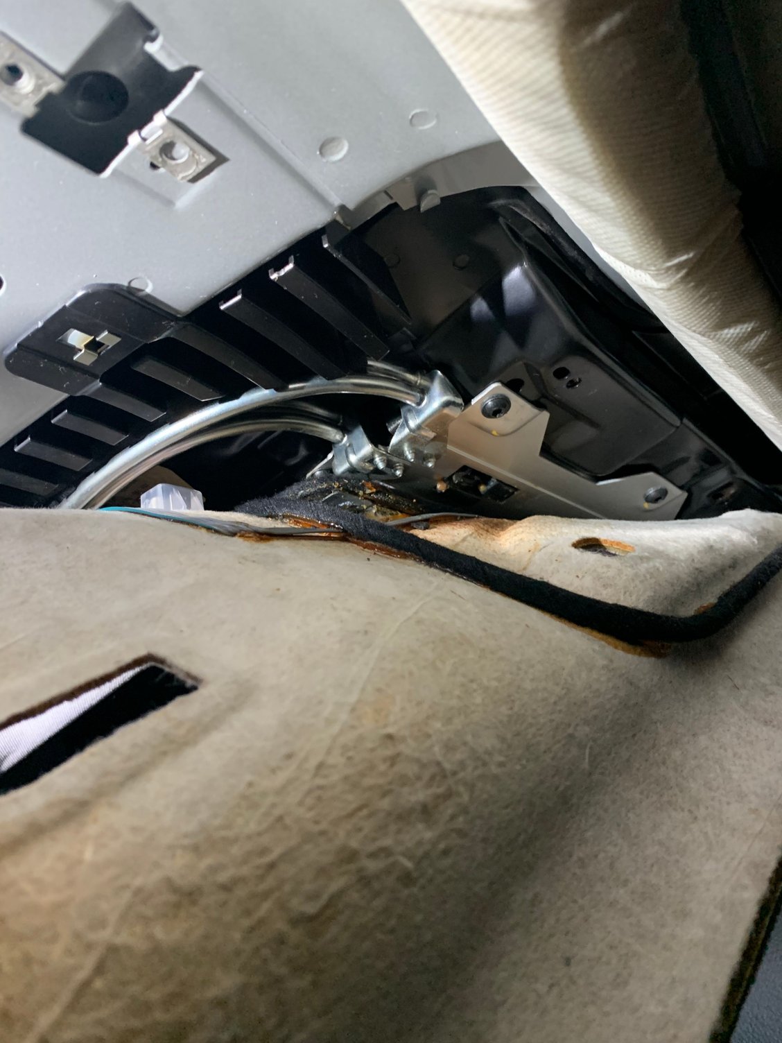

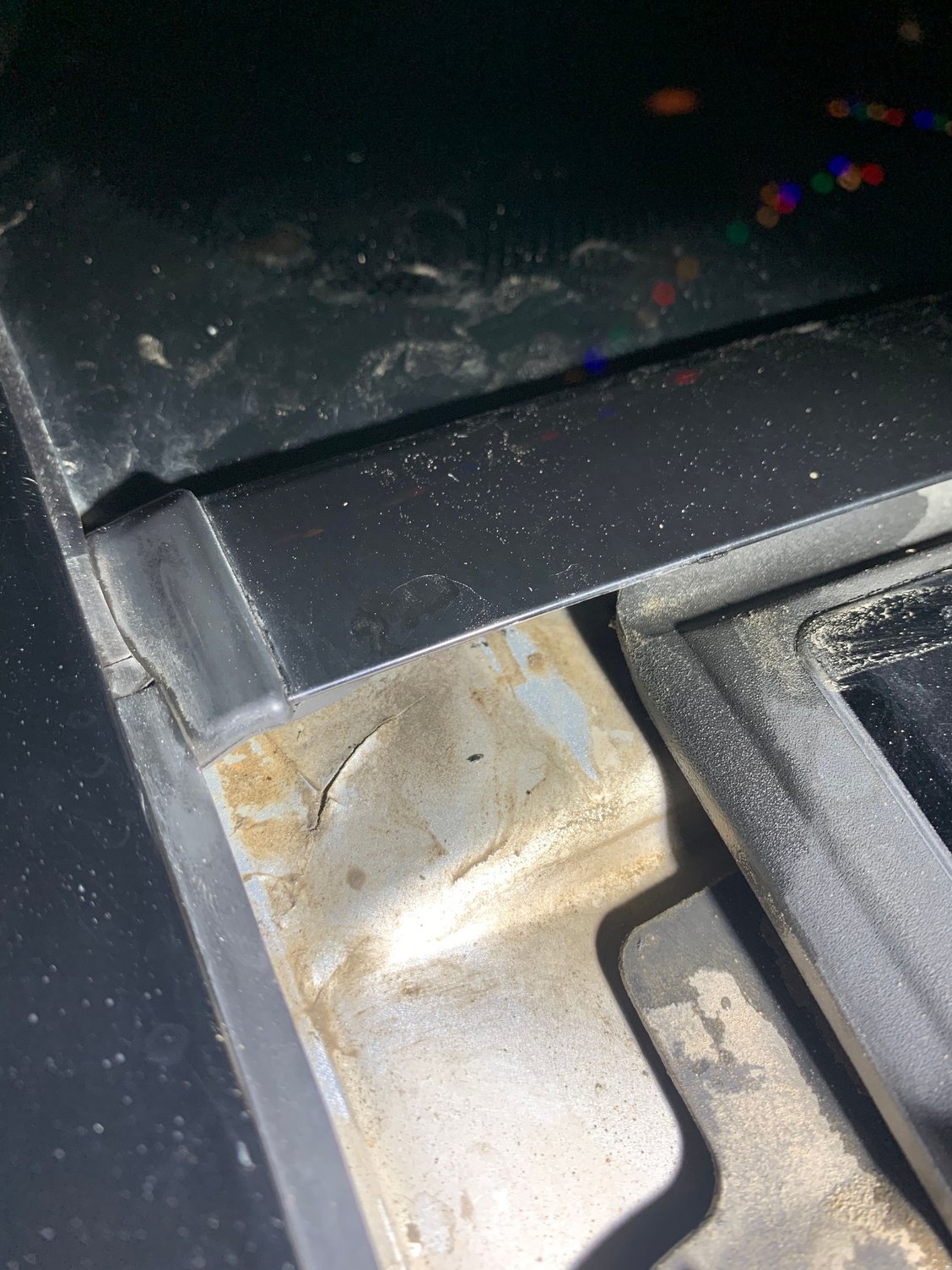

I removed the repellent did not find drain hose. But I believe I see a drain hose going down A pillar by the SAM module. I also see a potential crack in roof frame I will RTV. See pics attached. Thoughts?
on a good note I was successful in replacing the oil housing gasket and cooler leaking gaskets.
thanks
AG

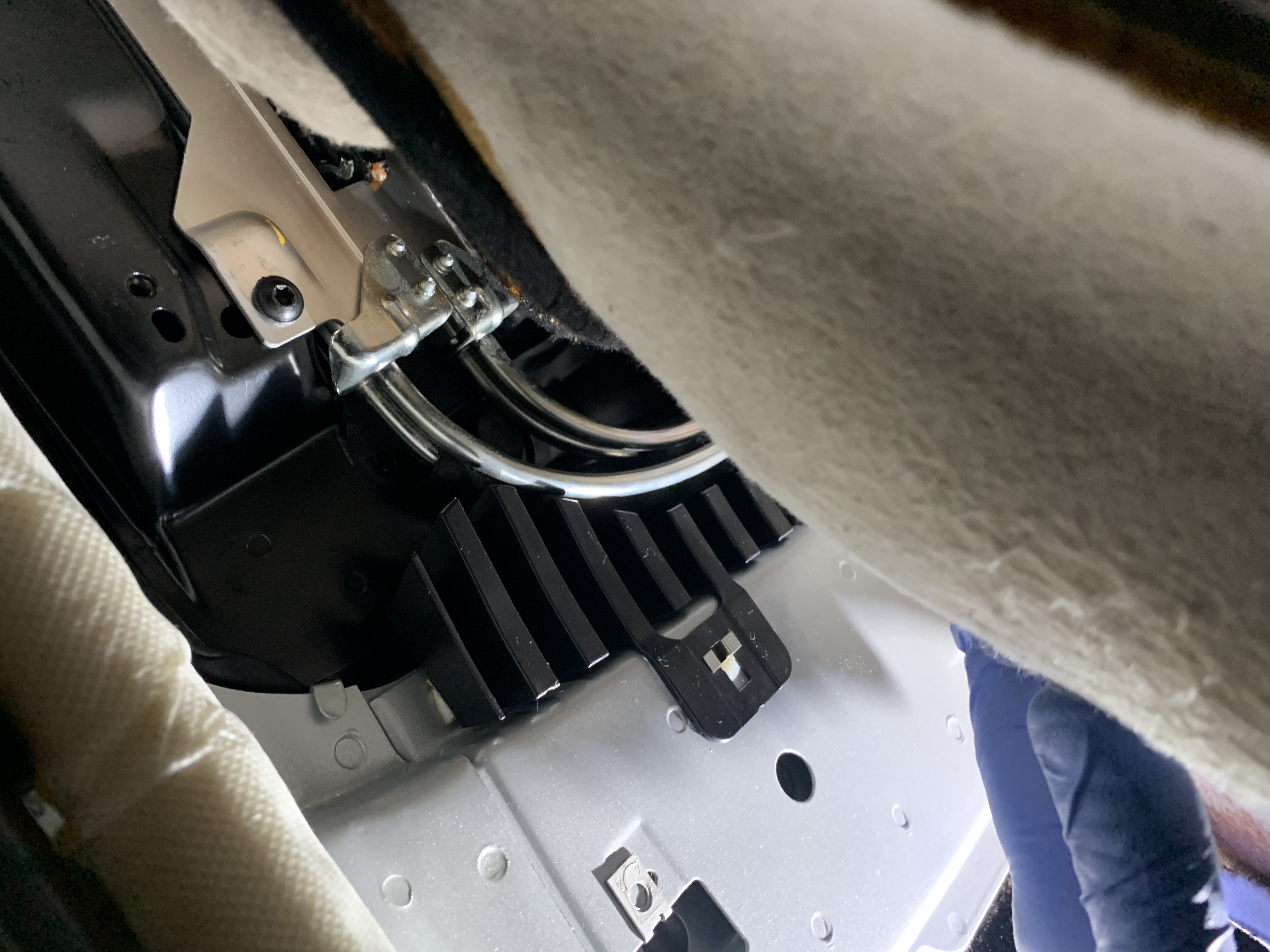

Old Dec 13, 2022 | 10:37 PM
Anthony6621's Avatar
Joined: May 2018
Posts: 11
2008 E350 AMG
Hos
Drain hose by SAM?
Old Dec 14, 2022 | 11:06 AM
konigstiger's Avatar
Posts: 15,901
Likes: 4,630
From: North Scottsdale, AZ
'71 Pinto
If, in fact, cowl, windshield, AC condensation line (located side of transmission), and inspection behind left foot well panel shows fine thought glass gasket might be culprit to circumvent dropping frame. Unfortunately, frame needs to be removed for proper inspection.
