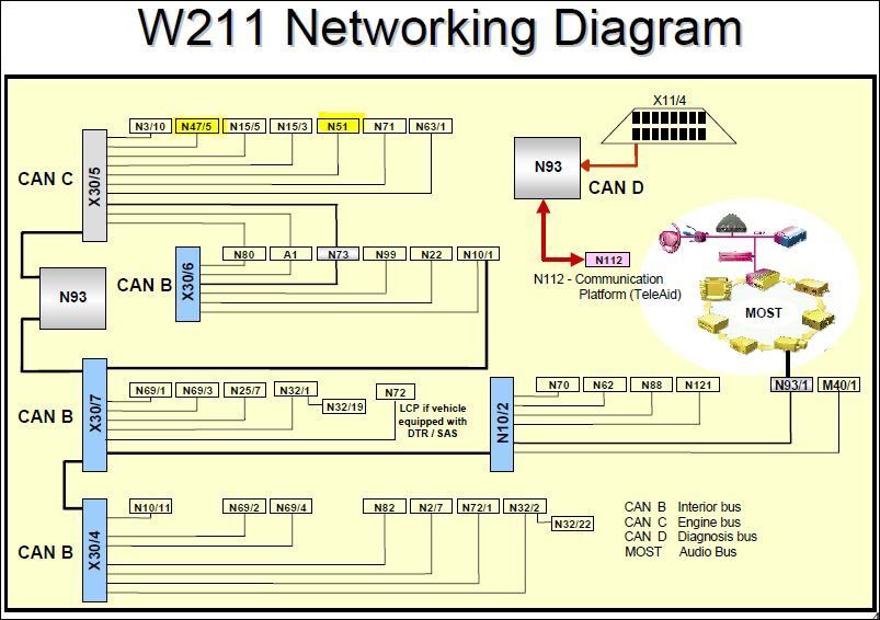

Clearly communication errors, i.e. CAN problem. Find the document attached for "pleasure reading"
Perhaps look at the CGW under the driver's side, and clean all contacts first. https://mbworld.org/forums/e-class-w...ml#post7488058
Layman explanation of the CAN bus in MB
