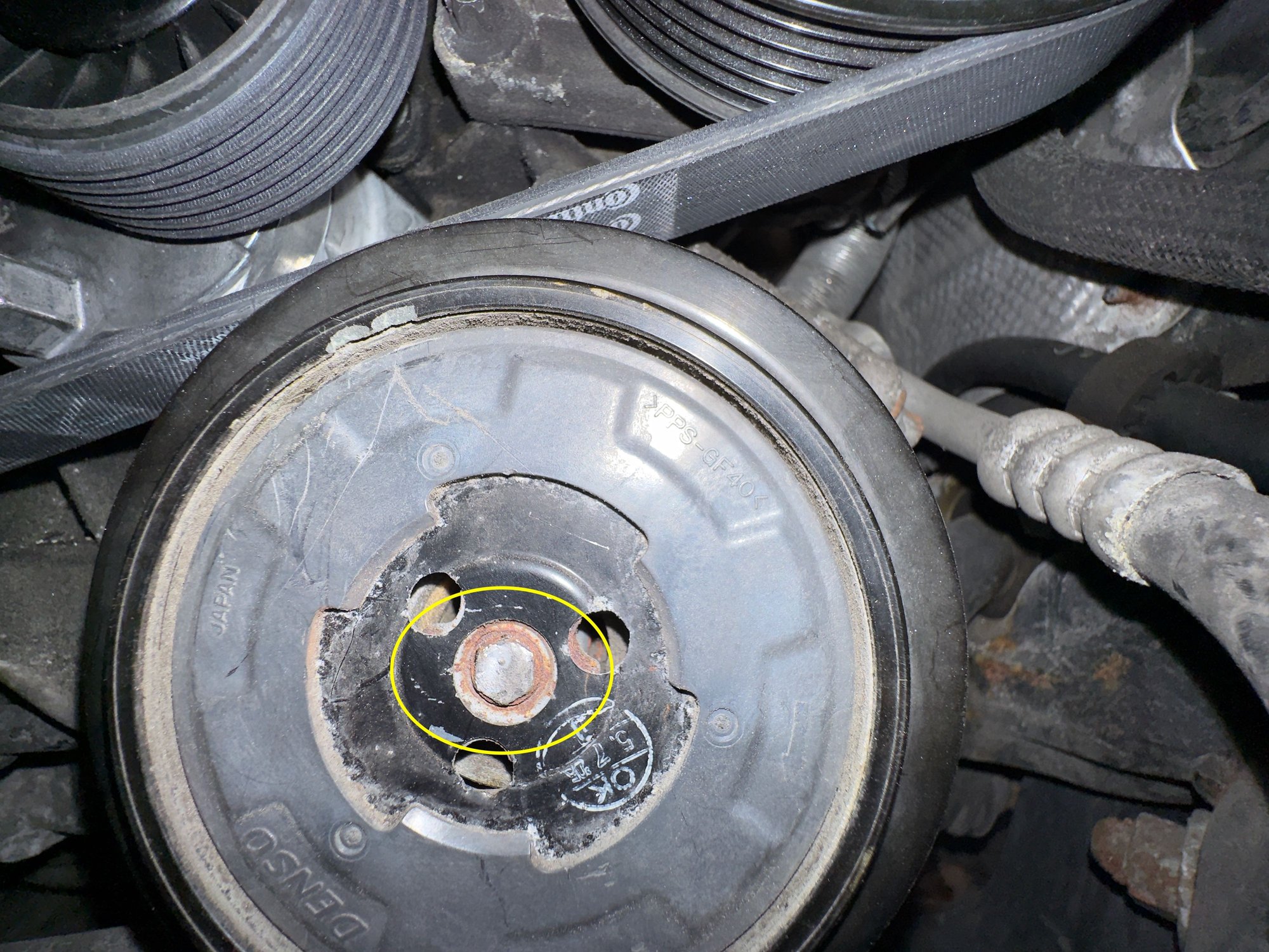

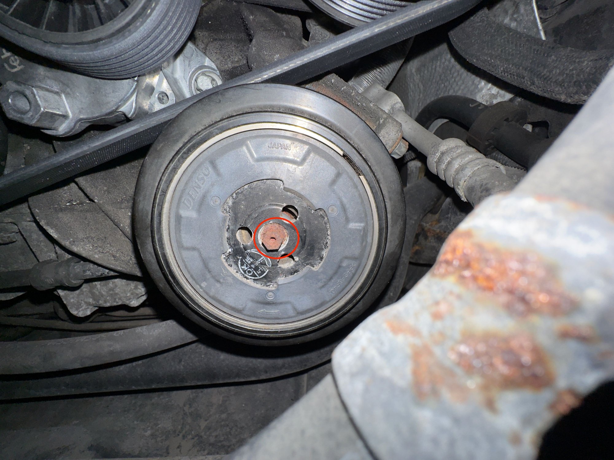

I just broke the head of the 7mm hex bolt. From a simple job, it just became a complicated job.
I circled in red the bolt I need to extract, and in yellow the broken bolt (rust all over). The dealer has no part number for it, and I will need a replacement. Do you have a picture of this bolt outside of the pully assembly?
Any ideas how I can extract the bolt to remove the bolt?

The 7mm bolt is only a counterhold and has a threaded part for the top cover

I can counter hold with a reversed drill and an extraction tool. My next issue is to find the special tool part number:W112 589 07 40 00
The tool is expensive and will take 3 to 4 weeks to arrive from Germany. I can't find a used tool on eBay or elsewhere. Any sugegstions about fabricating a homemade tool, or finding the tool online?

I used this tool, bought it on Aliexpress
