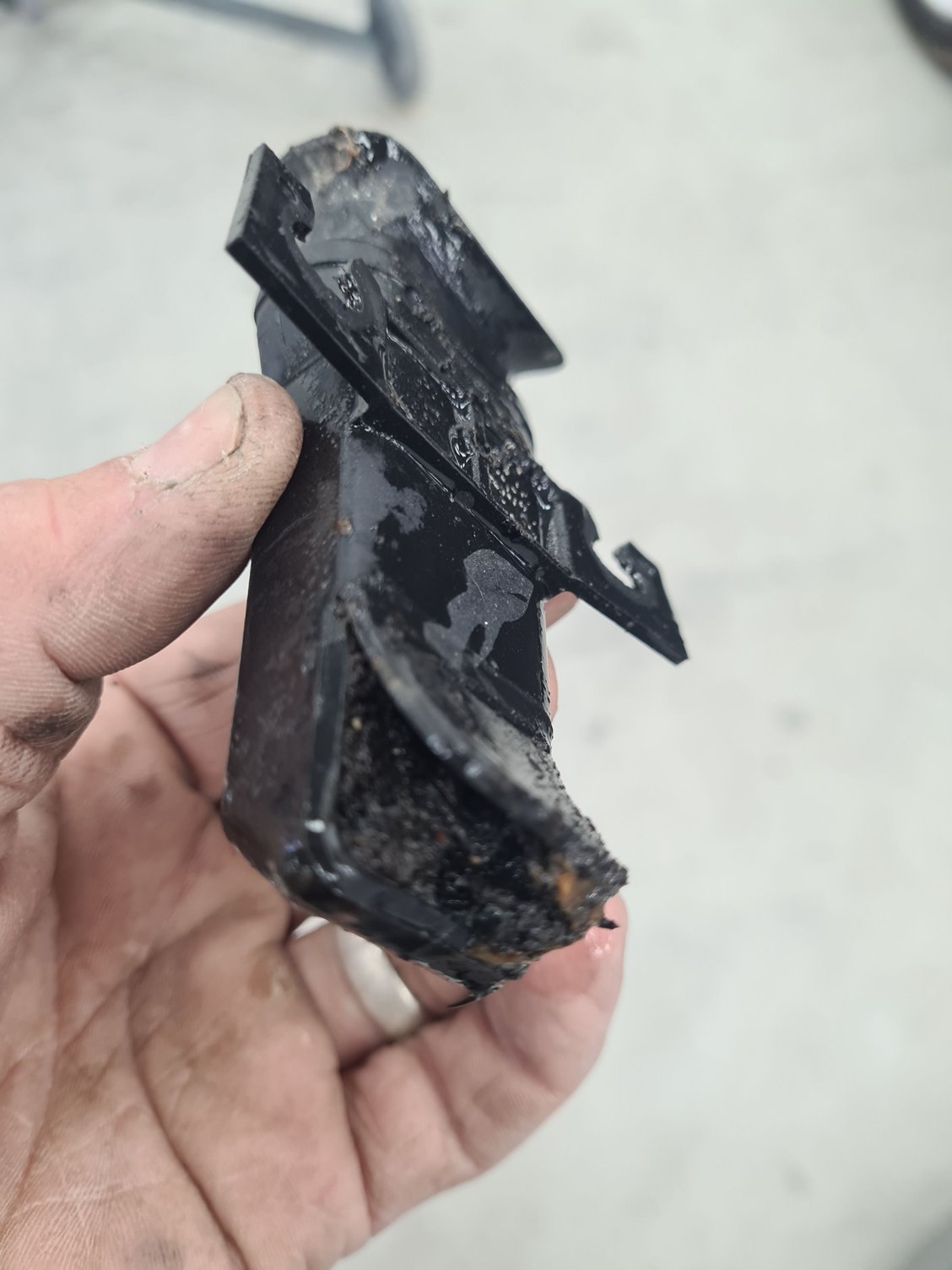

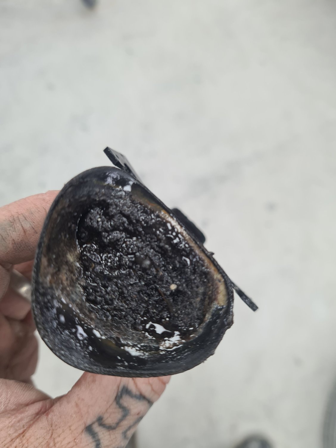

In this case, this drain was the problem, that one on the picture above.

Yes. If you take the right front wheel off, and half of the plastic cover. Its just sitting there easy to dismount with two 10mm. In my case its hard plastic, not the rubber thingies that closes easily.
Fixed my problem.
