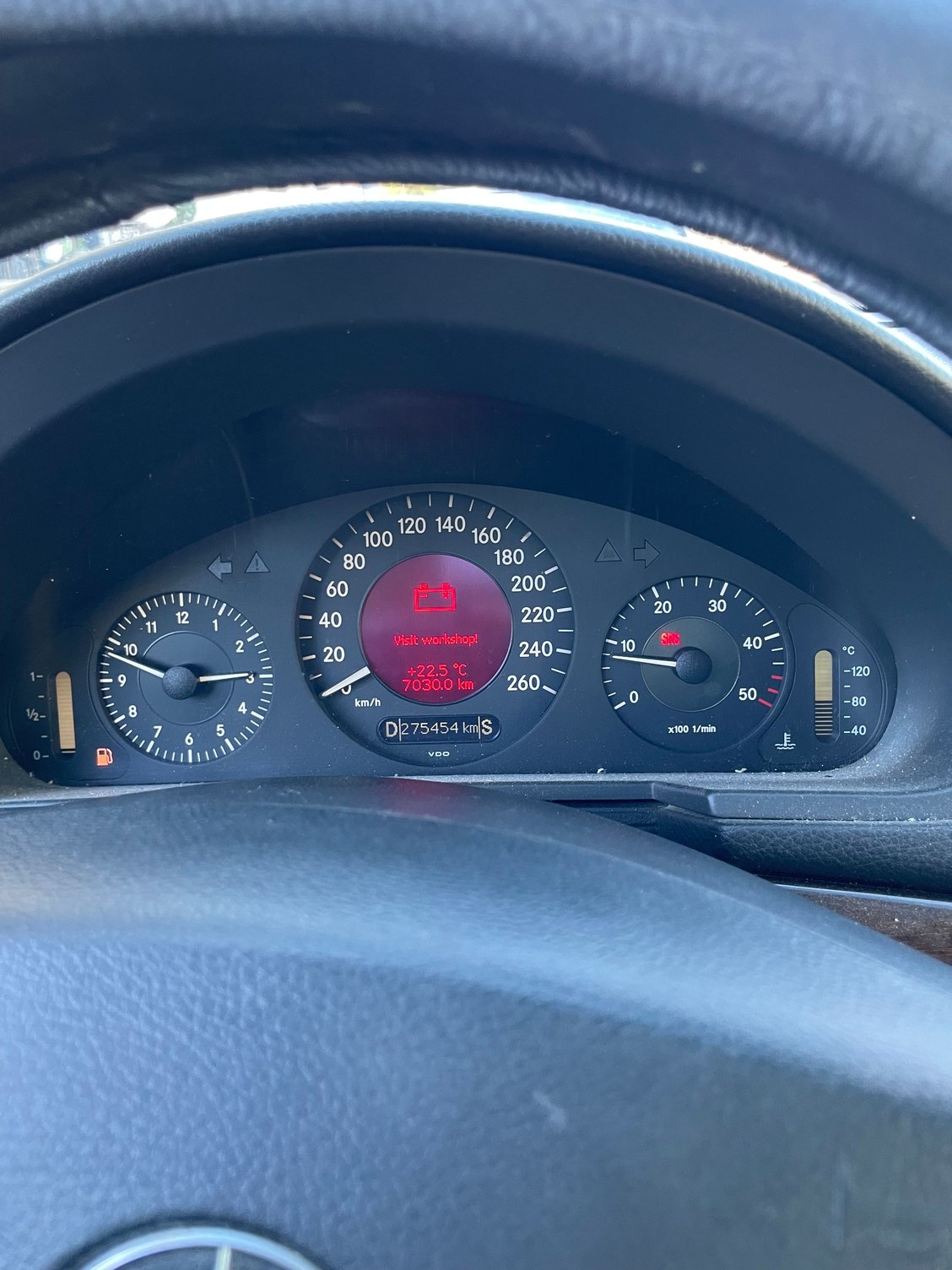

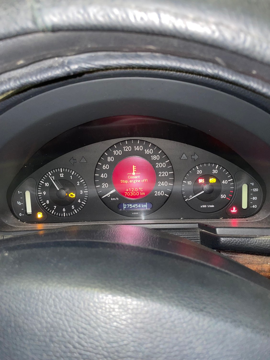

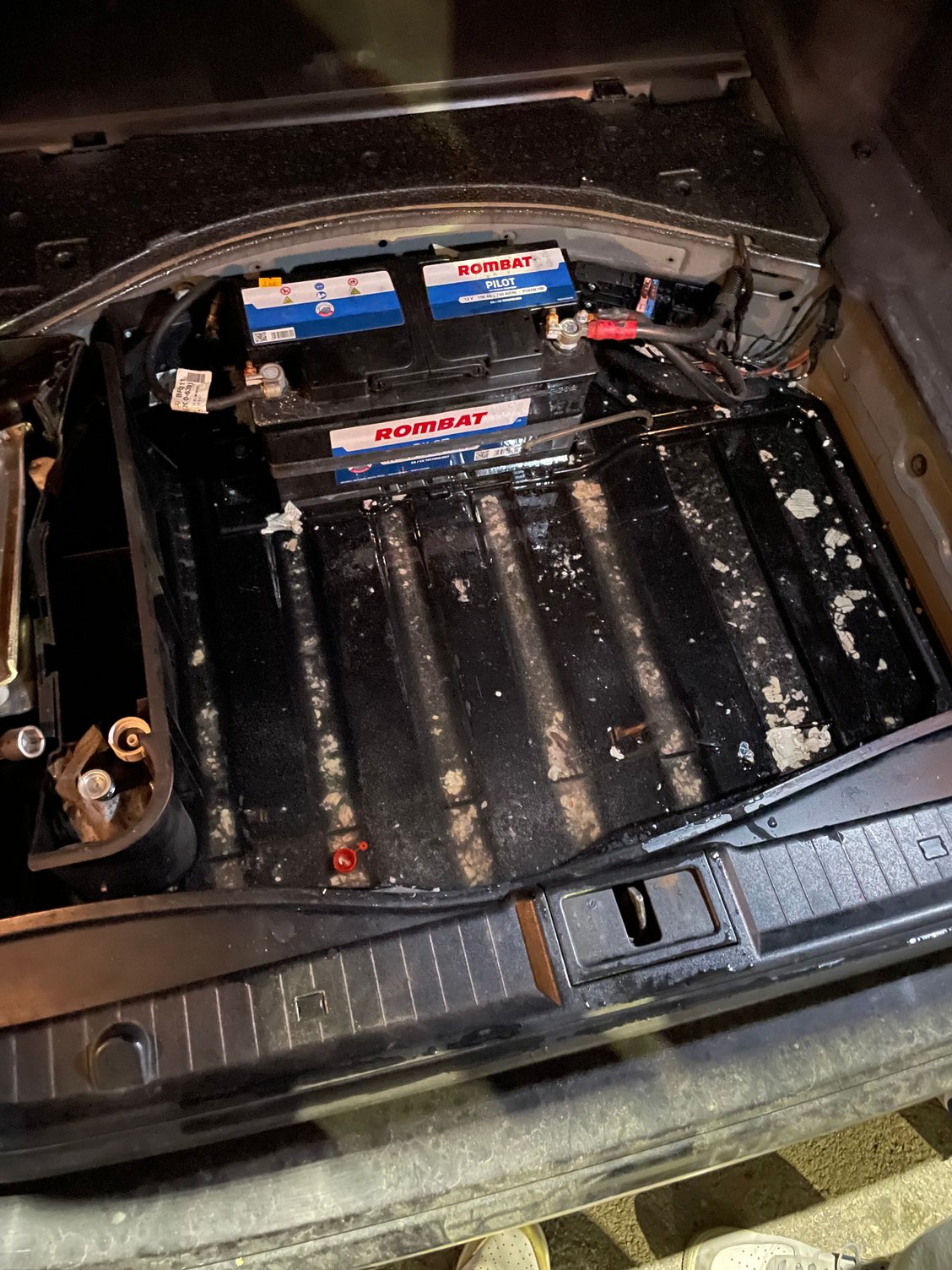

Hello. This happened on my 2002 W211, then the fin engaged and the odometer stopped working. When I opened the accumulator there was water. Does anyone have any experience with this.
