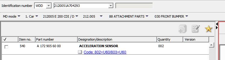

Acceleration sensor bolted inside front bumper (see b151/1 & b151/3), may need to remove bumper. Should be part # 1729056000 (803 = 2013) – VIN will confirm.

Does the part you mentioned fit my car? VIN: WDD2120051A704293
Reply 0
Dec 18, 2016 | 03:19 PM
Yes, see attachment.

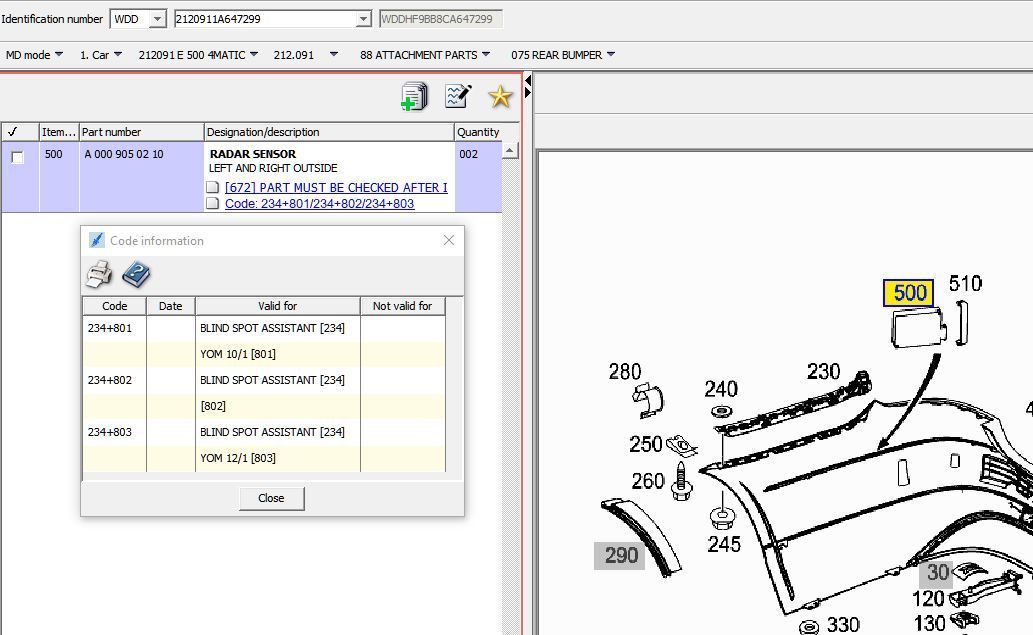

Feb 8, 2018 | 04:36 PM
Blind spot assist sensors are located inside rear bumper, both sides.

Feb 8, 2018 | 07:02 PM
Quote: Blind spot assist sensors are located inside rear bumper, both sides.
https://mbworld.org/forums/e-class-w...de-bumper.html
I see , Now i can trace it and fix it myself. i am assuming this system would require to be reset after installing new sensors.would a normal diagnosis computer do the job or it would requires some specific one.
and Do ClS550 , S550 have same airbag and blind spot sensor.I am thinking to buy them from part out cars.

Feb 23, 2018 | 02:04 PM
See attachment.
