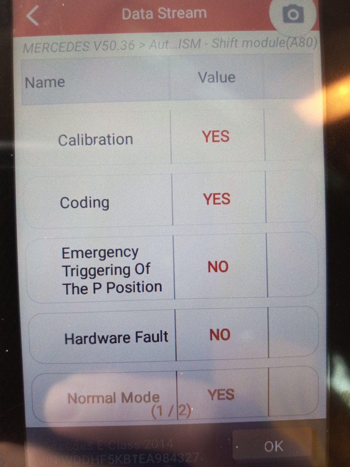

I cannot find the PRND Status on my data stream, but I will go through everything again and double check. However, when the car is running the battery voltage for the MAIN Battery is around 14.8v and the AUX is around 12.8v.
Old Apr 21, 2025 | 02:11 PM
bobb00's Avatar
Joined: Feb 2025
Posts: 32
Old Apr 21, 2025 | 02:12 PM
bobb00's Avatar
Joined: Feb 2025
Posts: 32
That is everything on my data stream for ISM
Great!
It looks like your AUX is not powered.
that's what keeps your ISM in limp-mode.
check the AUX nearby charge fuse: red 7.5A.
report your progress towards free repair!

Here is my data stream from the ISM.
You can compare yours to mine, and realize the PERMANENT LIMP mode setting is different.
Can you please enter into the TCM module, and check the Driver Authorization entries?
On the AUX battery being at 12.8V, I am only certain mine will go to 14.7/8V for a few seconds after starting up, and winds back to 12.8V. I still have my LIN connected, @CaliBenzDriver that could be the difference. The "smart algo" may switch to 12.8V once the AUX passes the check.
Please check Fuse 88 (15A) in the RearSAM, and Fuse 16 (5A) in the FrontSAM
