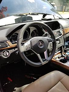

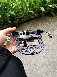

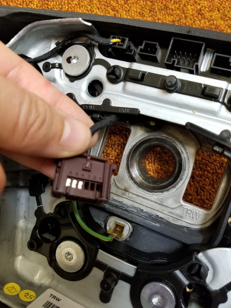

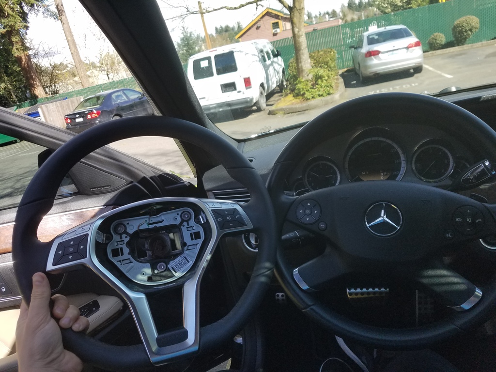

So I just replaced my steering wheel and it was an easy job but my controlls not working.. Horn not working.. Paddle shifter not working... Everything was plug and play but I asked a tech of mine and he said the 3 pins need to be changed??? The airbag pins I don't think matter at this situation.. The pins are on 4,5,6 and 1,2,3 empty
Can anyone chime in??
My car is a 2012 e350 bluetec
--just replaced my steering wheel and controller not working-- help-20170414_144625_zpsq5abpafi.jpg

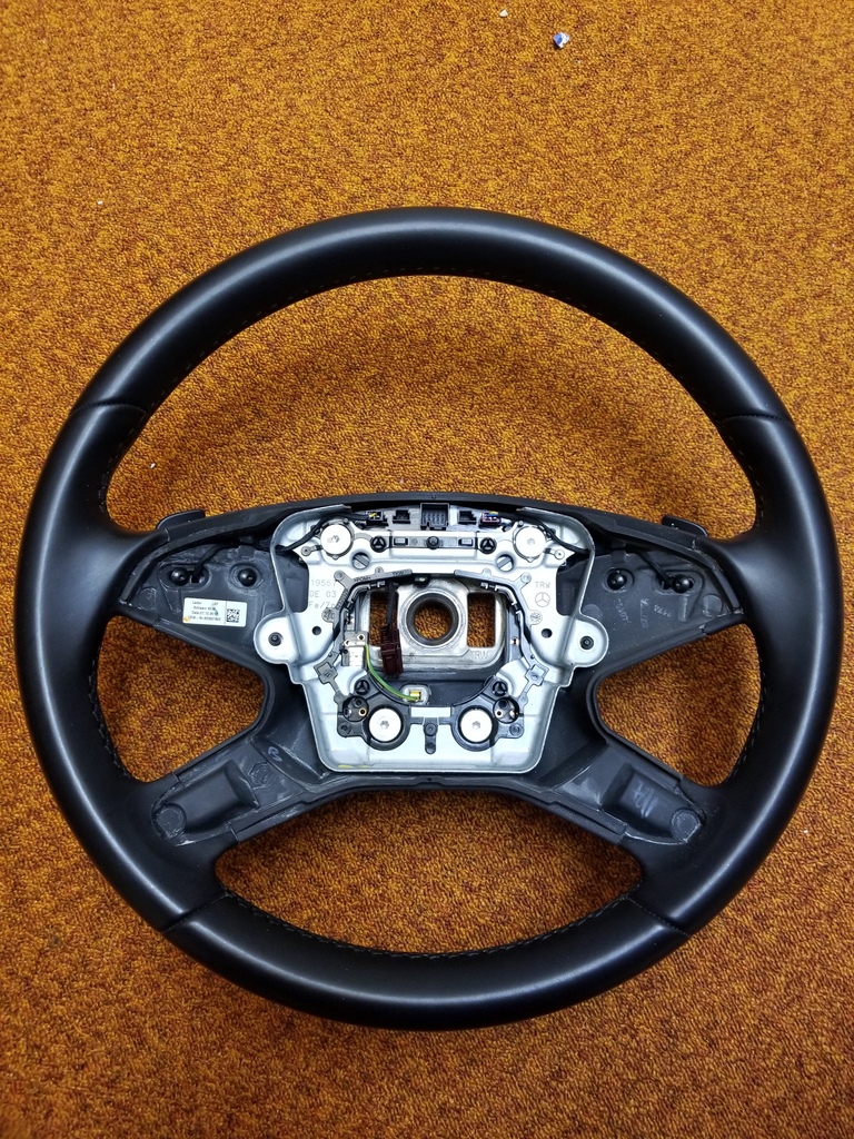

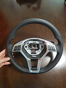

Here is my old steering wheel so I don't think I could interchange anything out of it due to different shape.
--just replaced my steering wheel and controller not working-- help-20170507_002426_zpsazqy5da5.jpg
--just replaced my steering wheel and controller not working-- help-20170507_002441_zpsc47zeosv.jpg

According to that thread, you need to swap the controller boards where all the wires lead to. Hopefully it is of the same dimensions.

Yah the boards are square on the new one and round on the old one not sure how that's going to work

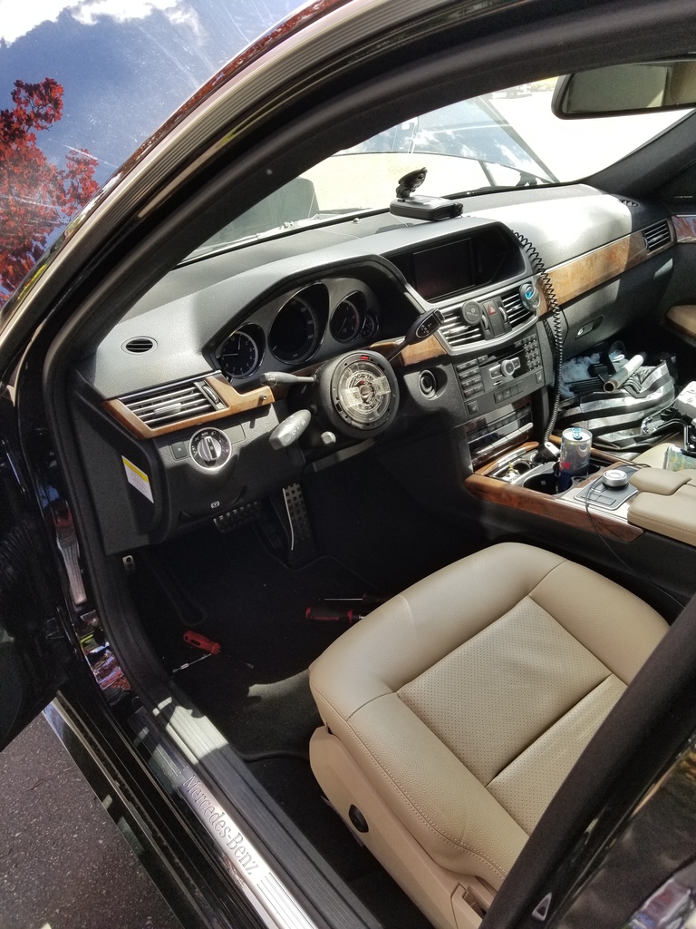

i replaced this from a different E class w212 and that didnt seem to do anything at all.. Would maybe fuses be bad or something

Alright I friken did it. It was in my hands the whole time lol My own pcb board which I pulled apart and it was a friken direct swap even thought the contact plate was different... Boom I took the pcb out of my old wheel and slipped it in the new steering wheel pcb spot and walaaa. Everything works like a charm.
