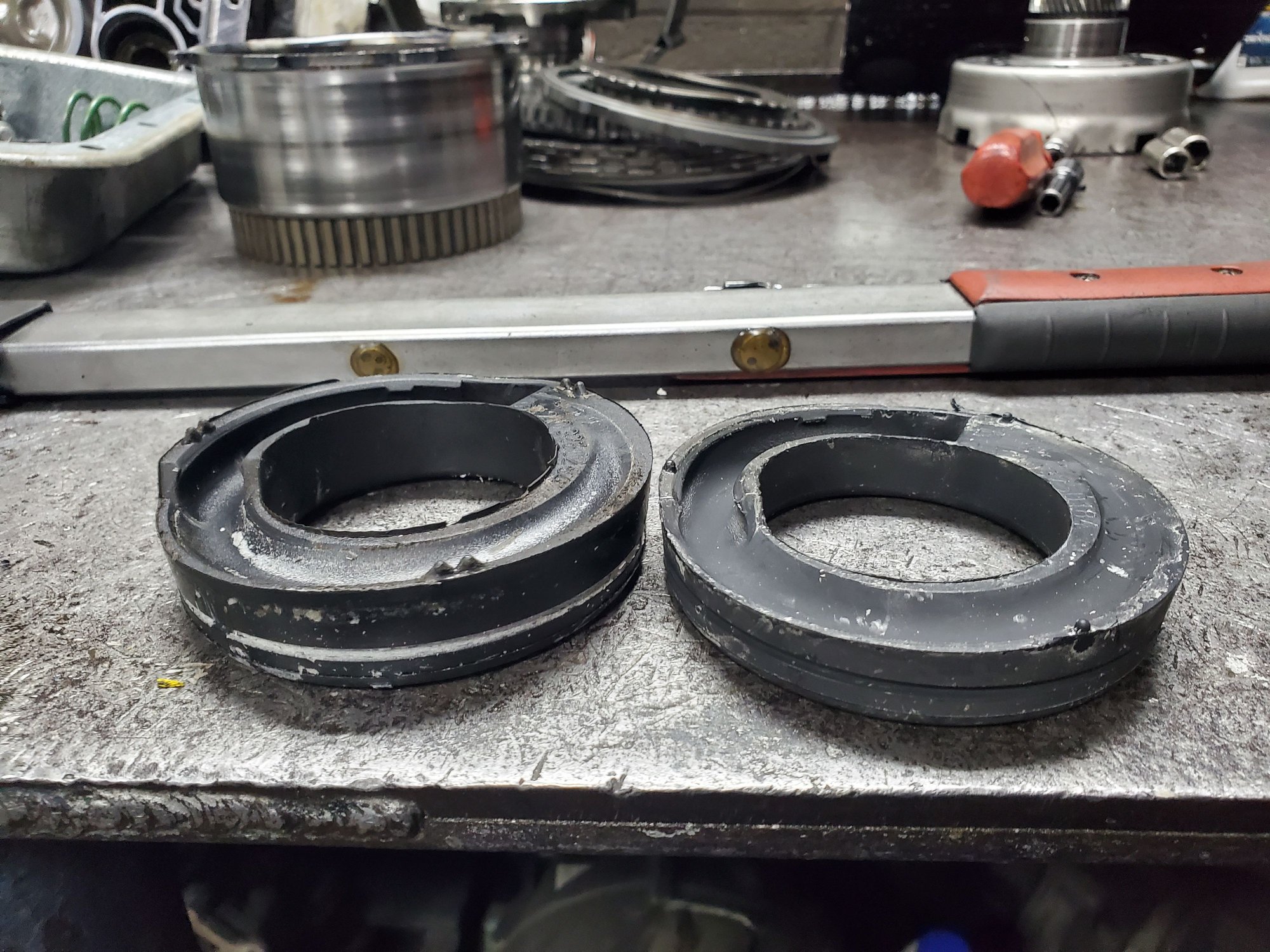

Here is a picture of 210-325-01-84 (5mm). It is identified by the 1 nub on the edge of the inside lip.
1 nub = 5mm
2 nubs = 9mm
3 nubs = 13mm
4 nubs = 17mm

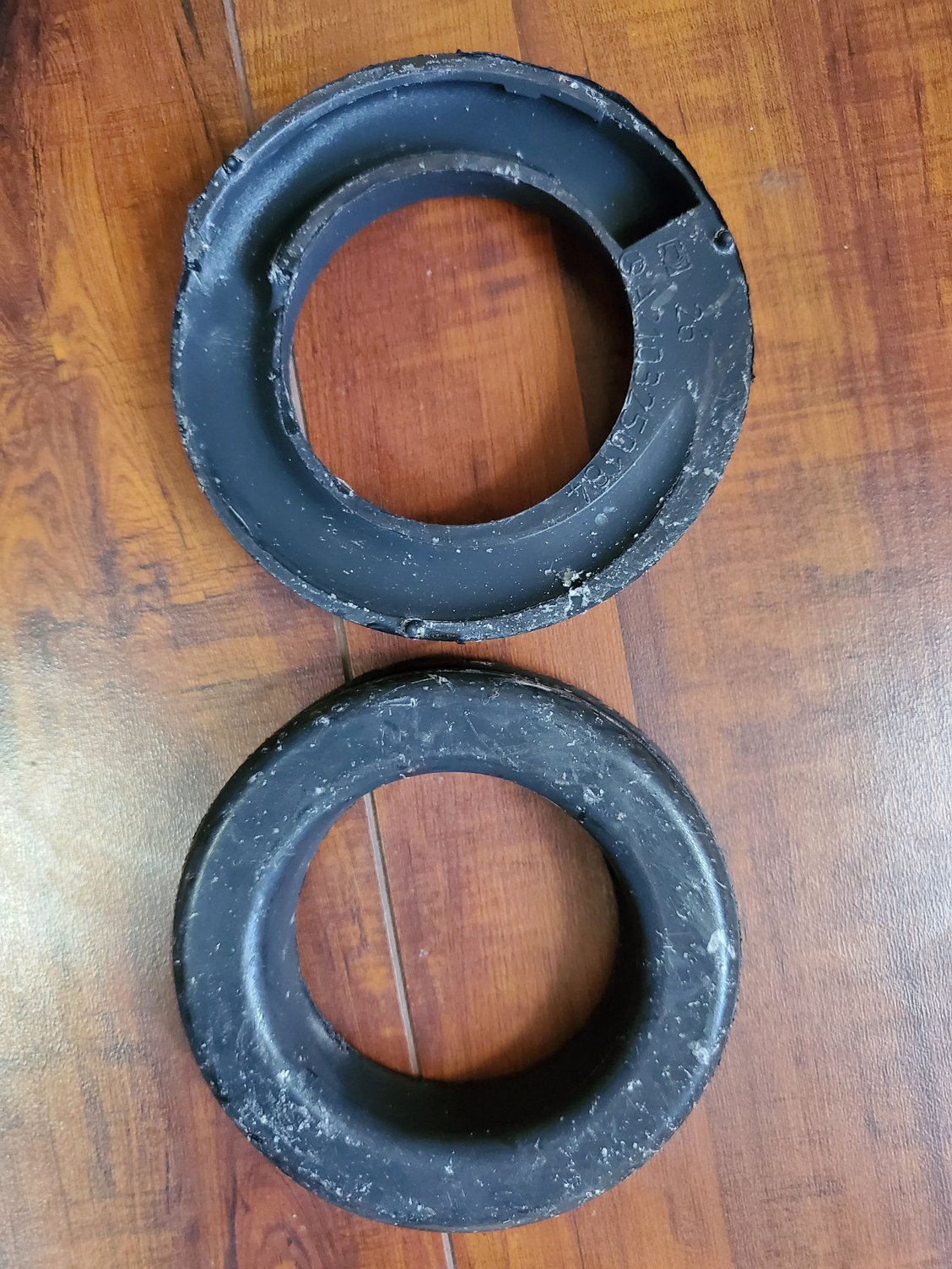

My 2016 came equipped with the 210-325-02-84 (9mm) pads. Here's a pic for comparison (note the 1 nub vs 2 nubs on the pad lips)
A little piece of advice - if you're going to change the spring pads, do yourself a favor and also buy part #A 212 326 03 77 (# 100 on the diagram "springs4" in post #4 above). It's a royal bear to get the rubber pad out of there. You'll need 2 of them.
