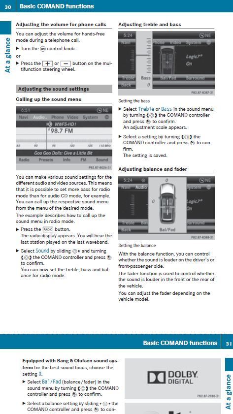

Not uncommon for speaker to go bad. Search “speaker” in this forum. Use balance function to identify bad speaker.

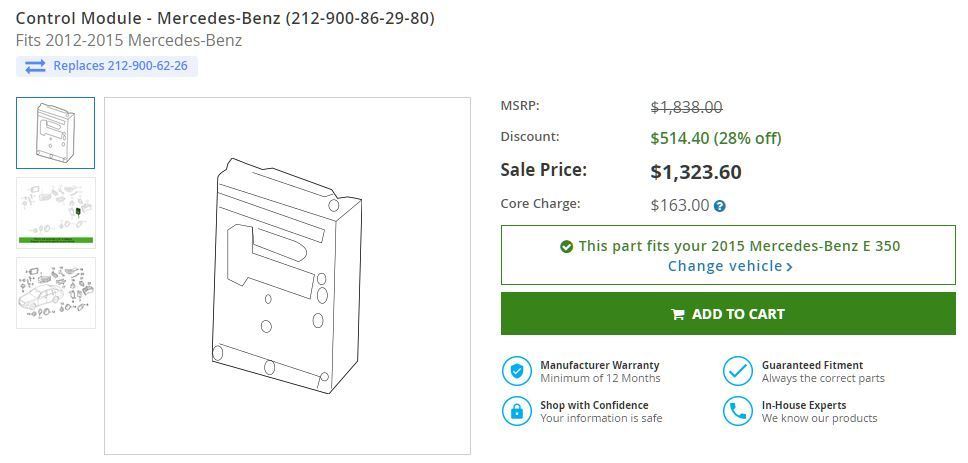

Old Oct 26, 2021 | 03:02 PM
lakepop's Avatar
Joined: Mar 2013
Posts: 85
Likes: 15
From: North Carolina
2011 E350, 2015 E350 Sport
Thanks again.......I was looking for part # 212 900 86 29

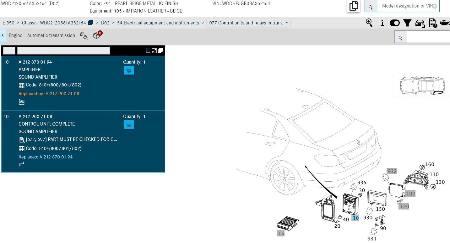

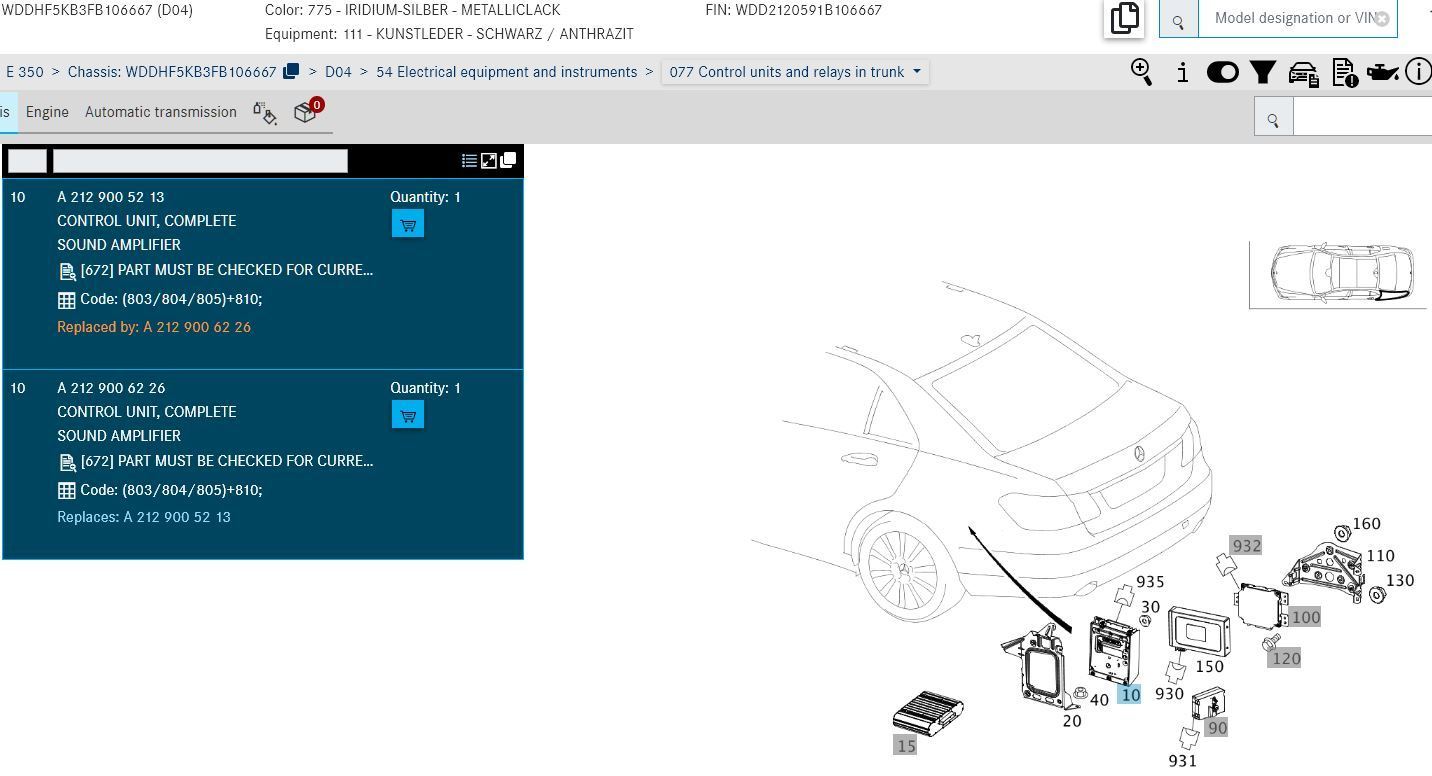

Old Oct 27, 2021 | 11:27 AM
konigstiger's Avatar
Posts: 15,901
Likes: 4,630
From: North Scottsdale, AZ
'71 Pinto
I was searching 2011 in error: https://mbworld.org/forums/e-class-w...ml#post7415144 - 2015 current part # 212900862980 (80 = re-manufactured):
