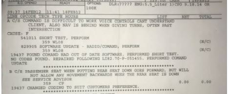

In times prior 2011 MB sold a "box" that connected to the car and BT audio worked thru this "box". I don't think this box is available anymore but I think there are other "boxes" on the market that you might want to consider instead of software update, but software update does something else too than just enables BT audio. I had this update done first for my 2011 E350 and then for my current 2010 E550.
Together with enabling the BT audio the update improves the BASS outout a lot. Makes a huge improvement and just for this reason the update would be very good to have.
It also improves the navigation for searching stopover while driving.
I have no idea how much the update would cost as mine was done under warranty for both cars but I would not think it is too much north of $200.
I have attached two pictures. The first one shows what was done the first time to make the BT audio to work. This was fine for the BT audio but it caused an issue where the radio and all alarm sounds went mute randomly. No sound at all and it took months before I got this fixed because of the random nature of the problem the dealer was not able to reproduce it but finally I was able to get the car to a MB dealer service in another town to show when it was mute. The fix was finally done at my local dealer (Pic 2) and the fix was they had to revert the SDAR software back one revision. Since then no problems at all and BT has worked with many different phone makes and models for phone calls and streaming.
In the first picture you can also see the fix for the passenger seat. Both my cars had the problem that when I folded the rear seat backs down the front seats move forward but I was not able to move the passenger seat back again to sit on it. The driver seat you could but passenger seat was practically useless as it went forward and up in an angle position you could not sit on it. The fix is coding change to match the driver seat function. This problem you naturally can have only if your car is equipped with folding rear seat.
